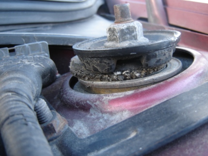

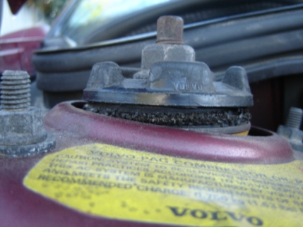

It needs a timing belt STAT! Has done slightly over 70k miles since last done. She creaks and clunks and groans like mad on any bump in the road. I plan to do the spring seats, rear upper shock mounts and the upper torque rod bushings (both ends) and maybe the lower transmission torque mount too. I'll jack the car up later today when the temp gets above freezing and have a close look. Have a look at the terrible bodge repair on the spring seats, yes, those are cut down bits of tyre tread stuffed in there, and the washer on the right side is upside down!

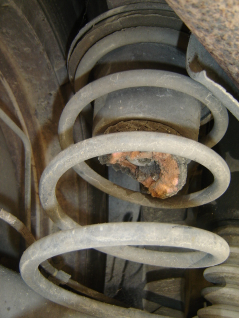

The rear suspension has me baffled. Do I have Nivomat or something? The shocks look weird and the springs look a bit puny. I measured the coil wire diameter and the wagon is 11mm and my sedan is 13mm, much beefier looking.
Maybe someone can positively identify it? Oh, and since I got it home, the right rear shock has blown itself and is leaking copiously. bump stops are also broken/missing.

It looks like my rears ARE Nivomats so I am going to convert to regular springs and shocks. Is this as easy as it sounds??
From the pictures I would agree that those are indeed Nivomats. A spring change is definitely necessary if you change to standard shocks. It really isn't that big of a deal to change out the springs and that is a dandy time to replace the buggered bump stops. Normally the bump stops fall out and rattle around inside of the springs and drive you nuts.
For springs I would consult IPD, they can be a tad pricey but they know their stuff with Volvo springs and they can recommend the proper set to match your shocks. You will also need to change your upper shock mounts as they are different between the standard shocks and the Nivomats.
As far as shocks go I would avoid Monroe and KYB if you want to have any semblance of handling. OEM Sachs/Boge shocks and struts aren't bad at all and I have been happy with the Bilstein Touring Class setup.
