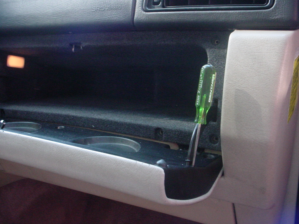

The lower dash panel needs to come off which will reveal the torx screws that hold the hinges. Before you go that far release the arms on the door which is done with a small screwdriver or even a nail.
There is a small hole next to the arm where you need to insert "something" to release the arm.
After the door is off and you remove the screws that hold the glove box in place you will need to fight with the glove box itself a bit to get it to clear the latch hoop. That is a minimal fight as things go.
