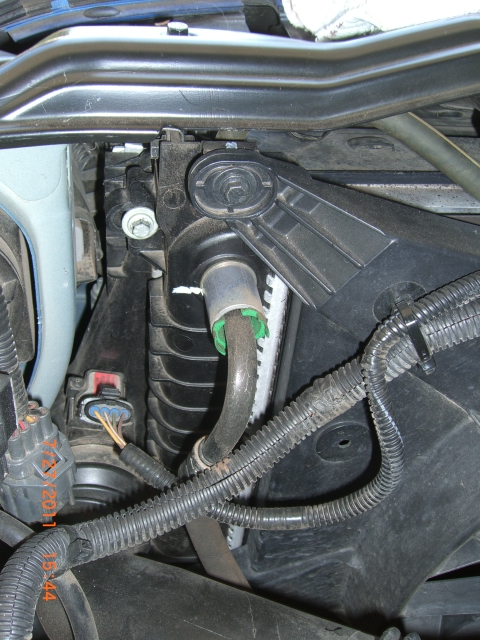

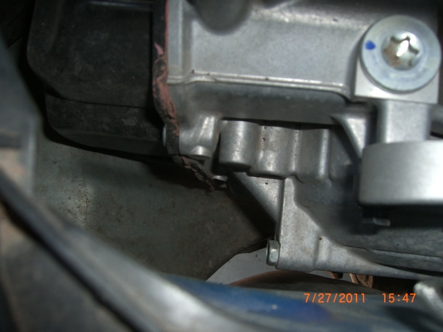

I received a case of 12 qts of Mobil1 3309 today (didn't expect it so soon) just as I completed the drain/flush and refill of my cooling system. So...what the heck. Pulled the air filter and box and low and behold....can't find a fill port. Crawled underneath and saw what looks to be a drain port in the center of the transmission (keep in mind this is a TF-80SC trans...no dipstick and no conventional anything for us Volvo freaks)
It does have a hose into the top of the radiator which either enters or exits the TC cooler. I can always do the drain (2qts/per) and fill...but where to fill? Through the cooler hose? Could use some help here.
Couple of pics included.
- Is this drain port?
- DRAIN...JPG (212.07 KiB) Viewed 5685 times
- Top cooler hose
- CIMG1363.JPG (333.71 KiB) Viewed 5685 times
