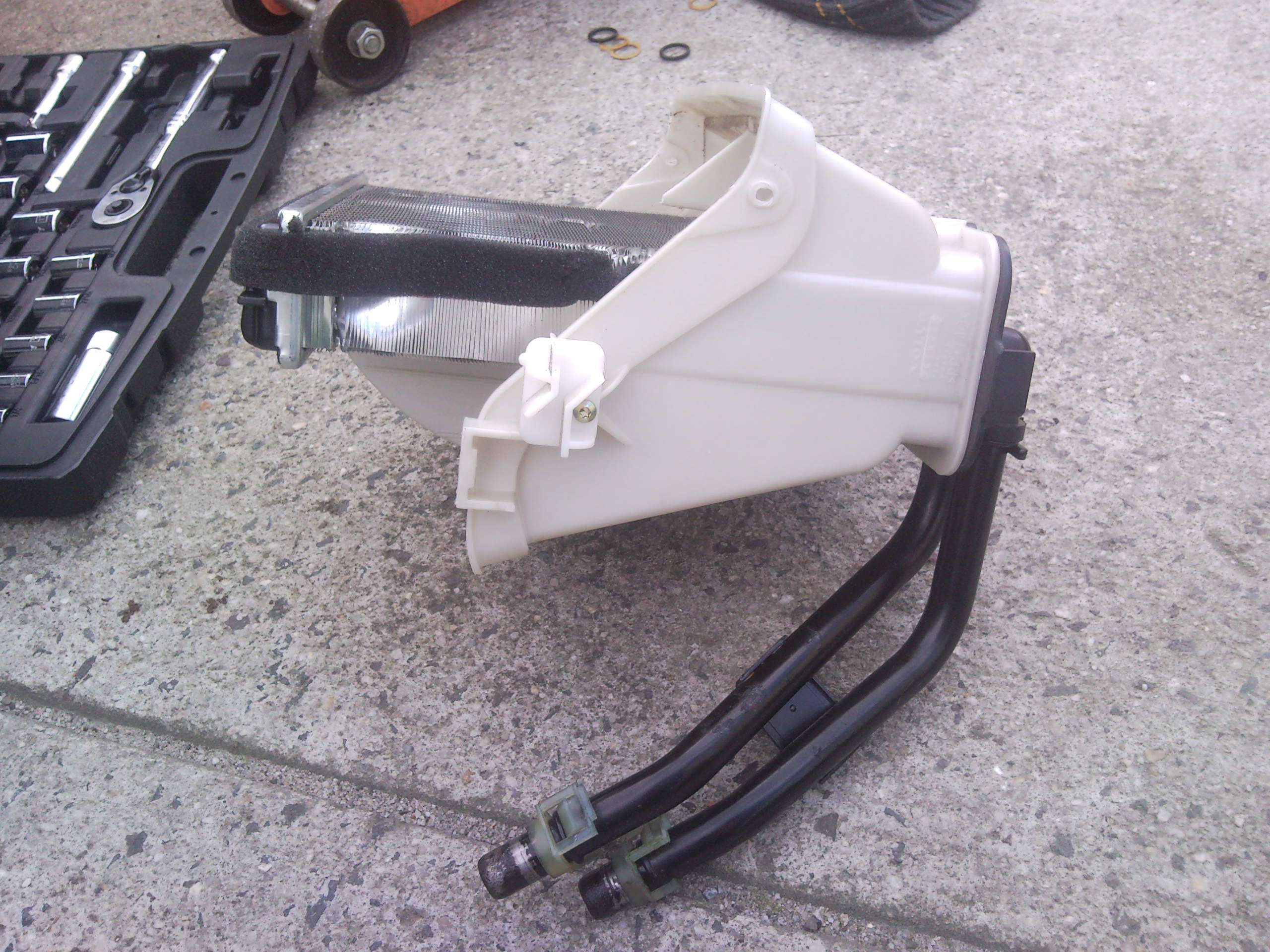

Place some old towels in the footwell to catch any POSSIBLY HOT coolant. Reach around to where the heater pipes clip into the coupling and while pulling back on the heater core press both clips. The heater pipes should unlatch after a couple of attempts.
Pic 3 Heater pipe clips

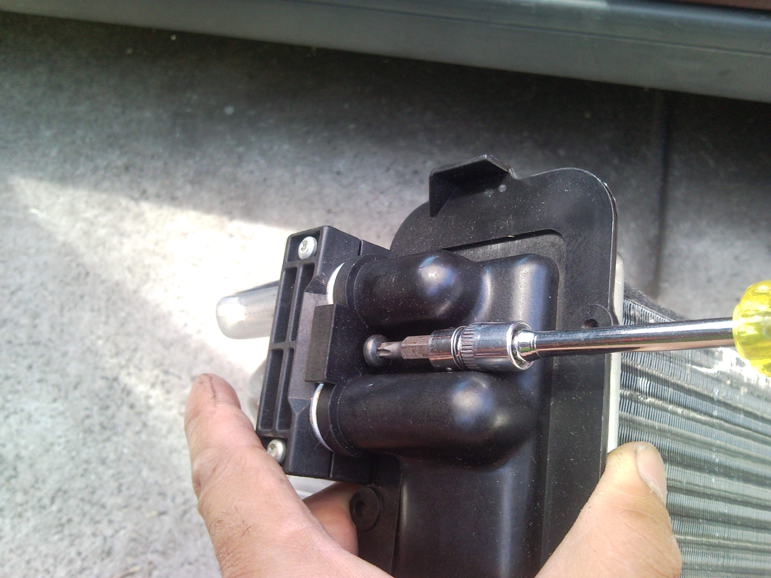

Undo the four torx screws attaching the core to the outer heater box (refer pic 5)
Pic 5 Undo the four torx screws to separate the core from the heater box

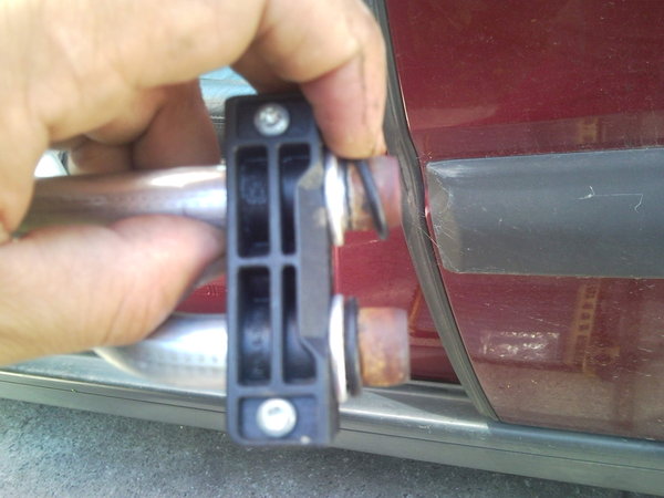

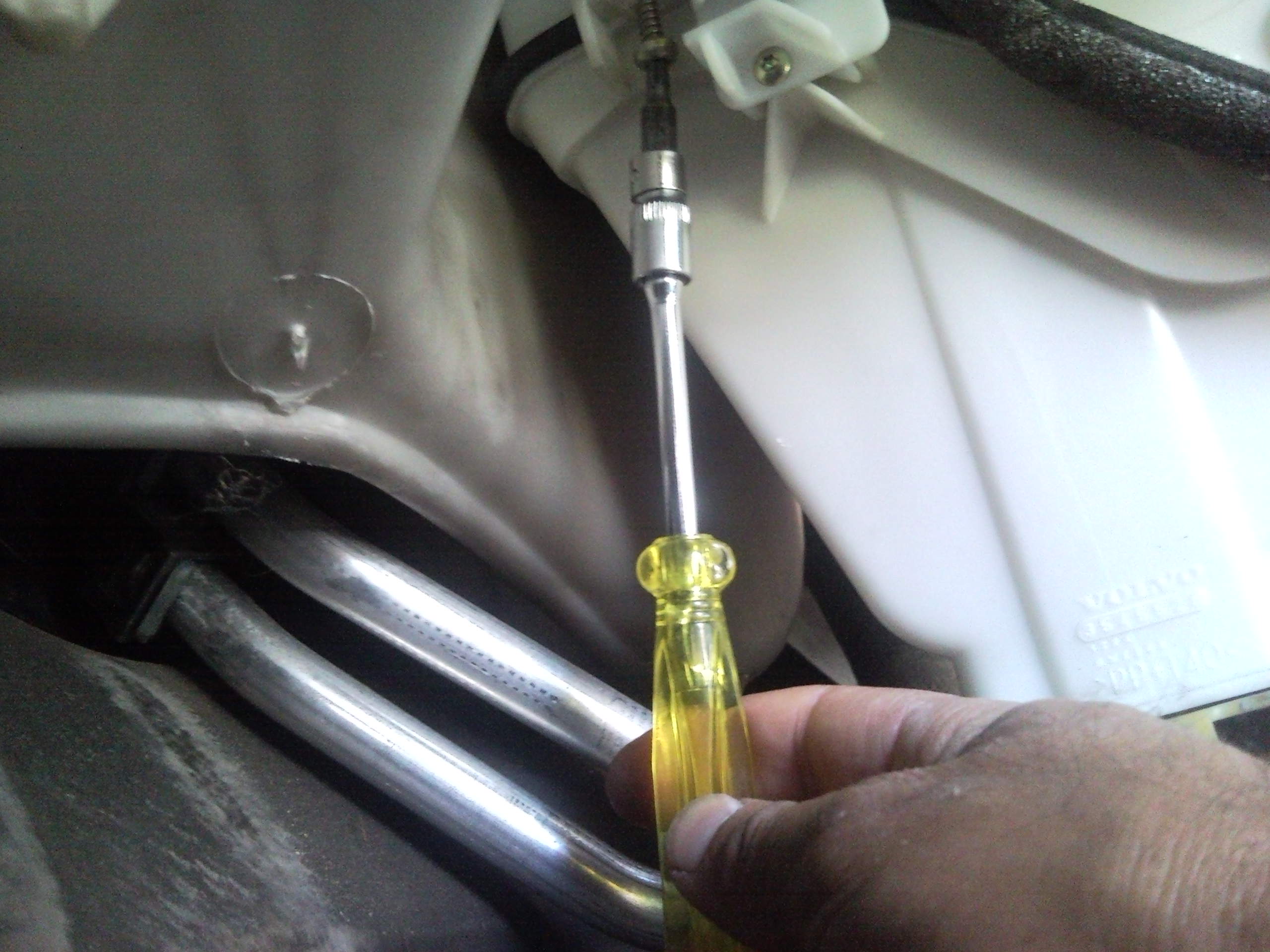

Undo the large torx screw which attaches the pipes to the heater core (Pic 6)
Pic 6 Undo the large torx screw

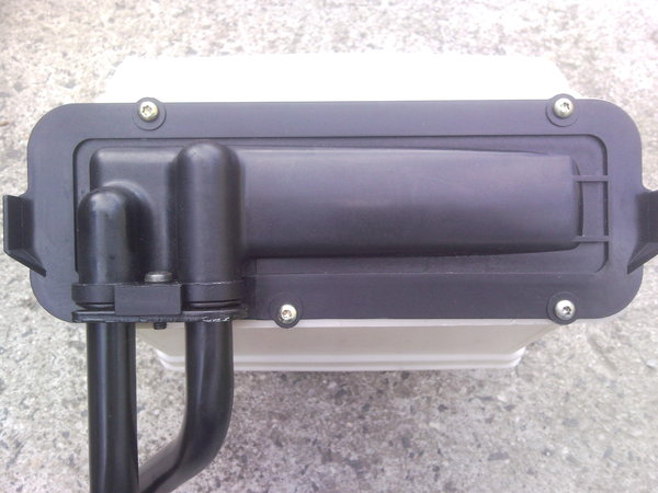

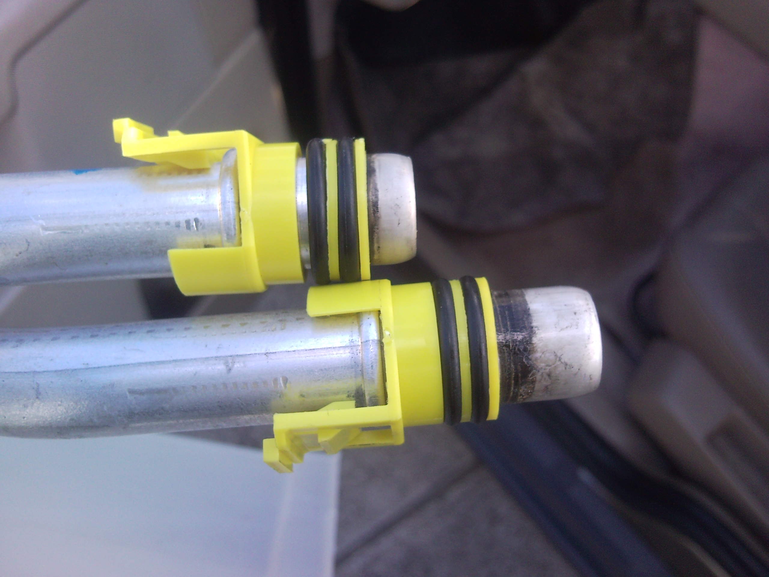

Clean up the ends of the heater pipes if they have any corrosion and place new seals over the ends (Pic 7) These seals come with the new core. At this point you'll notice that my pipes change from black to silver. This is because I replaced the iron pipes with some aluminium ones from a wrecking yard because the ends were badly corroded and I didn't want to pull the heater core twice; once is enough!! If you are doing this be sure to ask the wrecking yard for the LONGER torx screw.
Pic 7 Remove the old seals and place the new ones over the pipes

Remove the clips/seals from the inner side of the new heater coupling and place them on the ends of your heater pipes as in pic 9 below
Pic 9 Place the clips/seals on the heater pipes
