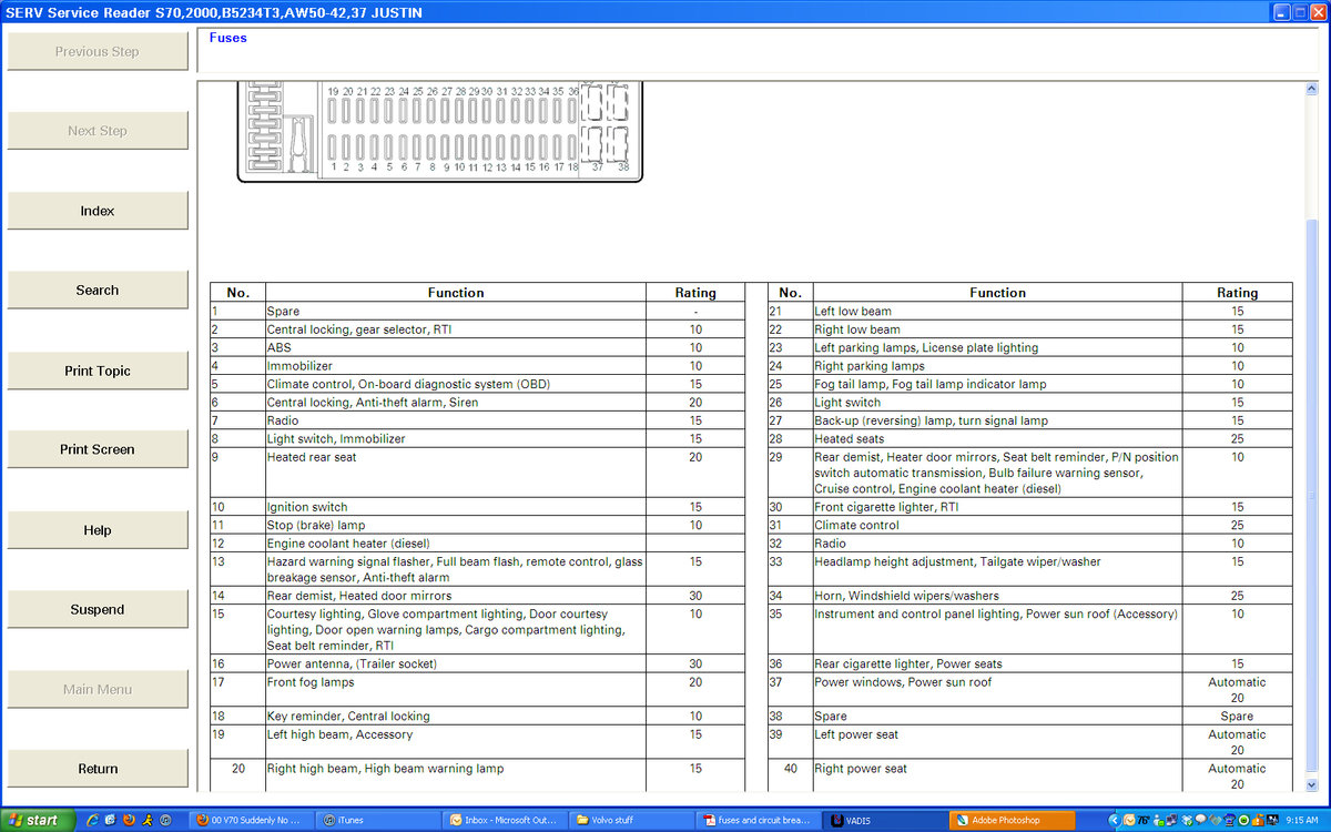

Fuse 5 will be your climate control fan. But if that one blew, the ECC panel shouldn't be working either.
I think it might be time to pull the glovebox liner and passenger side kick plate. Unhook the wires from the blower motor and jump 12V (from a battery charger or something of the sort) directly to it and see if it will run.
If it runs, there's either a bad connection or the power stage went. If the blower still doesn't run, the motor just burned out. It's rare for an electrical motor to just burn out without showing signs of struggling or making weird noises first, but it does occasionally happen.
