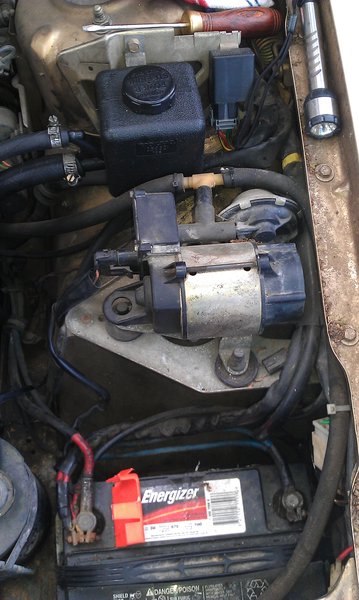

Compression checks ok @ 150psi ea cyl. I can't find anything on vacuum sys. Thinking oil being pulled into intake. Can someone explain this system? Here is a pic of my vacuum pump?
