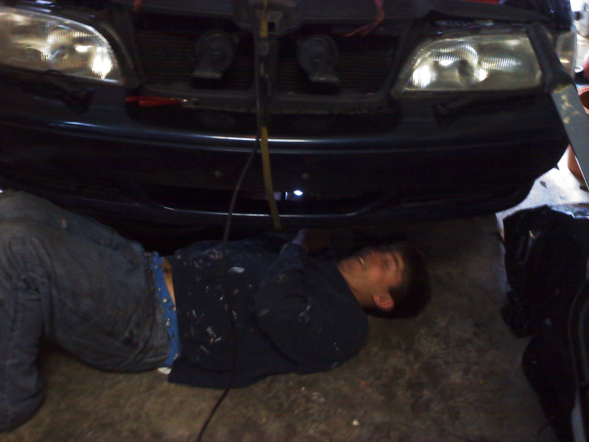

I need help with the connection to the AC. What do I do with it. It seems attached to the condenser and its keeping me from dropping the radiator. Please help!!

DON"T disconnect anything to the condenser or you will lose all charge to the a/c. I assume you are removing it from under the car. I just did one a few week ago. It took some wiggling, and pushing things aside but it came out ok

read last post on extra screws. picture included...
