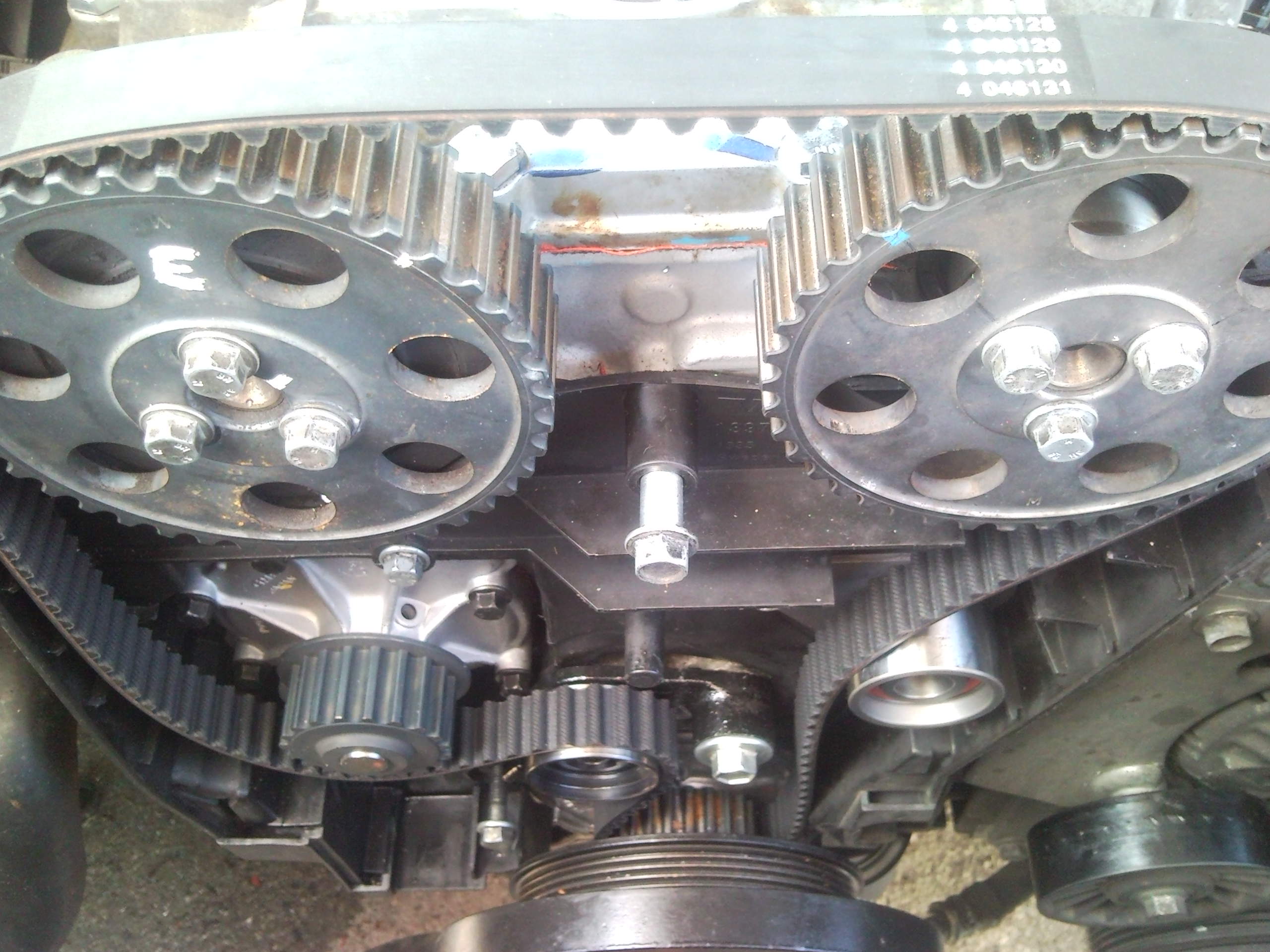

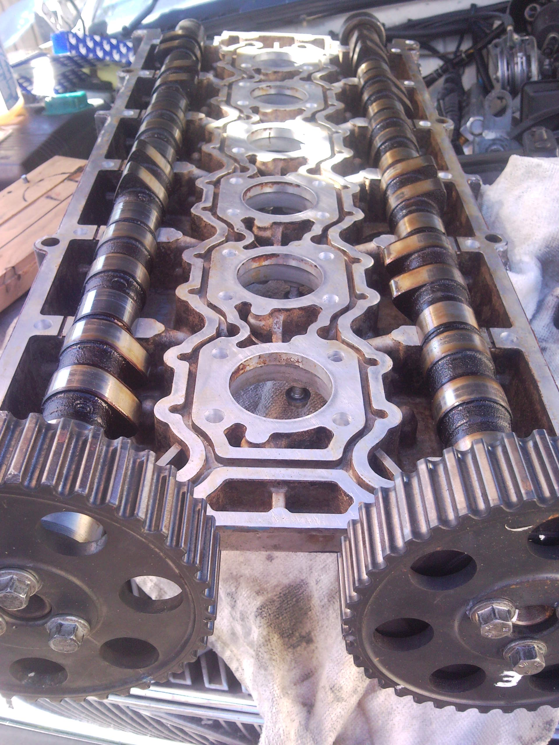

Cylinders 3 & 4 almost at TDC and the crank notch on the mark. The cam slots at the rear will be horizontal and place lobes as shown in the photo, remember that the 'E' I've marked is the exhaust side which is photographed upside down.
Be sure you place the rear cam seals in with a cam seal driver, don't try to sandwich them in to the two halves.

Just to clarify. As I view the photo- we are looking at the front- correct? If I am looking at it Upside down? (sorry if I am unsure). The cams are sitting on the engine block- Intake is to the right Exhaust to the left- but it is photographed upside down- any assistance on this is great, understand the placement of the lobes that is great (but if it is upside down???) Kaitlyn
I guess it is sitting on the cam carrier? (correct) (which of course is upside down- that would make sense). So place it this way in the cam carrier upside down and place it in this way- the slots in the back line up vertically)

Be sure you use the right words, your cams are sitting on the HEAD, the preparation of the head is simple, use moly grease on friction parts such as lobes, lifters and cam journals during re-assembly. There is a temp switch on the rear of the early ones, be sure it's not leaking, perhaps remove and put new thread tape around its threads.
Yes it's the front (can you see the cam sprockets?) so just reverse them and place them on the block if you like. I usually place all 46 bolts cleaned and pre-oiled in the cam cover and slowly torque them down with a variable speed battery drill at the lowest torque setting. After three or four cycles (start from the middle and systematically work your way to left and right)

I really think it may be a different in terminology. The block, the head and the cam carrier (at least what I/my dad referred to it as). Since there are the 3 parts. (At least there is in a 1995 model)If I am viewing the cam lobes as they are- shown- the left - which is the exhaust side- those lobes line straight up. The intake side to the right (driver's side) is lined up as shown- correct? Sorry to trouble you especially at that time. Kaitlyn

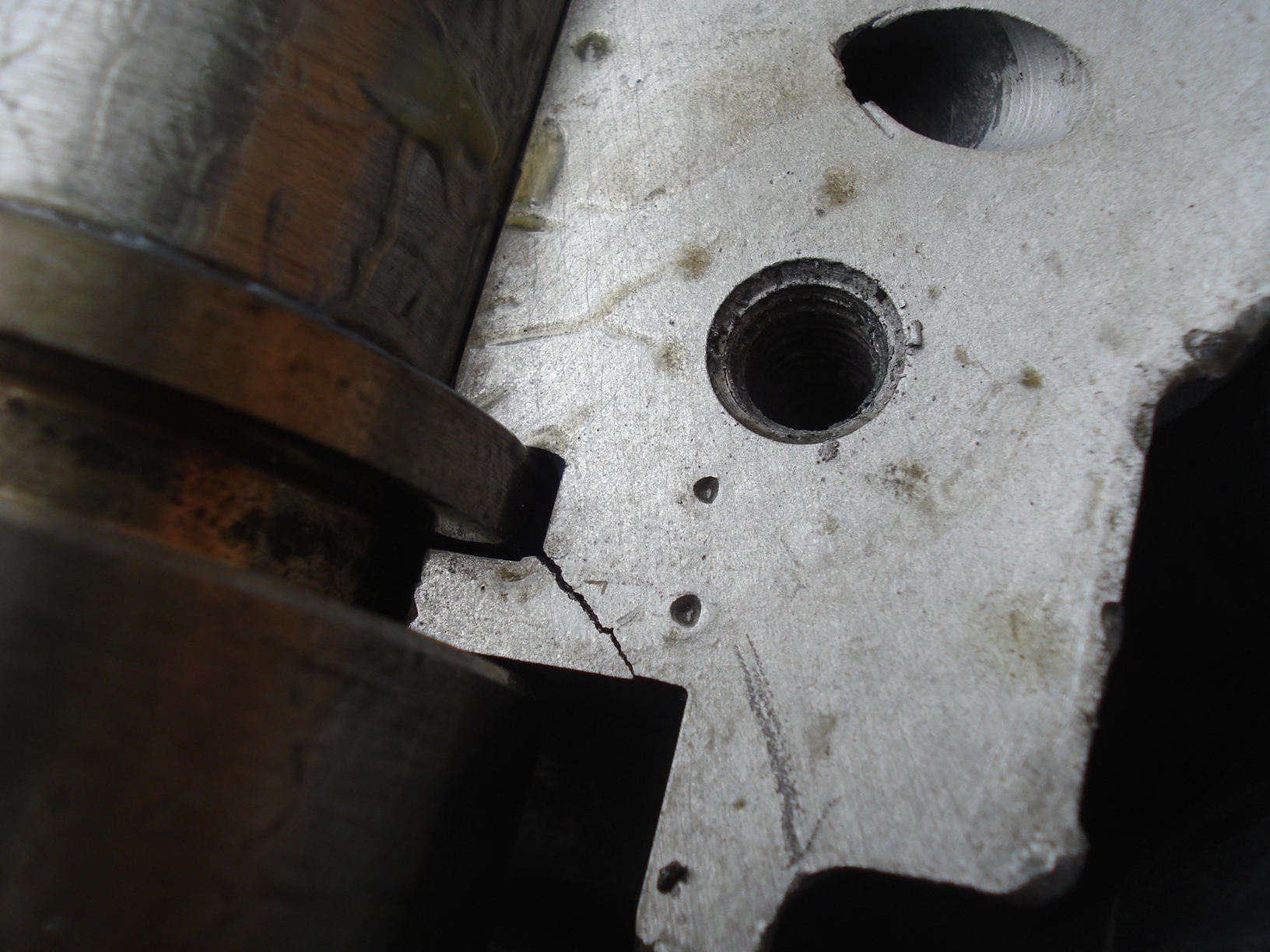

I had a very small break on the edge of my head. Machine shop guy says it was the Mechanics fault. He also stated that if he (mechanic) knocks it loose carefully- there will be no future problems there- such as leaks coming from that area. I guess I am looking for opinions. Is this a common place of breakage? (see attached) Kaitlyn

I had two very similar breaks on the front of my 960 head; didn't matter at all as you still have about 90% of the area to retain the cam from moving. Break it off and it won't cause any problem.

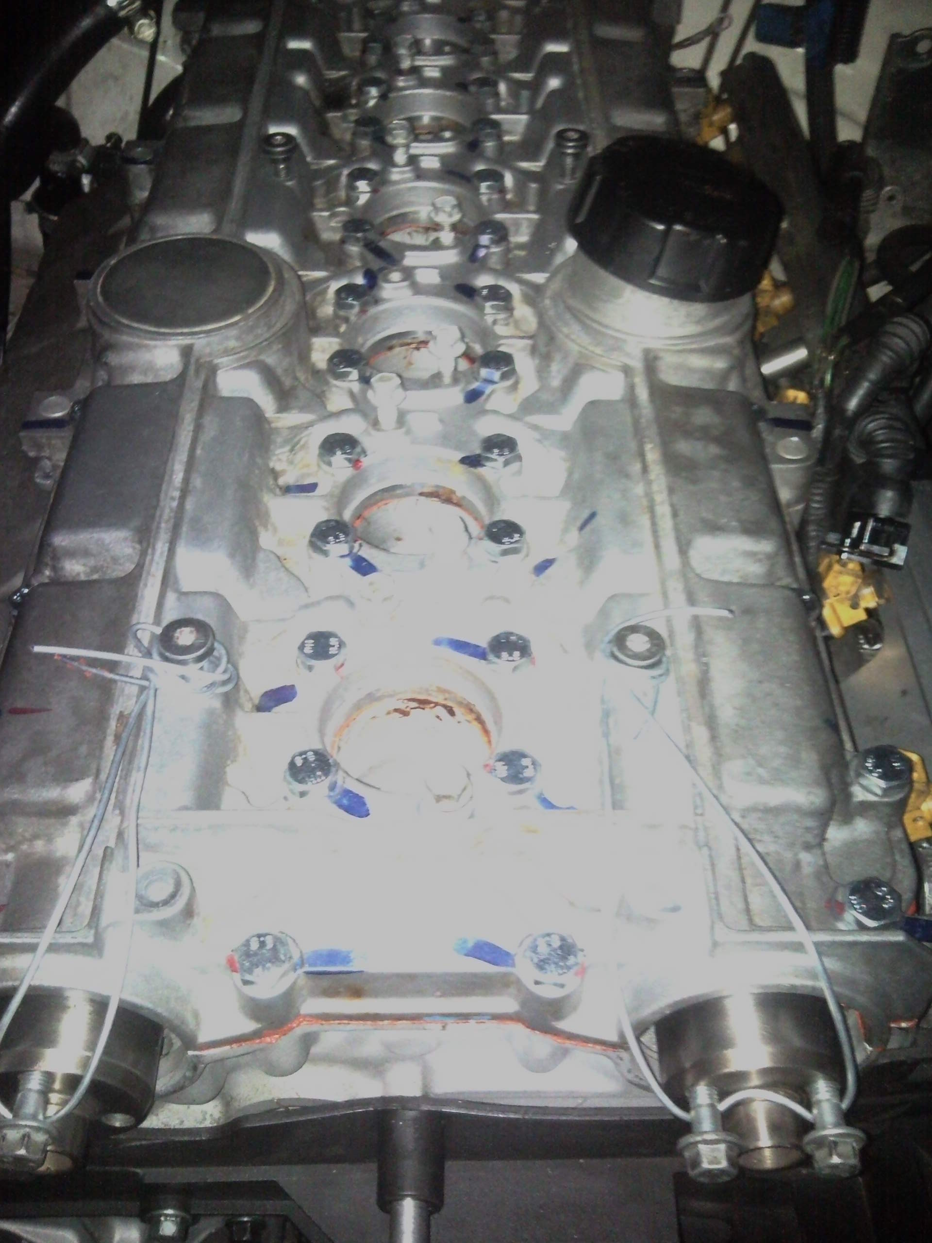

Just to clarify the exhaust side is marked with an 'E' so just rotate it 180 degrees and place it on the head. Some people tie the cams to the cam carrier with wire at the front to keep things from moving. Also you can make a jig for the rear out of wood that stops the cams falling out and then you can place it straight on to the HEAD (if you were placing it on the BLOCK you would be putting the cam carrier on top of the pistons) Hope these extra pics help

I guess it would not leak if it can be removed without any more damage. That was cracked by the person lifting it out of the head on dis-assembly, the cams need to be lifted straight up with one hand on the rear and the other at the front, keeping parallel to the engine.

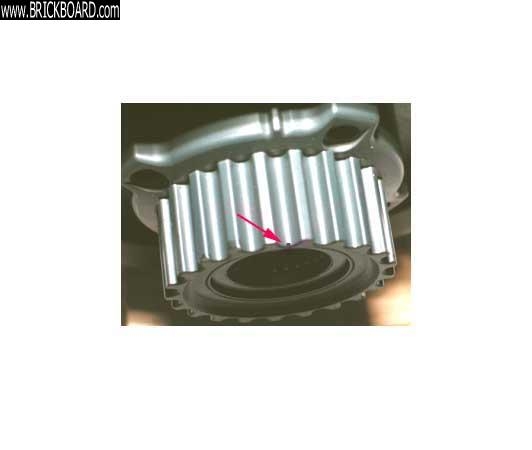

A common fallacy about the inline 5&6 cylinder engines is that it needs to be a TDC. That is just plain wrong, there is a mark on the crankshaft that needs to be lined up with a mark on the oil pump, when it is correctly on it's mark, then all pistons will be below the deck of the engine block, at varying degrees but all will be below, then one can place the cams into the head "carefully". With the crank on it's mark, then both cams are free to rotate with out interfering with a piston.

I have posted a picture of the back side of the crankshaft pulley, this pic is of one off the engine. This is what to look for to line it up to its mark.
