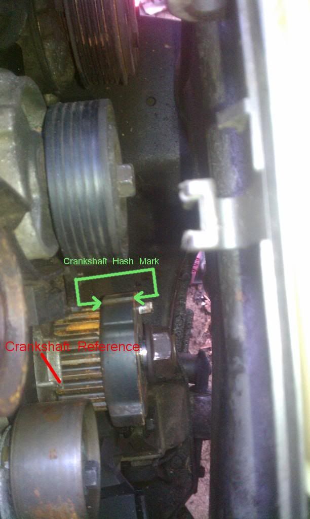

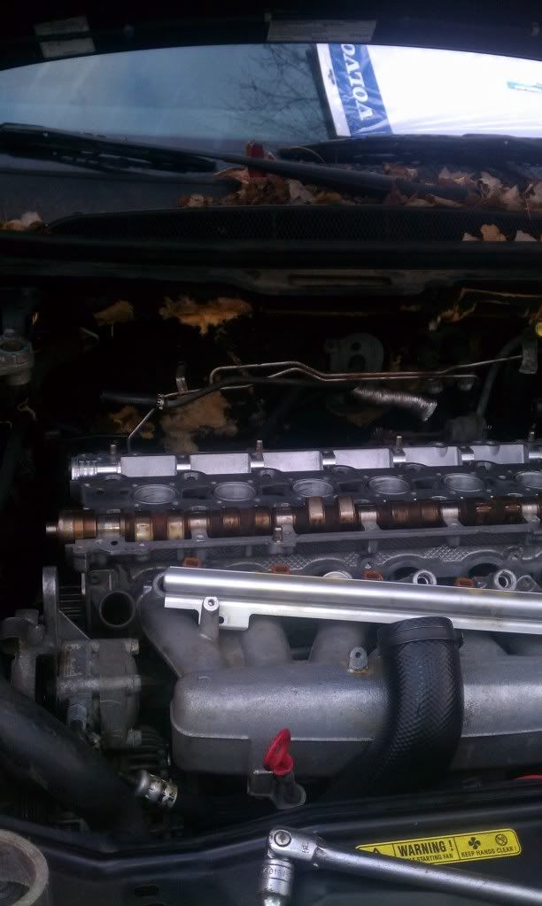

Post by UncleBoost » Sun Nov 20, 2011 4:53 pm
Here are some photos of where I am in this task.
Asking, IS this where I need to Align the Green mark with the Red Reference?
INTAKE Cam....With the Cam installed in the head, Should the OFFSET Slash be Below or Above the Centerline?
Where should the EXHAUST Slash Be Below or Above Centerline?
I will post pictures later of the Cam shaft Gears. The Intake cam gear was removed from the Camshaft BEFORE I bought the car. The V V T Camshaft is still in Tact. I looked at BOTH gears and found the FACTORY Marks for both COGS...Are the factory marks on the Cogs the reference to marks that line up with the cutouts in the Plastic Timing Backplate?
Thanks
