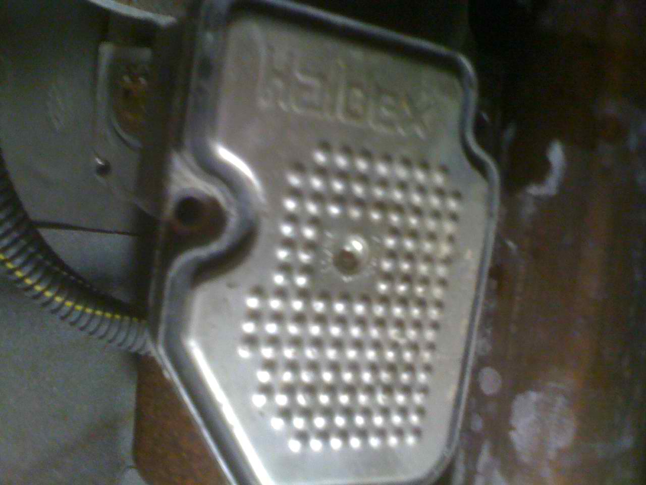

pressure sensor replacement. I have a friend WHO HAS A LIFT WITCH MAKES IT A LOT EASIER.
THE PRESSURE SENSOR IS IN A SMALL BOX ON THE FRONT OF THE Differential. REMOVE THE COVER 2 SMALL ALLEN HEAD SCREWS

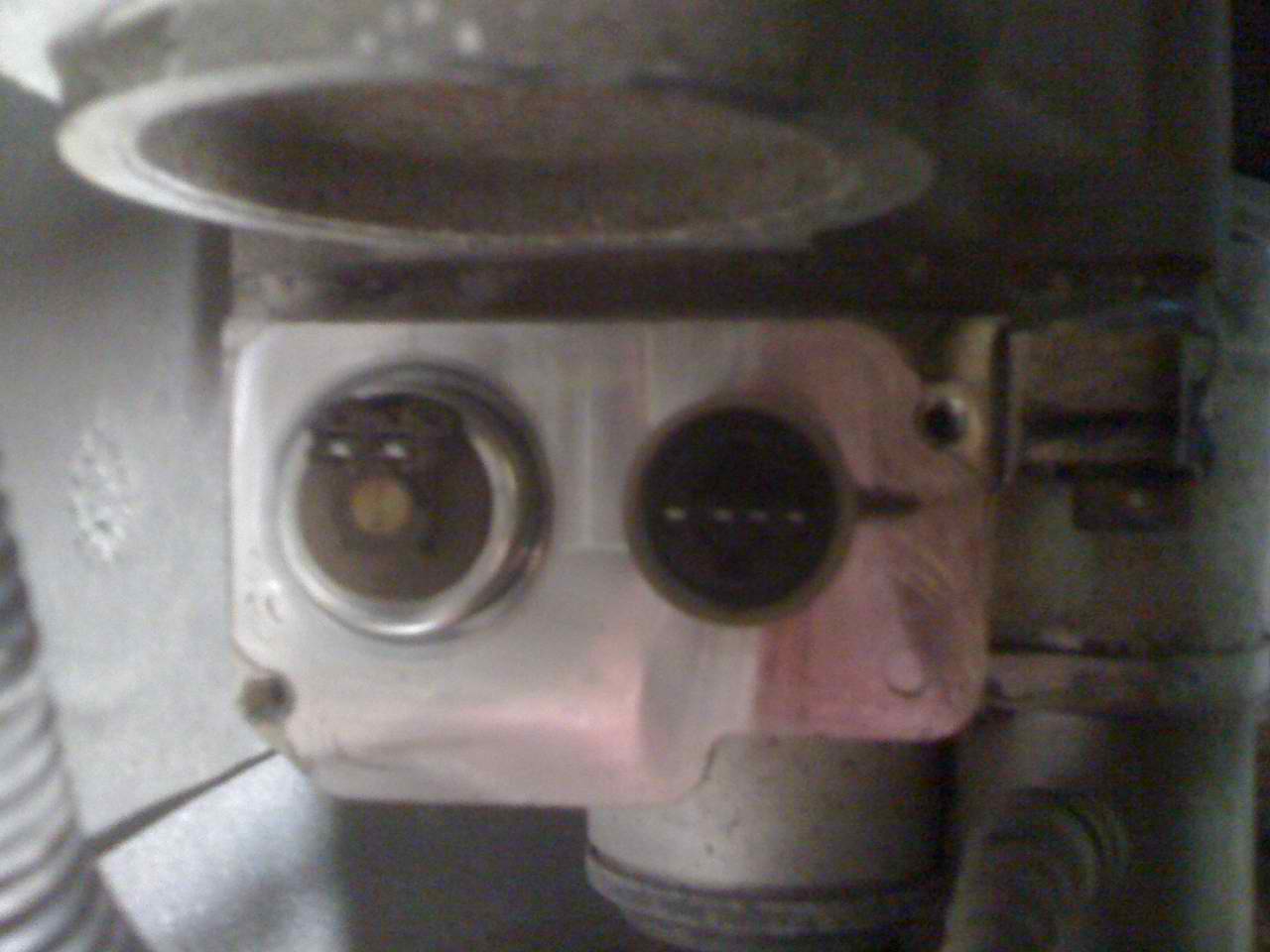

DO NOT REMOVE THE SENSOR UNTIL YOU ARE READY TO REPLACE IT YOU WILL LOSE LESS FLUID THAT WAY.

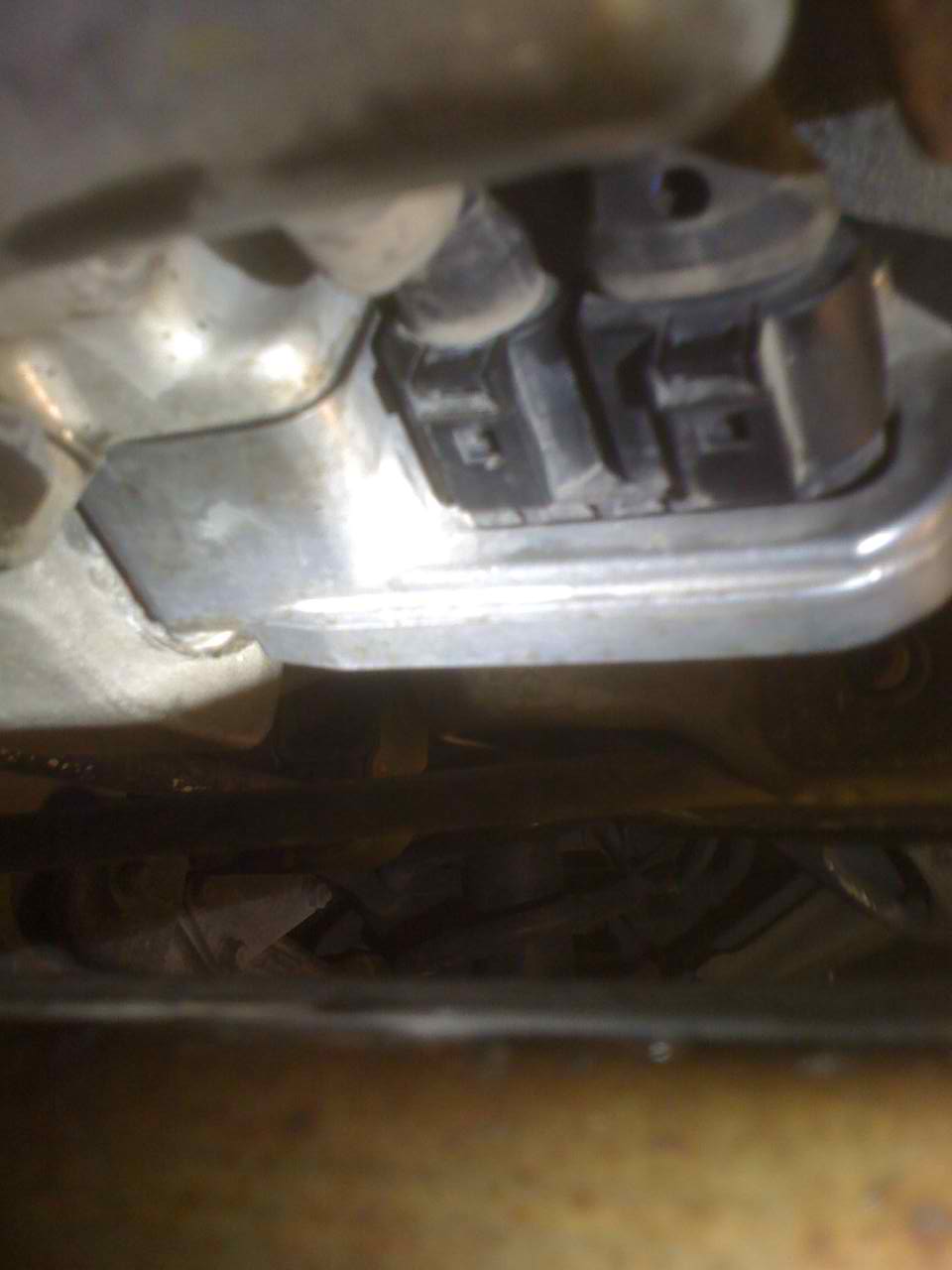

IF YOU REMOVE THE PLUGS AND TRY TO REPLACE THEM MAKE SURE THERE IS NO SMALL ROCKS IN THE WAY
