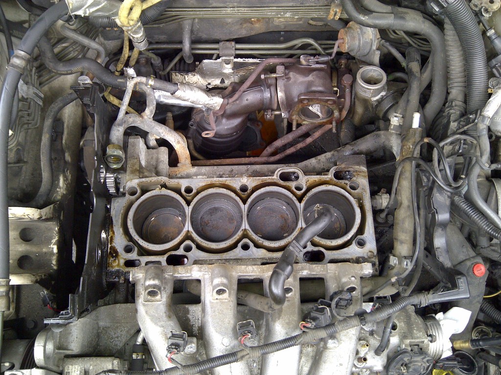

Well, you probably bent most of your valves. I had my timing belt break and you can see in the picture where the valves hit the piston heads. Lost compression completely in 2 of the 4 valves and the other 2 were weak. About to get my head back after the valve job. About a $800-$900 job to do it right.
Piston Heads.jpg (276.38 KiB) Viewed 3044 times
