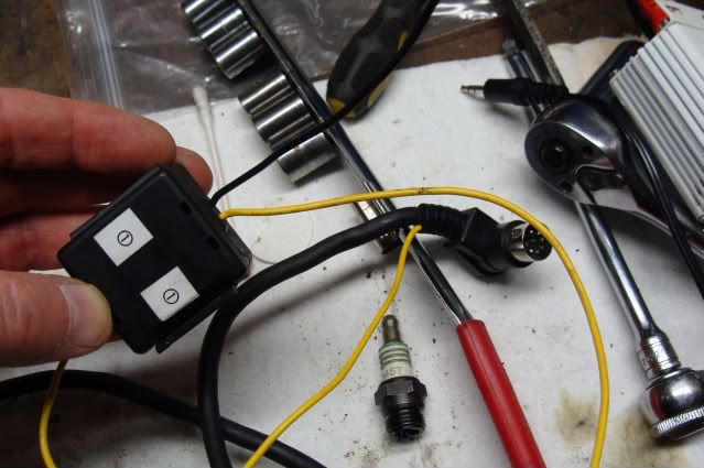

5. What are the yellow and black wires coming out of the fuse box?

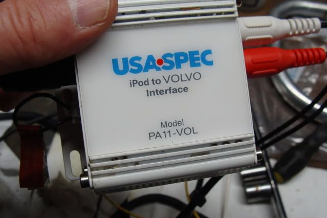

The input on that Sansa really doesn't matter.
It's the audio output that provides music.
And I'd bet it has a headphone connector.
The USA Spec should work fine with the '98.
It'll operate just fine with a headphone adapter cable.

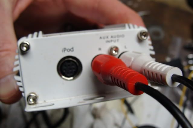

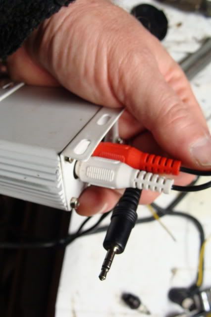

The interface unit. One of the pics shows the auxiliary audio input jacks, both red and white, and at the end of the cable a single plug. I'm thinking that single plug will fit into the Sansa's earphone plug port. I told you I was clueless about this stuff...

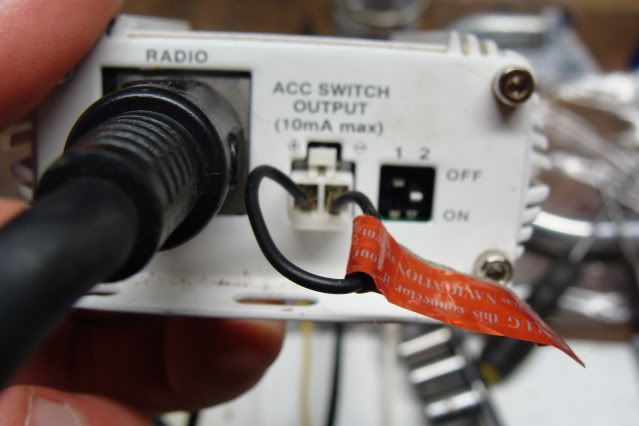

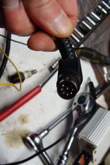

The black and yellow wires coming out of the black box are the positive and ground wires to power the interface unit and supply power to an iPod through the docking cable (which I don't see in your pics). if you want to hook it up just to play whatever is on the Sansa, then you just need to use the AUX Audio in and plug the mini jack into the headphone output of the Sansa. You'll still need to pull the radio out splice into the power source and make sure it's grounded. Then just plug the black connector pin (that has the yellow wire running into it), into the USA Spec unit and the other end of the cable into the AUX port in the back of the HU.
You can get a better idea here: http://www.ipodcarpros.com/p72/PA11-VOL ... _info.html
The beauty of the USA Spec unit for the iPod is that it powers the iPod and allows you to control it (somewhat) from the steering wheel controls.
