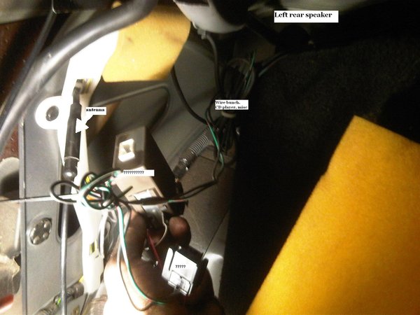

Well I will get the serial asap But i think there are only two models(I THINK) for the model car (1995 850 turbo) and I have the one with the cd player, It was just disconnected when I purchased the vehicle, as well as there have been things popping up everywhere that I have noticed have been screwed with that I was not aware of. The issue is the radio displays everything correctly and the speakers get a very lite fuzz however there getting something so I know there getting power, But it acts like it cannot tune anything I hit the auto tune and it will continue seaching through stations. So my guess is antenna. searching through the trunk looking for the wireing for the antenna the other day I found this bunch of wires right around the antenna insdie the trunk (picture below). These wires were found unplugged and there is no sign of what they were plugged into. I think these are to an original antenna but maybe Im wrong if anybody has any ideas about what these mystery wires are please let me know as well as if there are any other things to be looked at or tryed to fix this situation
