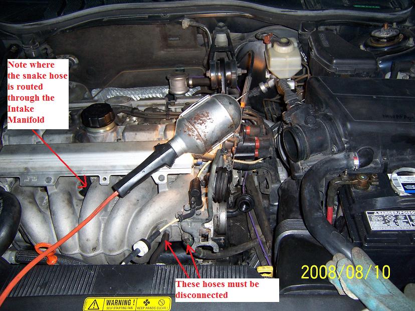

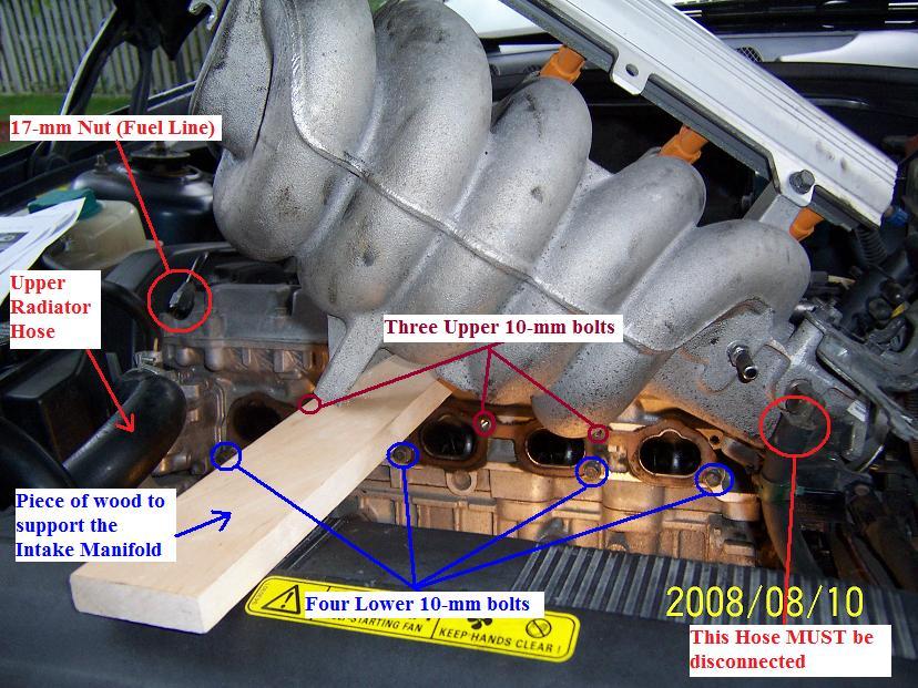

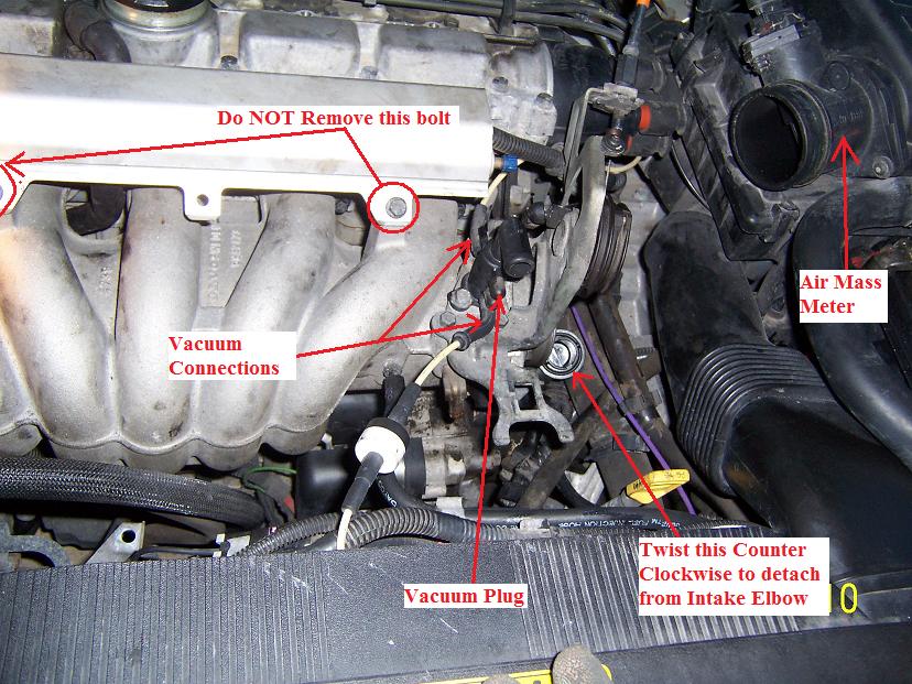

Symptom: leaking Rear Main Seal but.......at the end there was no clogging of my PCV at all.
So this was a preventive maintenance issue.
Since my car was driven on mostly highway (60%) and city driving (40%) is usually more than 10 miles, and also since I changed my oil twice a year (every 5K), there is virtually no clogging of the PCV at all. All the orifices have some deposit but the clog is about 5%. So I ended up with a brand new PCV system and a write-up for you guys!
There is a write-up for the Turbo Engine:
http://lakesidedp.com/uploadpics/pcv/
Allow 3-4 hours of work!
Search forum for best parts (not sure? Then use Volvo OEM parts, they cost a bit more but they last a long time!).
Since mine is a Non-Turbo, there are minor different designs compared with Turbo Models. In addition, I will point to areas of possible problems for people.
- Read the above write-up for Turbo.
- Copy radio AM FM channels, disconect battery for safety.
- Remove electrical connections to Throttle and Idle Valve
- Remove these 2 hoses (my vacuum hose is brittle so I replaced it)
- The PCV connection to elbow: turn it Counter-Clockwise (when viewed end on, similar to opening a bottle cap) a bit, it will come off the plastic Elbow.
- Remove large clamps holding the Elbow and remove the Elbow from the Air Mass Meter and Throttle Intake. The manifold is now attached only by: throttle cable, wiring to fuel injectors.
- When removing vacuum connections, watch for the Rubber Vacuum Plugs, they can be knocked off and difficult to find.
- De-pressurizing the fuel system by releasing the shrader valve, about 10 cc of gasoline will come out here. Re-install the blue cap.
- To disconnect Fuel line (which is flared fitting if you are familiar with home plumbing system), 17-mm wrench of the large nut and 14-mm (or 9/16") wrench on the fuel rail.
- Slightly move the fuel line a bit to ease removal of the Intake Manifold.
- The Intake Manifold has 3 Upper bolts and 4 Lower bolts. Remove the 3 Upper bolts using 10-mm socket with swivel and telescoping magnet. Do NOT remove the 4 Lower Bolts, loosen them only (Do NOT remove them).
- Underneath the Intake Manifold, there are two (2) 12-mm bolts holding the Manifold and Engine Oil Dipstick.
- I use a piece of wood as a "bridge" to rest the Intake Manifold to avoid straining the driver side connections (throttle cable, wiring to fuel injectors etc.)
- The Oil separator has 2 bolts. The short rubber hose to the engine block uses 2 clamps (torx).
- As mentioned in the other write-up. Make a note of the hose connections so you do NOT get mixed up. Also attach the hoses and clamps on the Oil separator before installing the Oil separator.
NOTE: For the clamps: I use a Ceramic Tile Nipper but I file the edges smooth to avoid sharp edges cutting through the clamp. Alternatively, you can use the Pliers that Sprinkler System Installers use.
- Remove the old gasket, clean the mating surfaces using a rag and paint thinner (or mineral spirits) to wash off the gunk.
- Note for all installations: use a small dab of grease around hoses, elbows etc., this will allow smooth installation without tearing the hose or damage to the connections.
- Install new gasket. I apply a bit of grease to help hold the gasket in place during installation. NOTE: Now remove all 4 Lower Bolts, then loosely install them with ONLY 3 turns to allow room for the Intake Manifold to go in. Watch the passenger's side of the Intake Manifold, it can hit the Upper Radiator Hose near the thermostat!
- Do Not foget to re-attach the small vacuum hose attachment on the pass side of the Intake Manifold. Then snake the Rubber Hose through the Manifold between the 3rd and 4th Intake Space. Re-install the Intake Manifold taking care NOT to damage the gasket. Tighten all 7 bolts. Do NOT forget the 2 bolts underneath the Manifold.
- Re-attach Fuel Line, Intake Elbow, Electrical Connections, Vacuum Hoses, Rubber Plug (if you knocked it off!).
- Connect battery. Prime the fuel system by turning key in Ingition to II position (without starting engine) a few times to prime the fuel pump.
- Start engine, watch for any fuel leak at the flared fitting. Test drive the car.
- Re-program the radio.
Good Luck!!!
