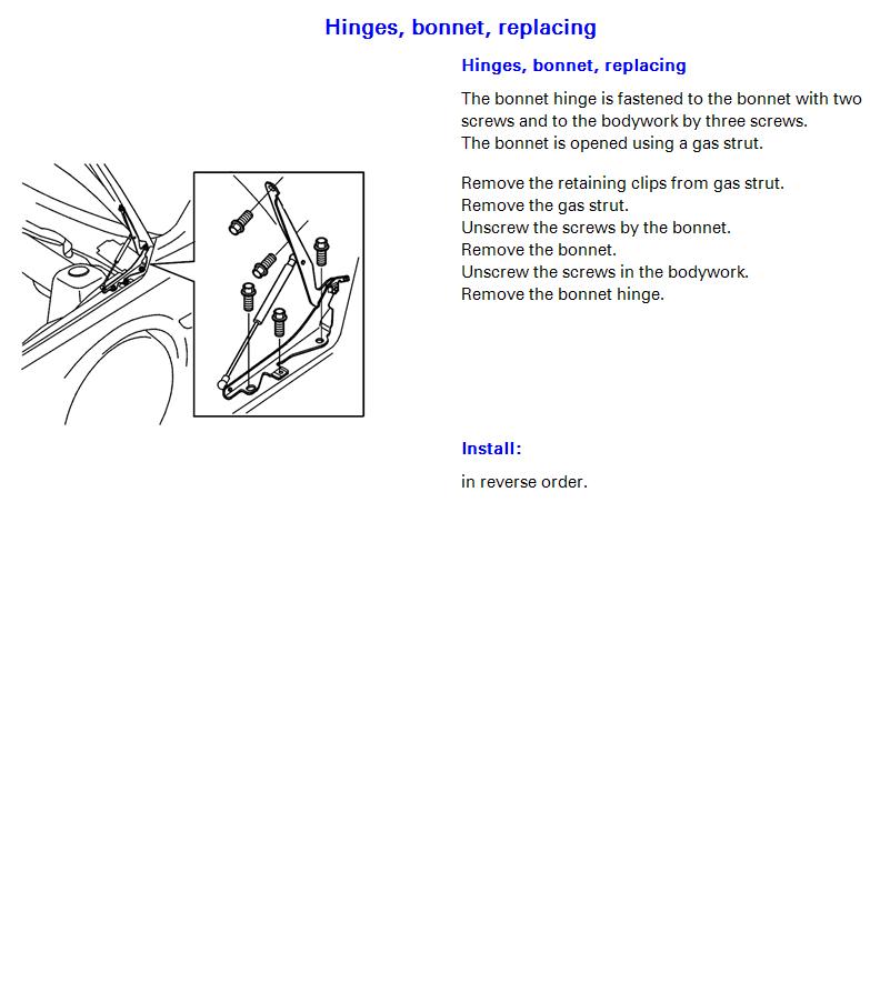

I just purchased OEM hood struts and want to replace the old ones myself but not sure how to. Can you help.

Here's a picture that will help. Says to just remove the clips from the strut. This shows how to remove the entire hinge...you don't want to do that. Just the strut.

Thanks! Actually easy to remove spring and replace.
