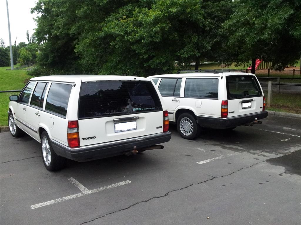

- We still love our 960s. New blocks and all....
- 2011-12-11 10.02.40 (Large).jpg (170.03 KiB) Viewed 621 times
