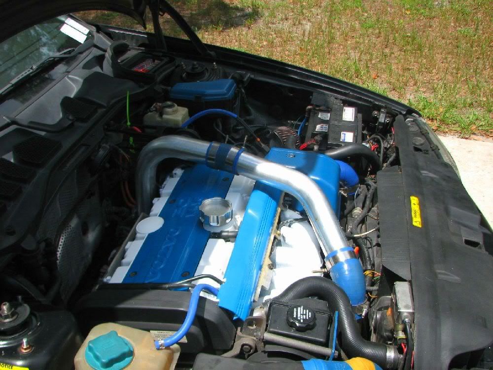

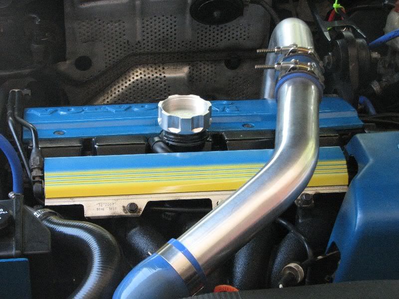

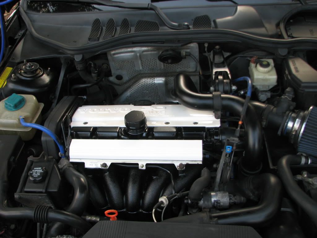

My engine at one point seems to have gone thru a different color combo everytime I opened the hood.
I have over 20 different engine paint set ups but these are a couple of the ones I liked more.
You can do any of this with engine paint found at a autozone or advance auto. Spray can works fine.
Just make sure you tape some stuff off if you start spraying the engine.
and light coats on the spark plug cover.
Wash the plug cover VERY well with soap and water, lots of rinsing and some degrease to remove any oils that have soaked into it, or it will come out looking bad.
Currently it sits waiting to be polished, I put the plug cover back on, but I havent had time to go back thru with different grits of sand paper to shine it up.

Rob, did you tape off the intake & head to paint them or were they out of the car when painted?

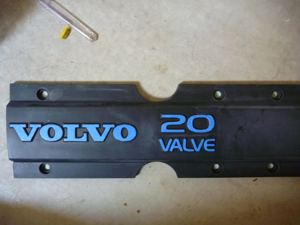

Here's my cover. I've wanted to paint the words in white but I just haven't gotten around to it - yet

Nope engine and everything was still in the car.

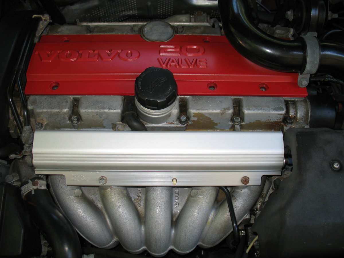

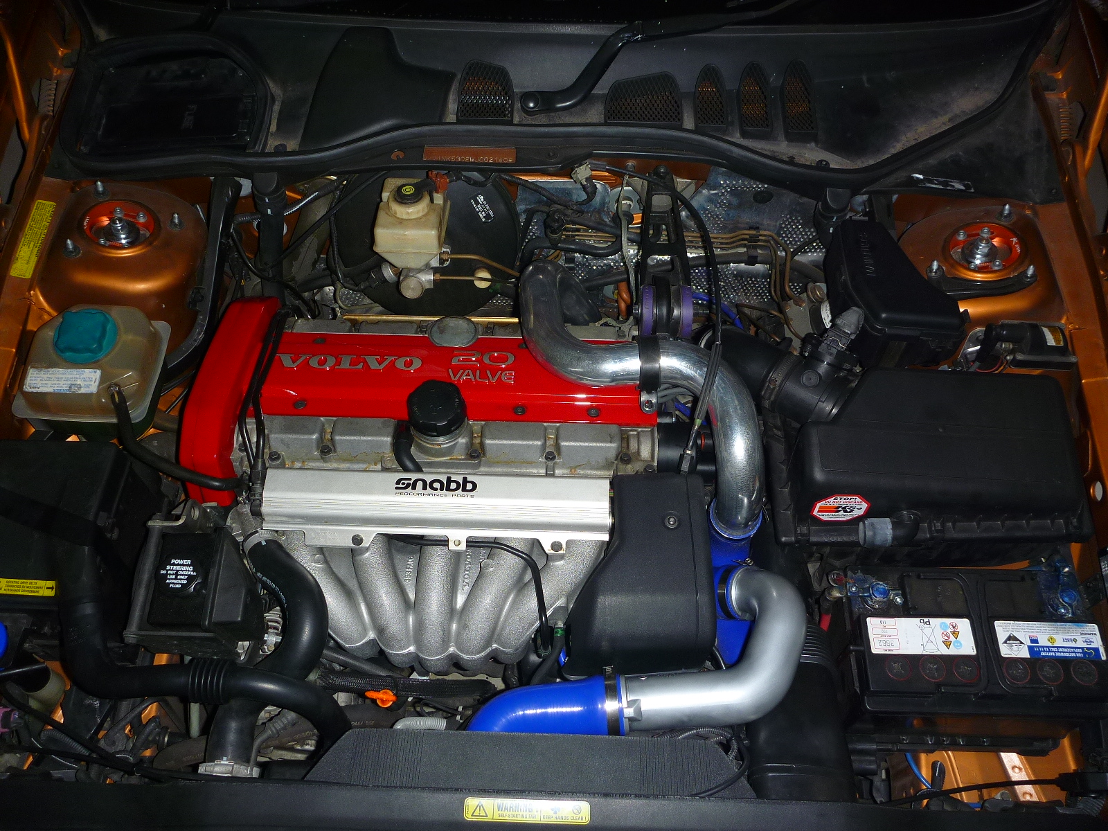

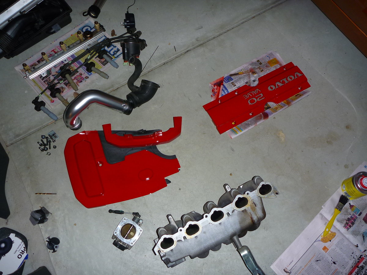

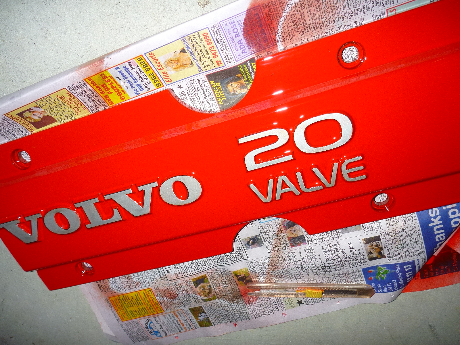

I took some pics of mine while I was doing the job, thinking one day when I get off my a$$ and join the forum it may be helpful to someone
I masked up the lettering with tape, and once painted over, just peeled the tape off. It still didn't look right, so I got a Q-tip dipped in white spirits and stroked it over the raised lettering, removing any remaining wet paint. I did it while the paint was still slightly wet. Worked a treat. The silver lettering in the pics is of the original paint. I Preferred it like that vs just painting the entire panel.

Man, that is a sweet job!

Thanks! I should have also mentioned that you can achieve a similar result by using a paint pen. They sell them at the local hardware store in all different colors. It's good for if your not actually going to paint the cover and want to touch up the silver highlights/change the color.
