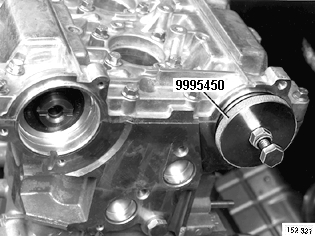

The bolt is standard thread (lefty loosey). With the tool in the vvt and the tools arm pointing towards the radiator you should be lifting "Up" to remove the bolt.
Please send a pic of the interference between the VVT and the cam cover as I don't have one in front of me but recalled the last one I did (on an 06) did not have that issue. I remember it sitting on the bench with the VVT still on. (Just dont remember if I put it on after removal) I have never had an issue getting a VVT off so I am far from an expert on this one.
If you snapped off the cam end then you have a loctite or misthread issue. Or cam lock tool was not fully inserted (not accusing - just listing possibles).
Depending on how flat the broken area is you can use a flat block of metal and use the remaining tab as the lock. With one bolt in the end of the cam and another in the block or with any counterhold you want you should get one more shot.

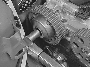

The 8mm outer screws also come off and allow the gear removal without hub removal. If the outer gear is the only issue (still like to see a pic of yours) then this should help you.

This is the set up I am used to seeing. The back of the VVT hub is usually flat and sits on top of the seal with no interaction or restriction of the cam cover. The 8mm bolts allow the outer gear to be removed by sliding the gear off the VVT.

JDS60R, your advice on removing the exhaust cam gear and NOT worrying about removing the VVT first has saved the day!
All my manuals have been telling me to remove the VVT with the gear attached as to not mess up the slotted timing spec of the exhaust gear in relation to the VVT - but in light of the center bolt not coming out of the VVT your advice to just take the gear off anyway separate from the VVT was exactly what we needed to get back on track. Fear of not being able to time it correctly has prevented me from doing this before but I'm glad you said just go ahead and do it, because it worked. I'll worry about getting the gear lined up with the VVT properly when the time comes. I marked it's relationship before taking it off. So I won't be too far off.
I now have the top cover off and can better access that VVT center bolt.
