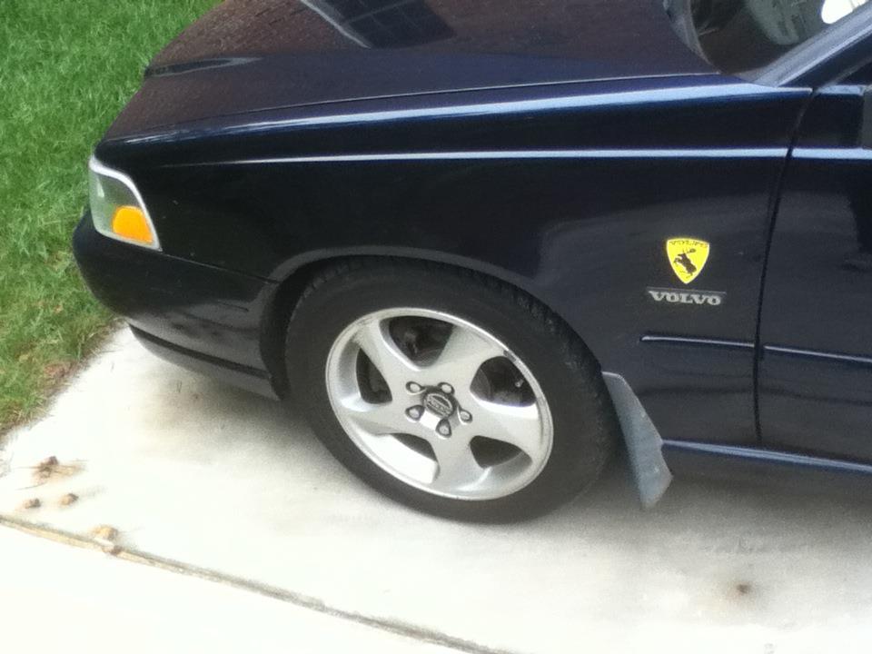

September 29th-
-Replaced defective Duralast 47DL with new one- $52.00
-Re-positioned top PCV hose- was leaking slightly.
-Purchased jumper cables...
October 4th-
-Re-charged A/C with 12oz. can R134A from Ollie's- used about 3/4 can. $6.88
October 9th-
- installed Volvo tire stem caps.
- Put 2 "prancing moose" magnets on either fender from Dave Barton- $8.60
October 10-
-Replaced missing passenger side fog light grille with new OEM part- $14.70
-Installed iPd license plate frame- $2.00
-Filled tires to proper pressure(s), incl. spare.

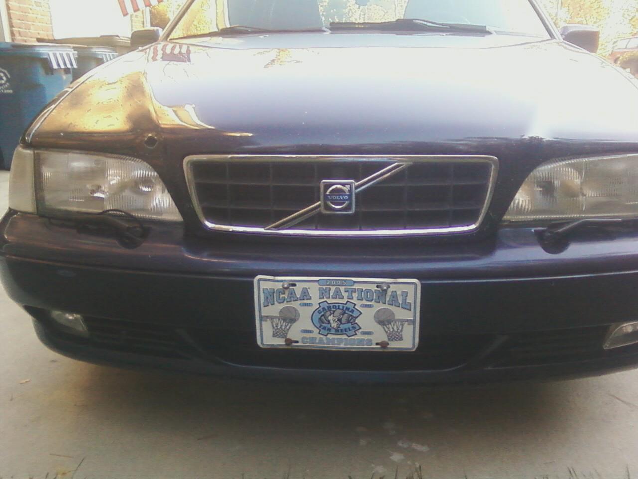

November 25,2012- 219,697
-Replaced upper heater hose with almost new part from junkyard
-Replaced cracked drivers side headlight lens with good used unit
-Replaced all coolant
-Installed wiring for model year 99 side marker lights
-Installed 1999 C70 windshield washer "fan" jets
-Put on "I <3 My Volvo" plate found in junkyard
