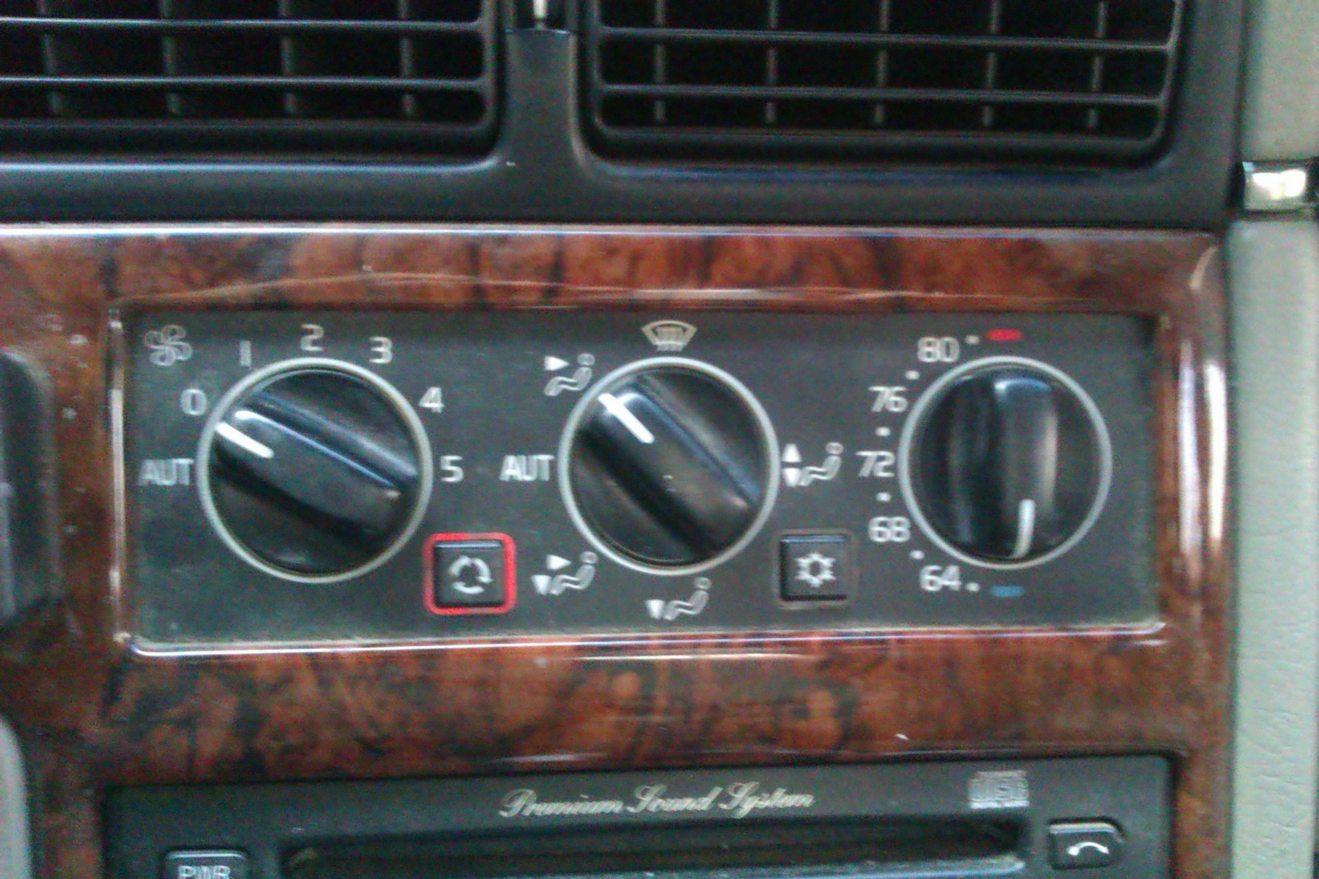

The blue light which surrounds the AC button flashes all the time, even when the AC is off. It is a continuous flash, it is not flashing out a code. There are no computer codes. When I turn on the AC it only sorta works. It won't keep up with an Arizona summer.
This started happening right after I had the timinig belt replaced.

Hi Jimmy,
My problem is entering the ECC diagnostic mode.
I put the car outside with direct sun on the dash, therefore on the solar sensor. With the engine running, I then put the blower fan control in AUTO, the function selector in VENT and the temperature knob to MAXIMUM COOLING.
I start with the AC and RECIRC buttons off and then, within 5 seconds, I turn on the RECIRC button on followed by turning on and then turning off the AC button.
As I read it this should put the ECC in diagnostic mode. It doesn't so, what am I doing wrong.
Rick
Rick

You are turning off the AC. After depressing the Recirc button depress and release the AC button within 5 seconds. Self diagnostics should now start.

Just as Bill said. BE sure your snowflake is red then you depress and depress again so it ends up being red.
Wait a minute! Your a/c button is blue? If so your ECC panel has been replaced with an older one. Not that it will not work just the a/c button strategy is different.
If blue button then start with it not lit, depress and depress again and will be unlit when before it begins to blink the codes.
EDIT: I can't get my 95 960 to display codes. It has the A/C OFF labeled button and I tried it with it lit and unlit and I tried putting the knobs in the positions just before asking for code display.
