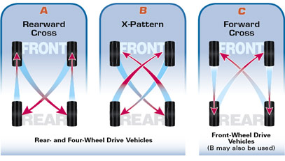

I second Jimmy's assessment. It was my understanding that cross rotating was the standard way to do it, as shown below in example B. However, my understanding aside, what is the consensus here on proper FWD tire rotation? What does everyone else do? Jim, are you saying that the tires should stay on the same side of the car permanently?

I think you need to be very careful as a lot of tires today have directional tread patterns. So you can't cross front/rear, your tire would be going the wrong direction down the road.

After I knocked myself out I looked at every major tire manufacturer and they all (Continental does not have a chart I could find) show cross rotation as the recommendation.
Again as listed in my post above, directional tires are not included and go front to back only to preserve the tread pattern orientation that makes them directional. The limited number of cars with different size tires front to rear also are excepted (these tires usually last less than 15K anyway..).
At the shop where I work we do front to back rotations. I'm not entirely sure why, but I'm certain we do it simply because its easier to do one rotation pattern for all cars (for directional and non-directional tires).
