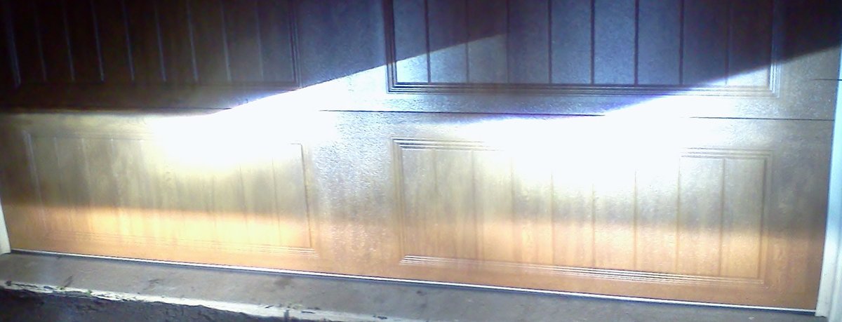

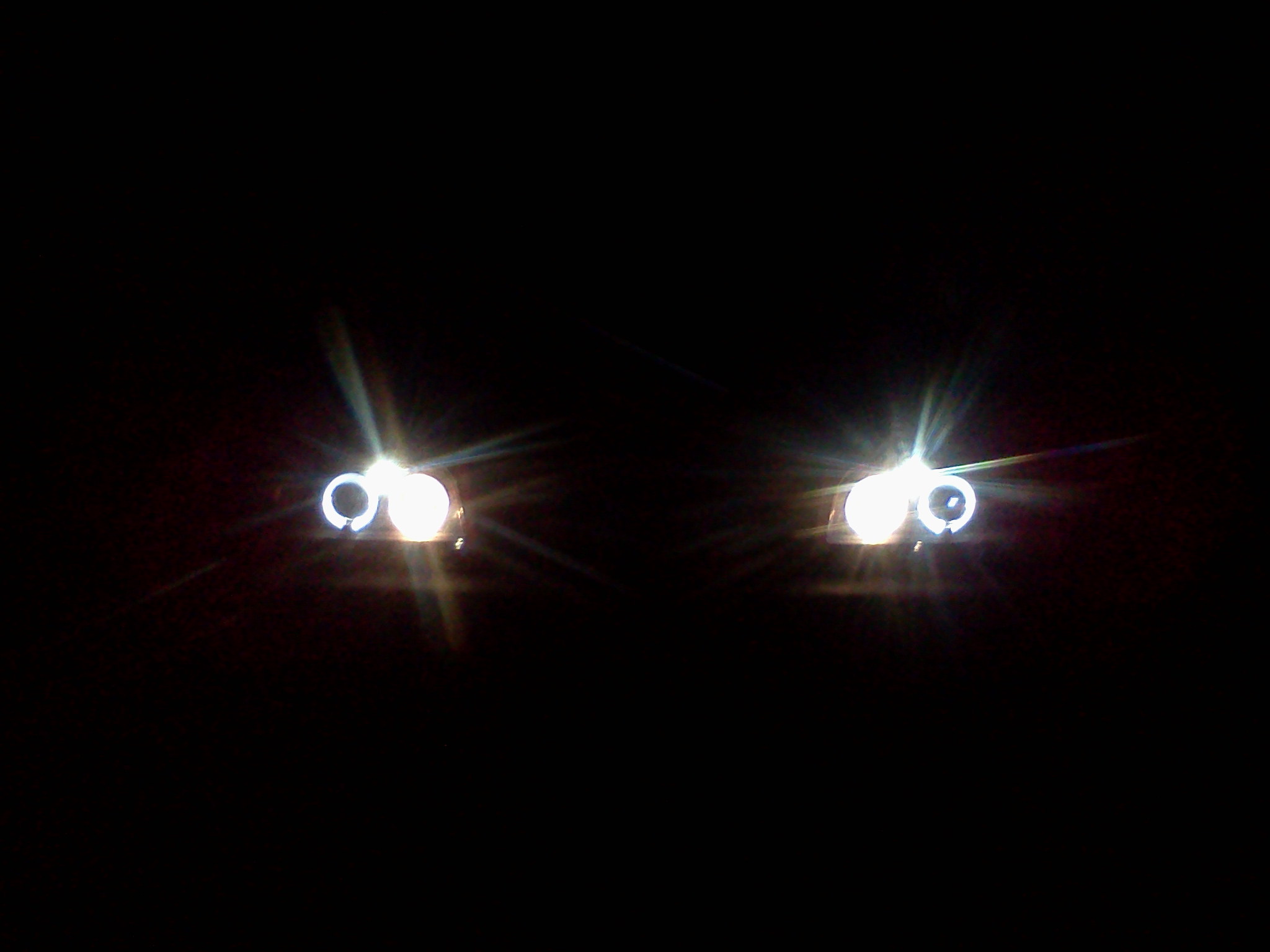

I'm rocking the black halo/angel eyes on my red 850R sedan. I'm less impressed with the halos. Even though the projectors have the european halogen cut off the _/ _/, rather than the _- _-, with a 35watt HID kit, they are an improvement over the stock headlights. Pick up a set of stealth or chrome bulbs for the turn signals as it's a heck of a lot easier to swap the bulbs before you put them in. I did not and the "egg yoke" look is ugly. There is a guy in my area that has a nautic blue 850 with chrome angel eyes and they look decent.

Installation was straight forward, out of the box the wiring is not set up for the halo rings and a small LED between the high and low beams. I tied that into the parking light on the headlamp assembly wiring. I think they fit pretty decent and if you take your time with the three bolts that attach the assembly to the header/core support you can create an even gap. Installation was not too bad.
I'll attach some pictures, they are not the best, by phone is nearing the end of its life.
- Dirty car with the required by law front uglyness... Oh and the egg yokes.
- 0705121553.jpg (150.66 KiB) Viewed 3351 times

I disabled the auto on/daytime lights on the car and I also modified the 213 fog light jumper.
I connected the halos, the "city light" in the high beam reflector, and the LED are all wired to the lead for the parking lights. It's pretty straight forward. I know some people use the wire taps, I used weather proof but connectors that have shrink tubing on them and like I said I only modified the harness on the headlight assembly, not the car harness. There will be two connections, one for the turn signals/parking lights and the other for the high and low beams.

Oh, sorry I was unclear. Out of the box my set did not have the wires for the halos or the LED's between the hi/lows hooked up - I decided to hook them up the way I did, but you could easily wire them up however you wanted. I cannot imagine that running the halos off the rear fogs would be a too much of a draw, the wiring was like 18 gauge. IPD's directions discussion hooking them up. http://www.ipdusa.com/products/7072/113 ... dlamps-850
