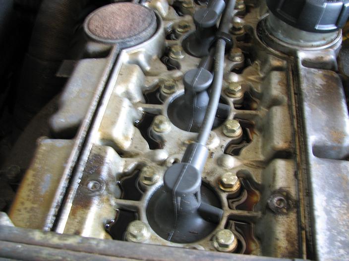

If you seal up the filler cap you are not addressing the cause. You will eventually start blowing out cam seals and possibly the rear main seal. You will have to drive with the dipstick partially open to alleviate the pressure.
I know because that is exactly what the previous owner did to my engine. The rear main seal leaks now but I can deal with it until I can borrow my friends engine lift and driveway.
I changed the plugs a few days ago and found the results there as well. About a half inch of oil was also in each spark plug tunnel because the '93 original plug boots don't have a tight seal.( I changed those as well.)
Good luck with which ever way you choose to go.
- Oil from the filler cap.
- Pkug Valley.jpg (66.12 KiB) Viewed 1498 times
