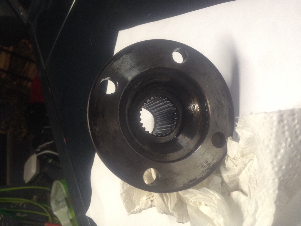

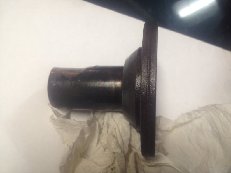

Post by pehoffer »
what is the name of this part?
Thanks again.
what is this called?
scoring where the tailshaft seal rides

Post by lummert »
Companion Flange: OE number 1233402 (NLA)
