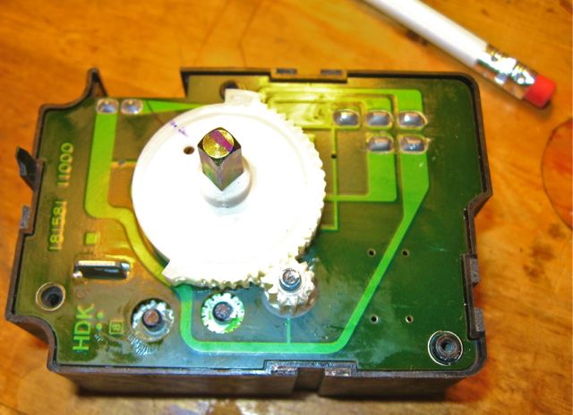

The picture below shows the top side of the circuit board after lifting the gear wheel out. Be sure to mark the relative rotary position of the center wheel so you can re-install it later at the proper position.
After unscrewing and removing the top case of the damper motor

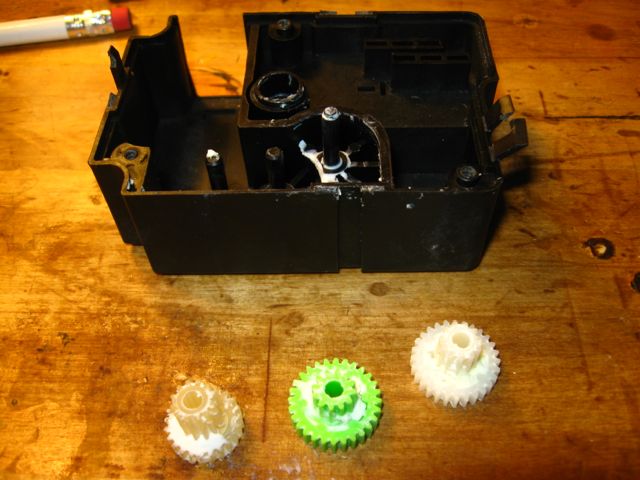

Then you can lift out the three gears one at a time (starting with the white gear on the right since it's at the top of the stack) and clean all the old grease off. I used a nylon bristle brush and some hexane solvent.
Gear removal and relative position of the gears

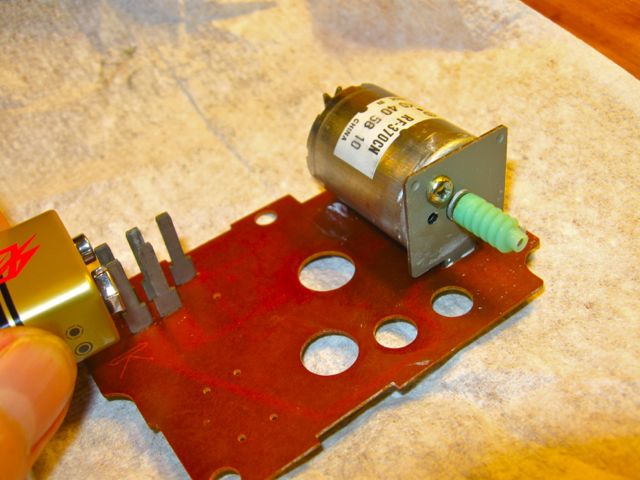

Next I tested the motor with a 9V battery by connecting the battery directly to the two connecting pins at the far edge of the circuit board. These pins run directly on the circuit board to the two motor leads. The motor spins quickly and freely in both directions (reverse the polarity of the 9V battery to test both directions).
Testing the motor with a 9V battery (no gears)

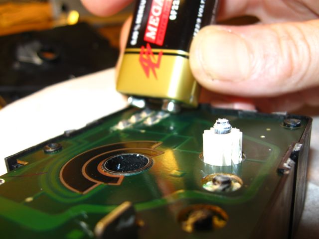

All seemed to be well as far as I could tell (no broken gears, motor turning freely and quietly in both directions) so I reassembled the three gears (moving from left to right: yellow first, then green and finally white) with a little bit of fresh white lithium grease, installed the motor and put the circuit board back in the case. At this point you can again apply the 9V battery to the two solder pads at the edge of the circuit board to test the operation of the motor and gears together:
Testing the motor plus gears in the partially reassembled motor damper.
On my damper, with a 9V battery, it takes ~3 seconds for the final gear to make a complete rotation. I'm sure this time would be shorter with the full ~13V supply in the car.
Then put the center wheel back in the hole, aligning the clocking marks so that the gear is in the same position as when you removed it from the car (this avoids the time and trouble of having to initialize and re-teach the ECC unit how to control the damper motor):
Center wheel reinstalled, aligned to marks made before removal
