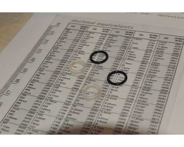

Replaced cooling radiator, re-attached upper and lower hoses using o-rings and (weak) spring retainer clamps that came with the new radiator.
Top hose connection leaked oil after re-assembly.
Re-ordered clamps and o-rings from FCP Groton. Spring clamps were much stronger. Also included small screw-tightened hose (radiator) clamps which tightened over spring clamps.
Top hose connection leaked oil after a couple days.
Ordered o-rings only from Volvo dealer and this time received o-rings and a pair of silicone sleeve rings.
My question is: in what order do these insert on the hose end before inserting in the oil coolant radiator.
See attached photo.
Oil Cooler Hose Connecting O-rings

The o-ring is #27 and the sealing ring (clear) is #28. The #28 basically goes at the base of the hose fitting. Also make sure the clamp is in the correct orientation, the thicker, fluted side goes towards the radiator.

With the nipple on the hose as a reference, the spacer slides on first and then the O ring. The O ring is the first thing into the radiator.

Lee, thanks for the quick reply. I just (also) received this from erikv11, with a great diagram: http://www.autopartsapi.com/eEuroparts. ... ed139e.gif.
