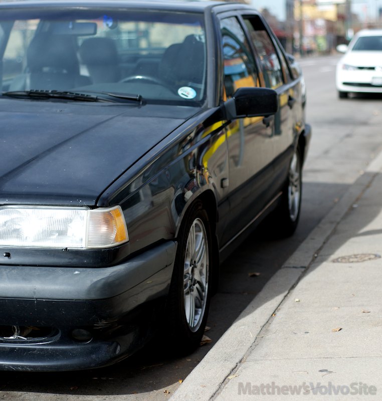

Post by matthew1 »
There they are. Need a cleaning, I know.
Also -> Amazon link
