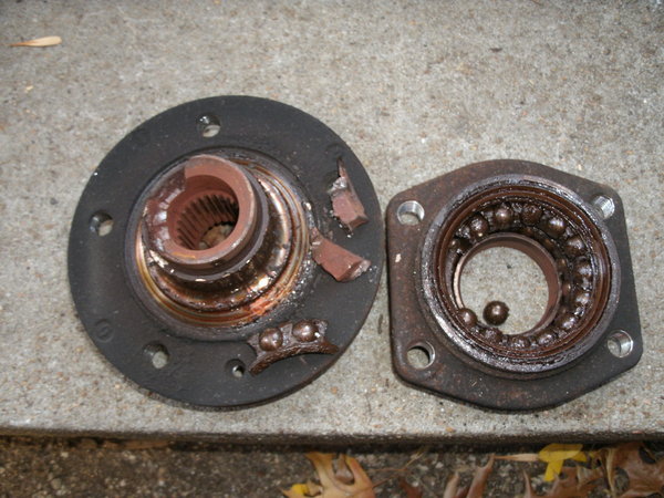

You always know you are in trouble when your daughter comes home from school and says, "Daddy". She either needs money or her car is broken. She said it sounded like her tire was rubbing on the front left. I jacked it up and there was enough slop in the hub that the rotor was rubbing up against caliper bracket.

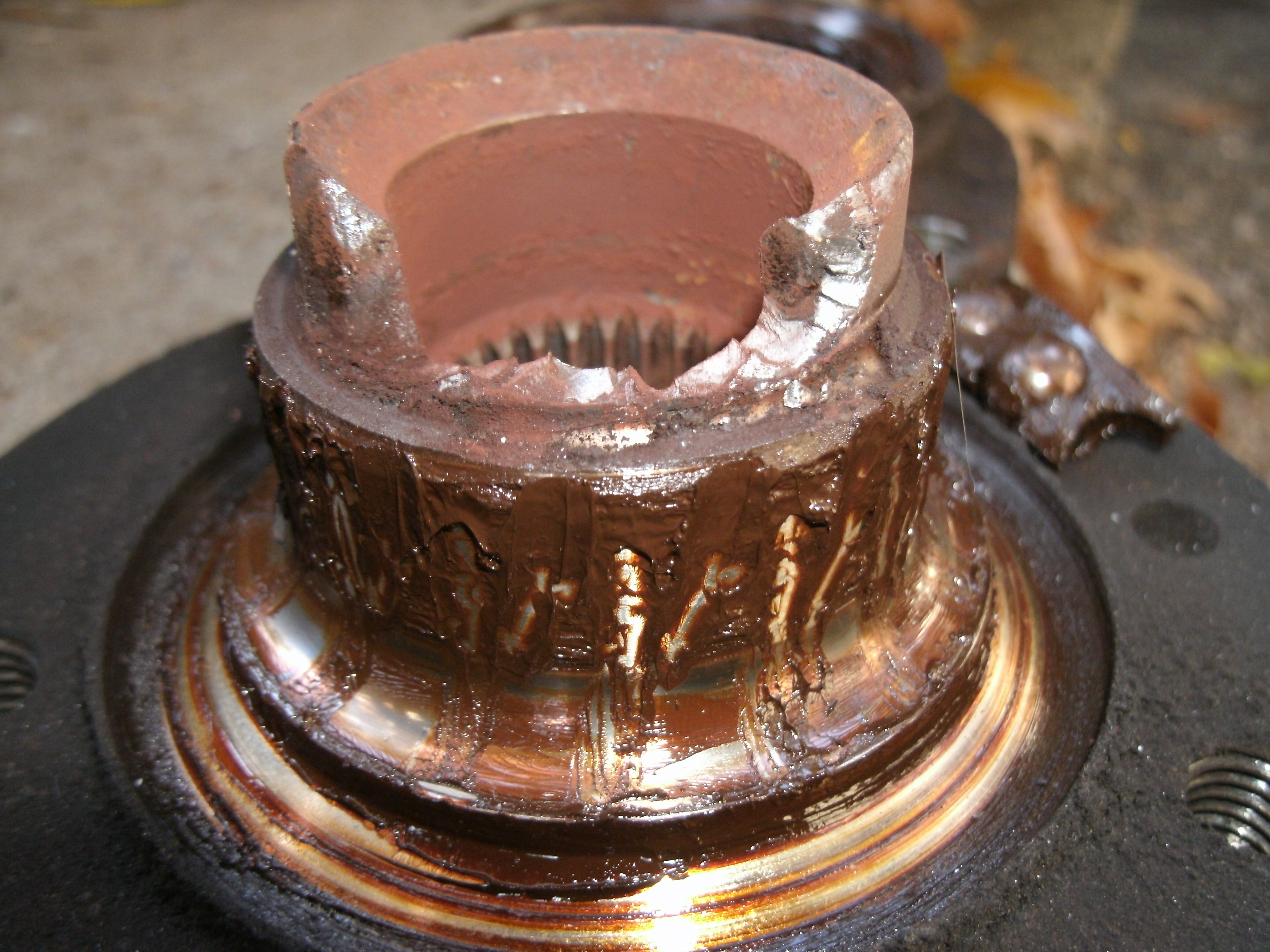

I've seen some bad hubs but this one took the cake, it came out in two pieces:
Her strut was also shot as was the spring seat so I replaced the strut with a decent used one and put on a new spring seat.
The '98 S70 T5 is a happy camper now.

Nasty!! I've never seen anything like that either. Any ideas on what would cause it?

My bad hub came apart like that as well. I believe mine was from having tires rotated and 2 loose lug nuts causing the tire to wobble around.

That's not grease in that hub; that's mud!! Must have seen afew Winters!!

That is a very good question. The cars shows around 144k on the clock but I noticed that there was the typical yellow junk yard lettering on the strut and it is my guess that the entire left front suspension came out of a wrecked car. The car shows obvious signs of front end damage that had been repaired by non professional body shop guys, likely all with junk yard body panels and other mechanical parts as necessary.
