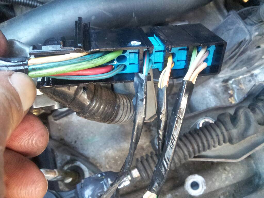

Didn't know there were 2 sensors. Only swapped the one up on top of the trans behind PNP right up close to the firewall. Where's the other located?
OK just had a look at the old gearbox and I can see the second one. The penny is now dropping....

It looks easier to cut and solder the 2nd one in because it's wired into the PNP connector, though this would give me a chance to swap the entire assembly out and clean the original PNP out (which has 160k miles)
The PNP in the car now only has 65k miles so I could leave it for a while if I solder.

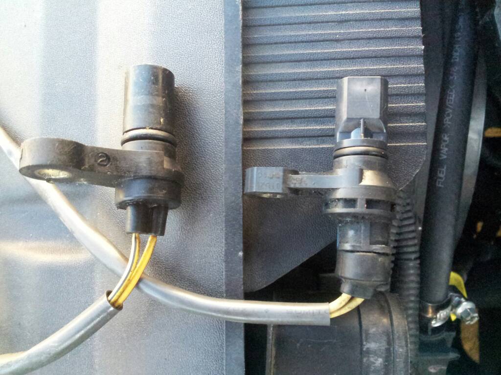

There's the correct speed sensor on the right for a '99 V70 and on the left the 850 speed sensor. The PNP connector splits into 4 sections so each switch can be wired in independantly. That speed sensor has the yellow wires.
I cleared the P1027 code and took her for a spin. No more codes!!
Thanks so much jimmy. I wouldn't have thought of another speed sensor without your input.
