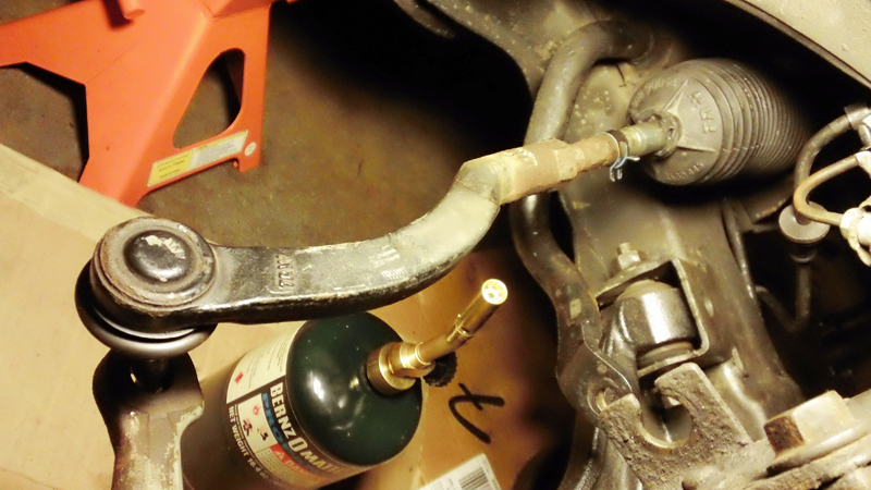

It is an odd set up, but I have used every instruction there is in past 48 hours to unscrew the outer tie rod, except heating it. Troubleshooting with heat needs some hints before I light the torch.
Is this something should I ask the neighborhood shop to loosen for a fee after I replace ALL other parts in my front suspension project? And before any alignment.
It is starting to feel extremely difficult.

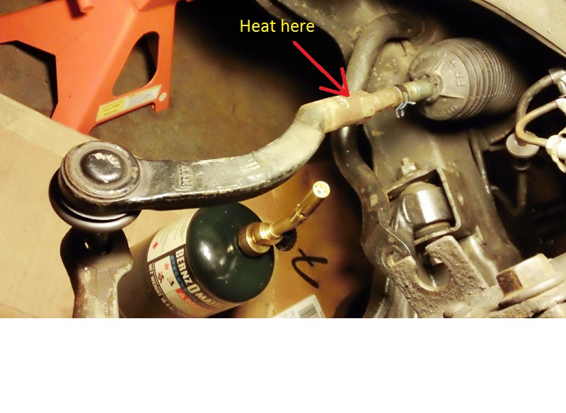

Post by cn90 »
When dealing with stubborn nuts/bolts, always heat the item with larger diameter to expand it.
In this case, heat at the red arrow for a good 1 min.
It will come off nicely.
Make sure you use a wrench on the inner tierod as counter-hold when undoing the lock nut.

There is a post, call it method A, where it say to turn the outer tie rod counter-clockwise while counter-holding the 22mm nut to remove it.
Another post suggests, call it B, to FIRST separate the 22mm nut with a half turn clockwise while counter holding the inner-tie-rod, then turn the outer-tie-rod counter-clockwise to begin removing it.
I am starting with removing the outer-tie-rod, hence after it is heated, would method A have better chance?
Using two VISE-GRIP, it is tearing the skin over the metal.
