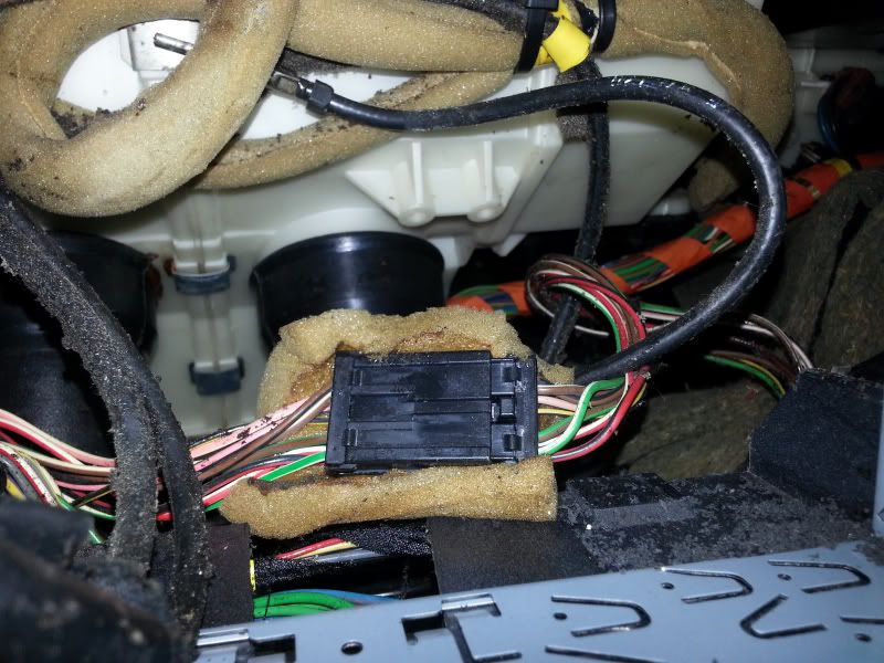

It's identical to the one that only has one wire, but it will have'em all.
It's plugged into the amp output connector from the optional amp harness.
You'll find it wrapped in foam back in the dash cavity.

Found it right away, unplugged ( was a bit hessitant because of the wire colors) plugged the adaptor and Voila.. music!!!!
