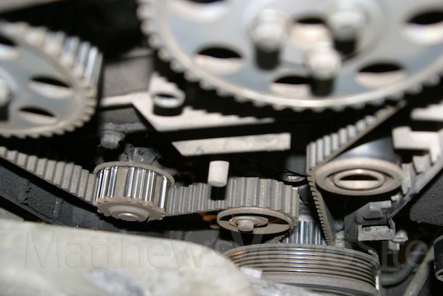

These timing belt replacement procedure photos were sent in by MVS user Carl after he replaced the belt on his 1998 Volvo V70 R.
If you have questions about timing belt replacement, please ask in one of the "major" timing belt replacement topics. This TB photo topic was added to that list.
If you have a question specifically about something you find in these photos, please ask in this topic (click the Reply button). I don't know if Carl will answer -- I don't know if he has a MVS Volvo forum account.

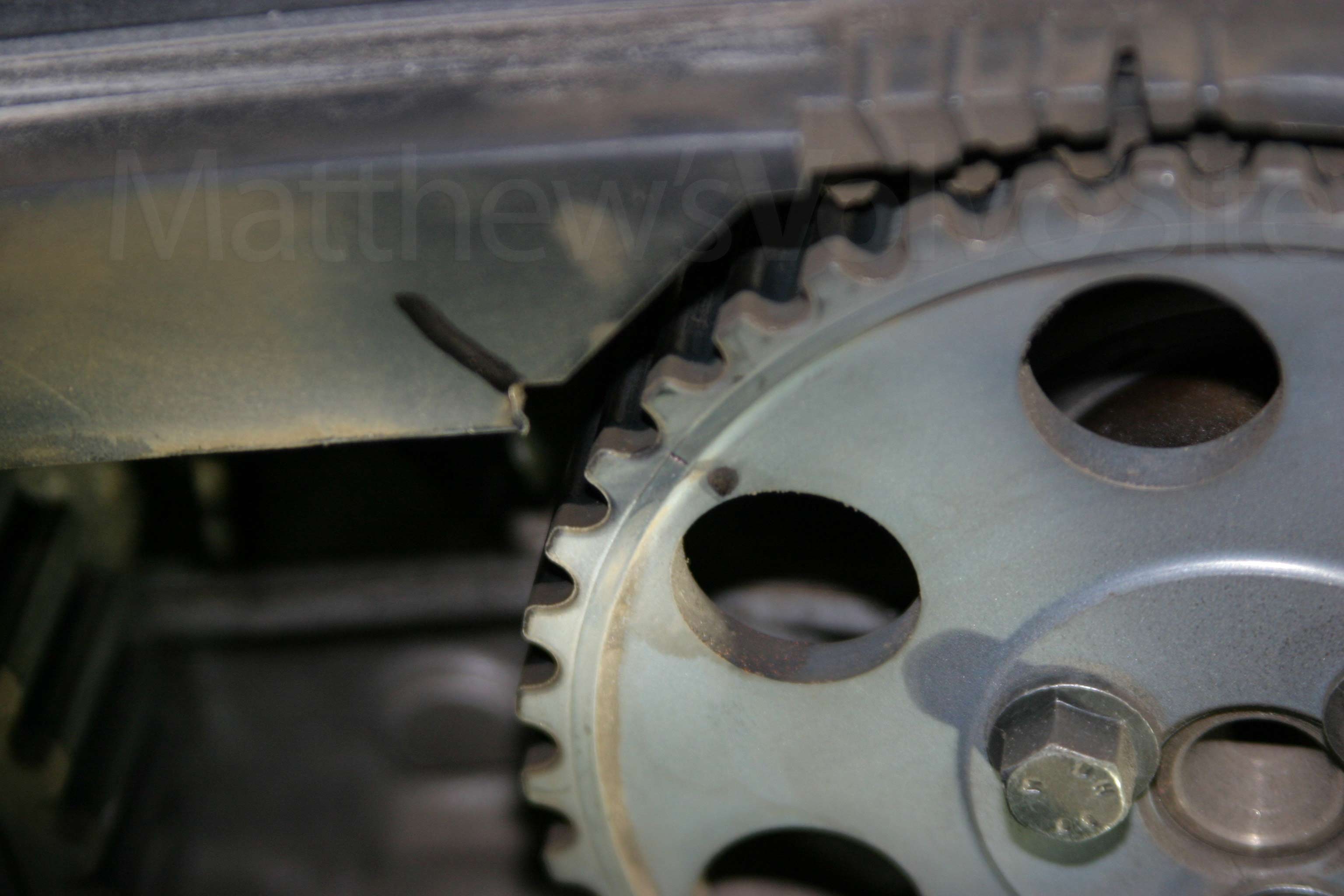

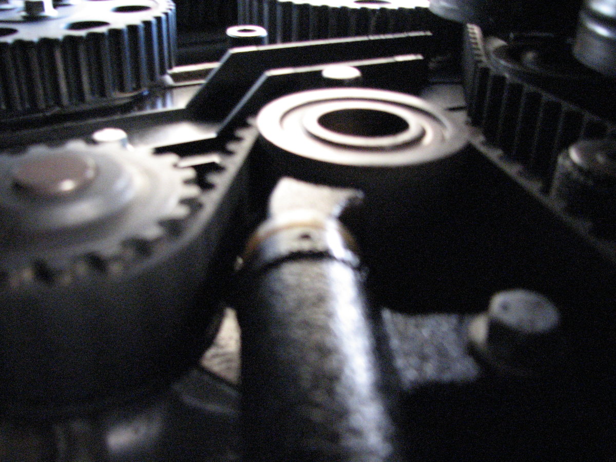

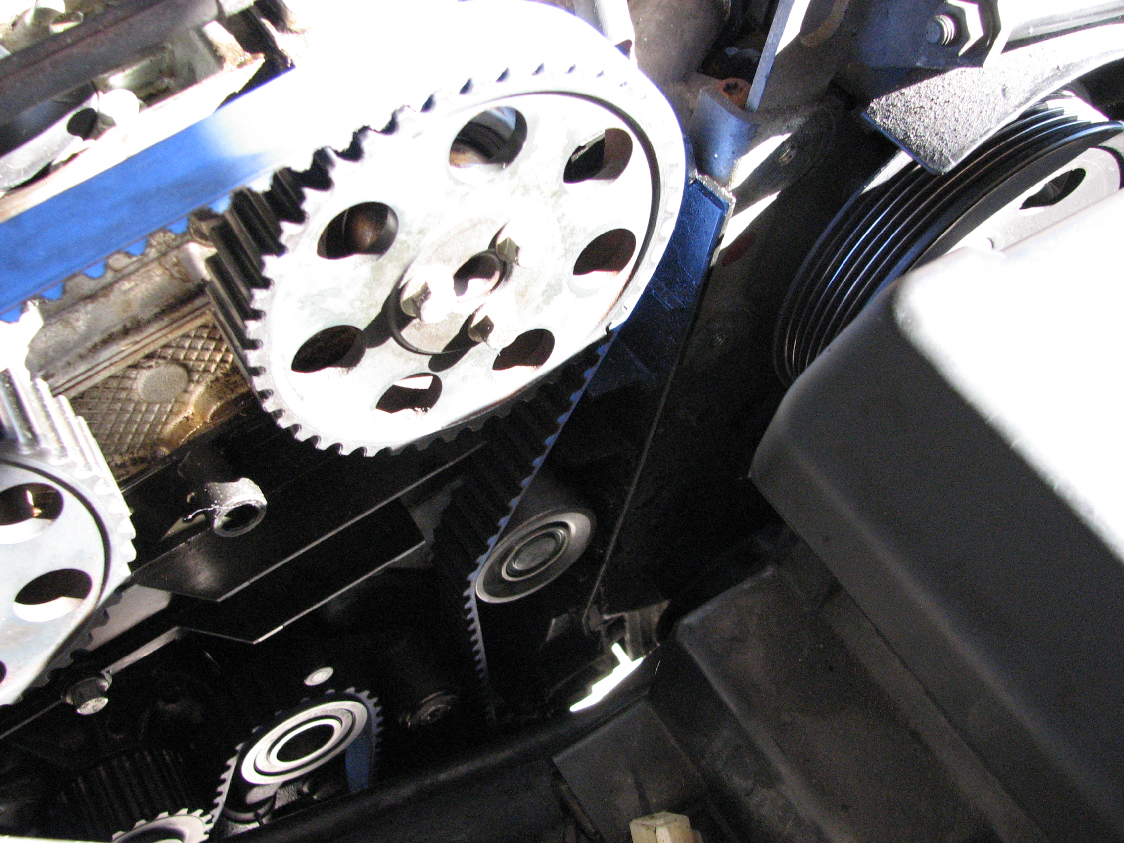

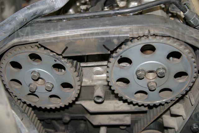

Timing Belt Both Cam Marks Alignment, click image for very large version.
Timing Belt Cam Locking Tool, click image for very large version.

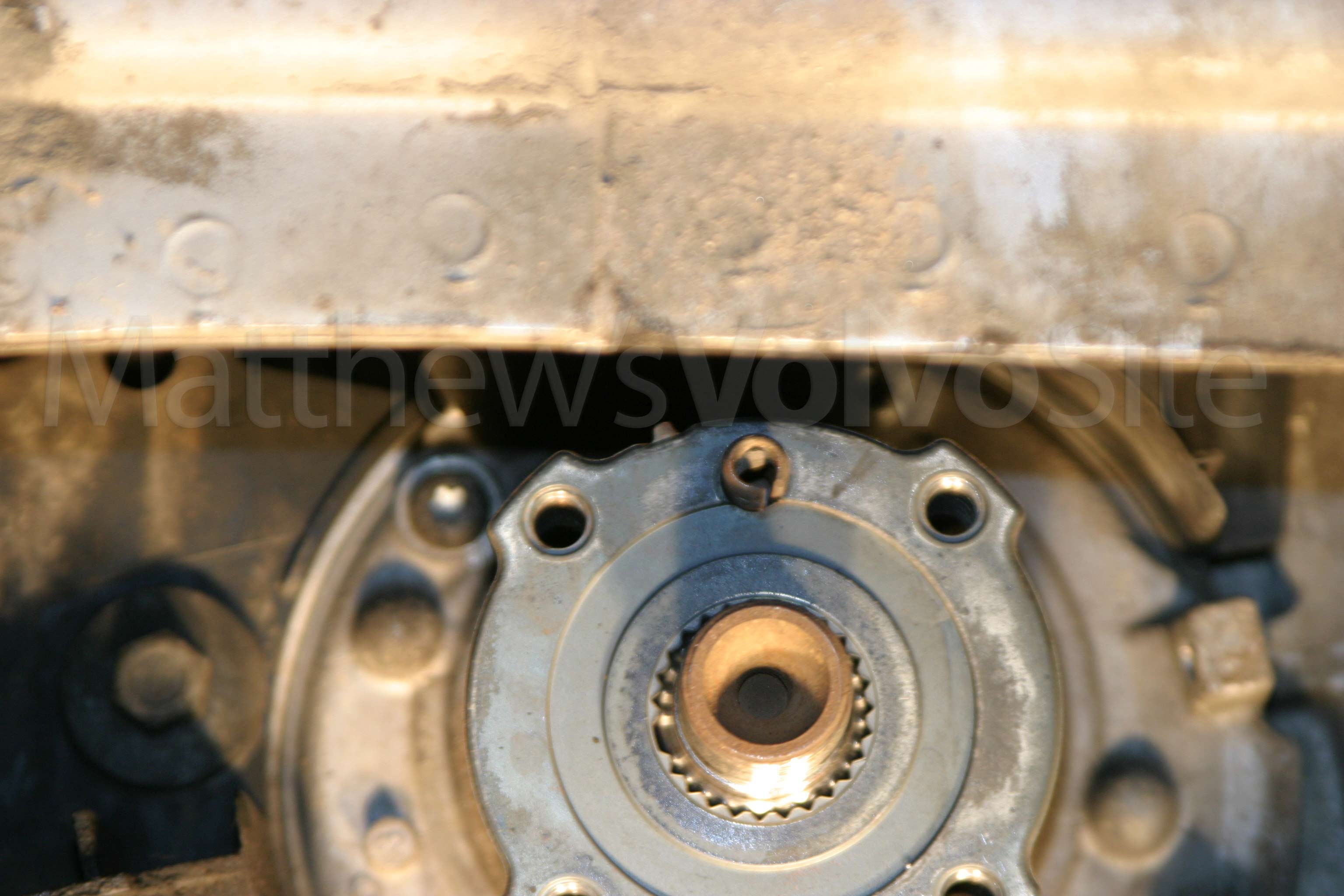

Timing Belt Crank Pulley View Below, click image for very large version.
"Duh"
Timing Belt Engine And Crank Marks, click image for very large version.
Timing Belt Mark On Crank, click image for very large version.
Timing Belt Partial Disassembly, click image for very large version.
Timing Belt Pre Work View, click image for very large version.
Timing Belt Score Mark On Exhaust Cam, click image for very large version.
Timing Belt Score Mark On Intake Cam, click image for very large version.
Timing Belt Unmarked Mark On Crank, click image for very large version.
Timing Belt View Wheel Skirt Up, click image for very large version.
Timing Belt Cam Marks, click image for very large version.
Timing Belt Artistic Shot, click image for very large version.

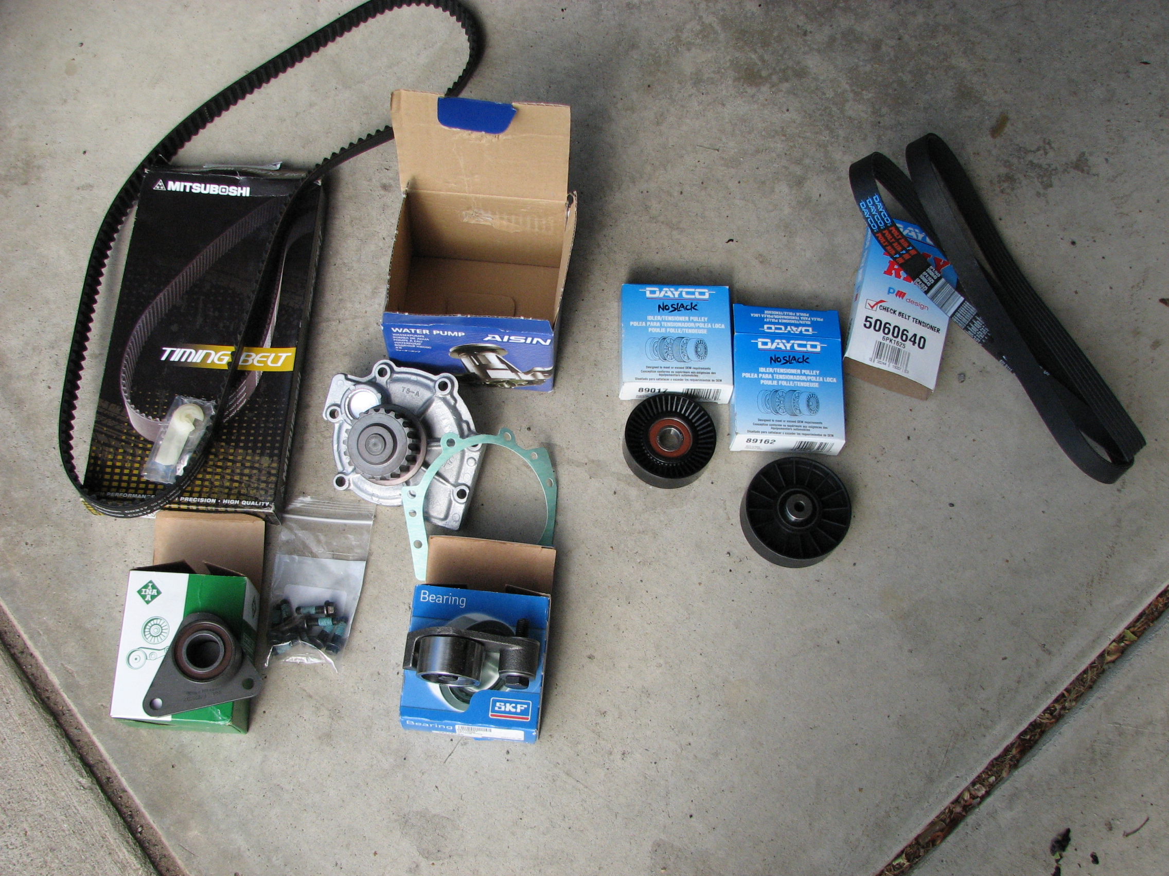

Yup, I am a participant in the Forums and can try to answer specific questions. Some basic comments about this job: it is tight space and you will get your hands banged up; you need to pay attention and be consistent in steps and stay calm, especially when replacing the timing belt onto the cams; you should find out what your independent shop wants for this work, including changing out the water pump, as this is simple for an experienced wrench twister, but not otherwise! On that issue, several commented that they didn't want to change the water pump out, as "it ain't broke, leave it alone" and "fear of leakage". This water pump is a full-proof installation, pegs into location precisely and the torque settings on the bolts are pretty light, so my only advise would be to use a real torque wrench, and set them all proper. I would never take on the trouble of this job without changing all the pulleys, tensioner and water pump. I did attach the water pump gasket to the pump with gasket seal, then a very light coat on the outside gasket surface. Insures the gasket is in proper place, but I think the gasket can be placed on the locating pins on the engine itself to stay in place, and not need to use any sealant whatsoever, though I am not sure what, if anything the Volvo official manual says on this. I am glad I got the job done. And though not a "professional'" mechanic, I am very experienced: maybe a total of 4-5 hours time invested, with a full lift, working from above and below, but with no extra hands to help.

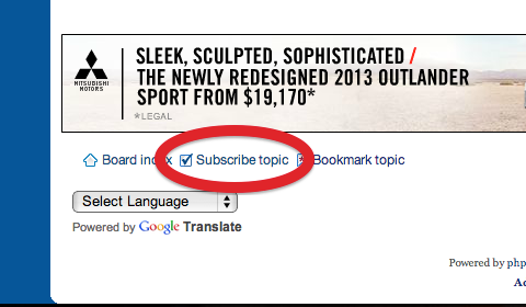

You can get an email notice if anyone posts in this topic by clicking "Subscribe topic" which is in the lower left of the page. You must be logged in.

I have all the parts for the next TB job ready to go (WP, TB, Hydraulic Tensioner, rollers x2, all Volvo OEM parts).

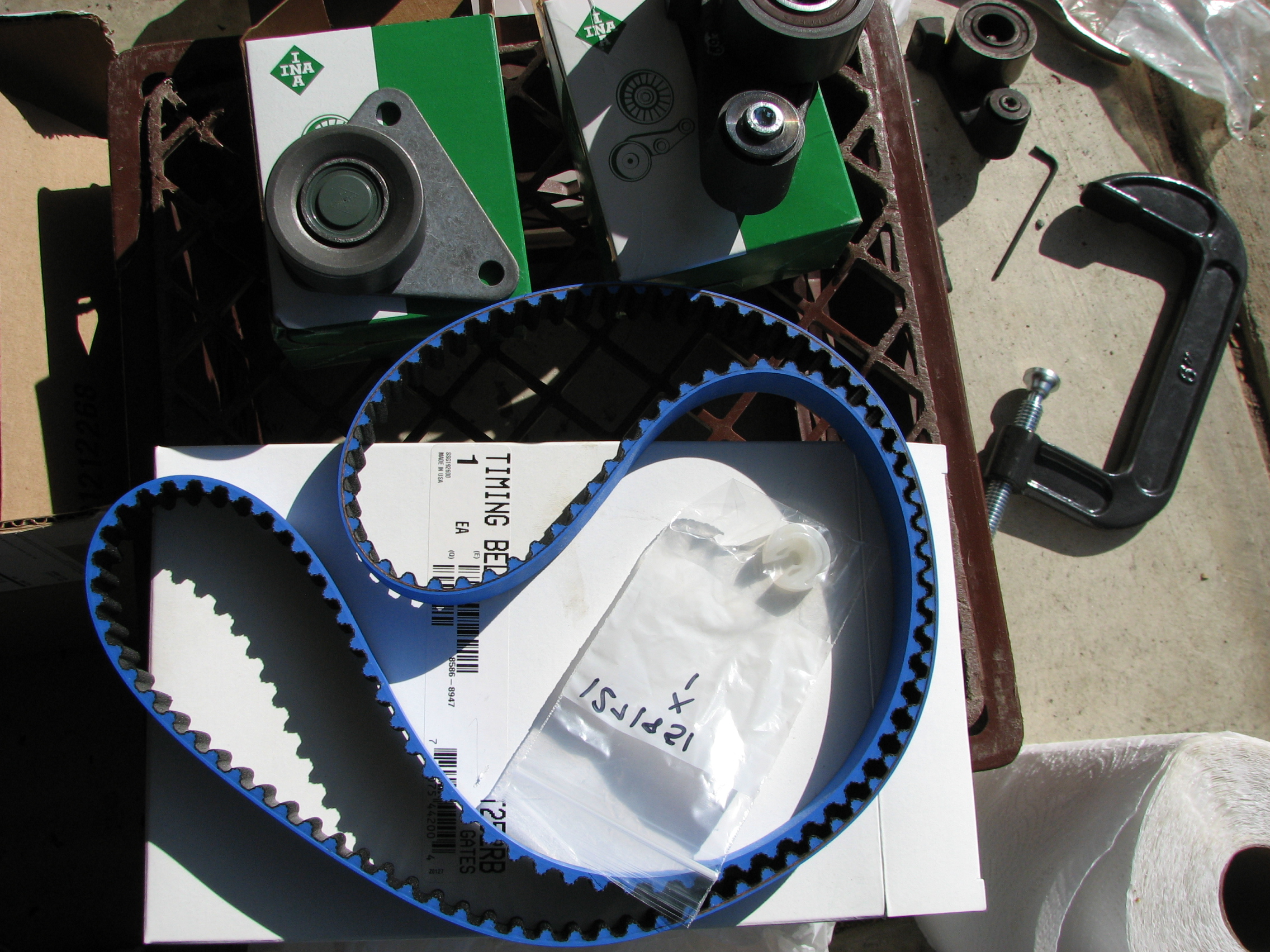

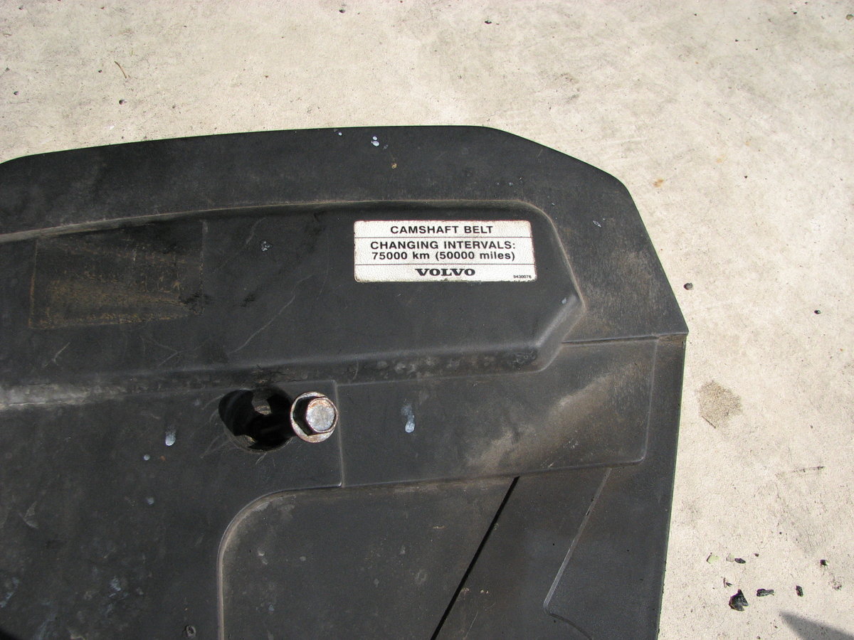

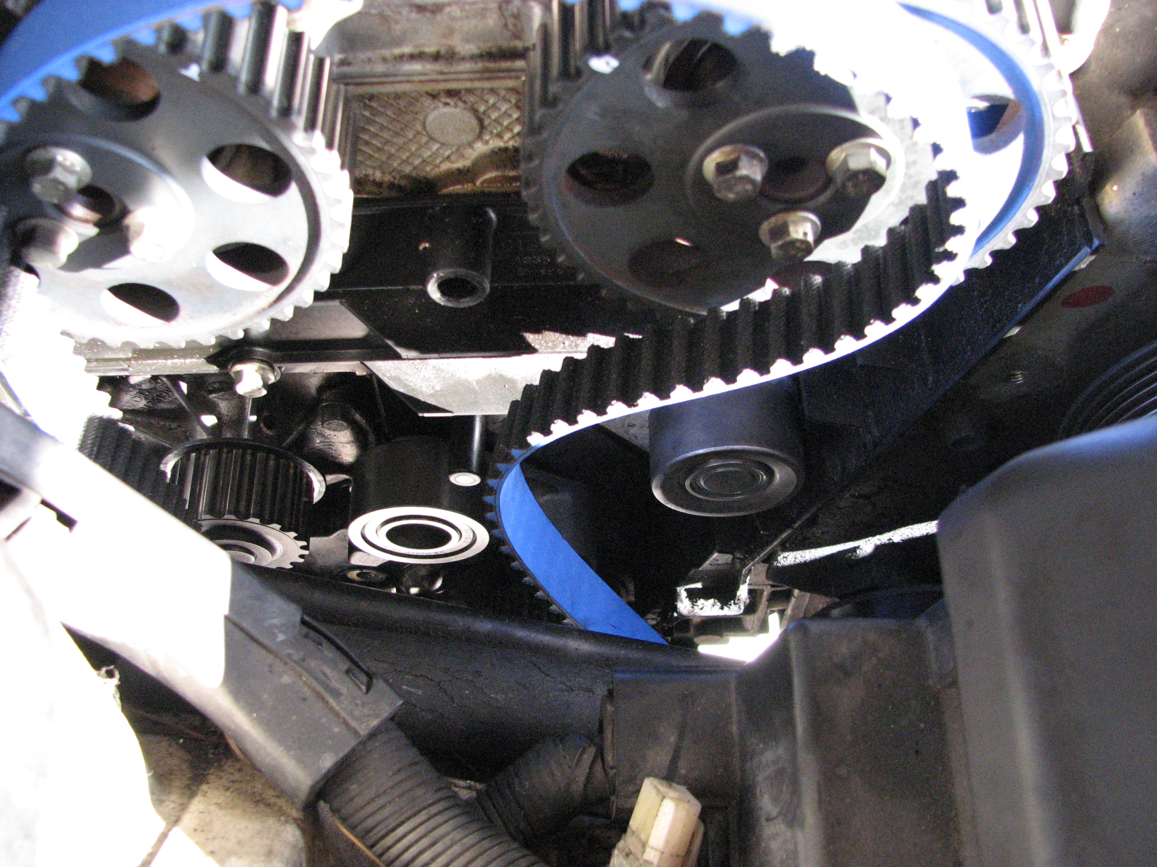

I had purchased everything to do a '93 850 timig belt with all OEM. The timing belt cover only had the original 50,000 mi. recommendation sticker, so I imagined it was still the small 21mm, 143 tooth belt size.
Upon removing the timing cover I had discovered the belt and pulleys had been upgraded to the 23mm, 148 tooth belt system.
I returned everything, and decided to get artistic. I went with a blue one with INA pulleys.
So there it is. This thread was about photos. I had taken a few. But remember to inspect your present belt before buying parts.
Any parts for that matter.
Have fun.
