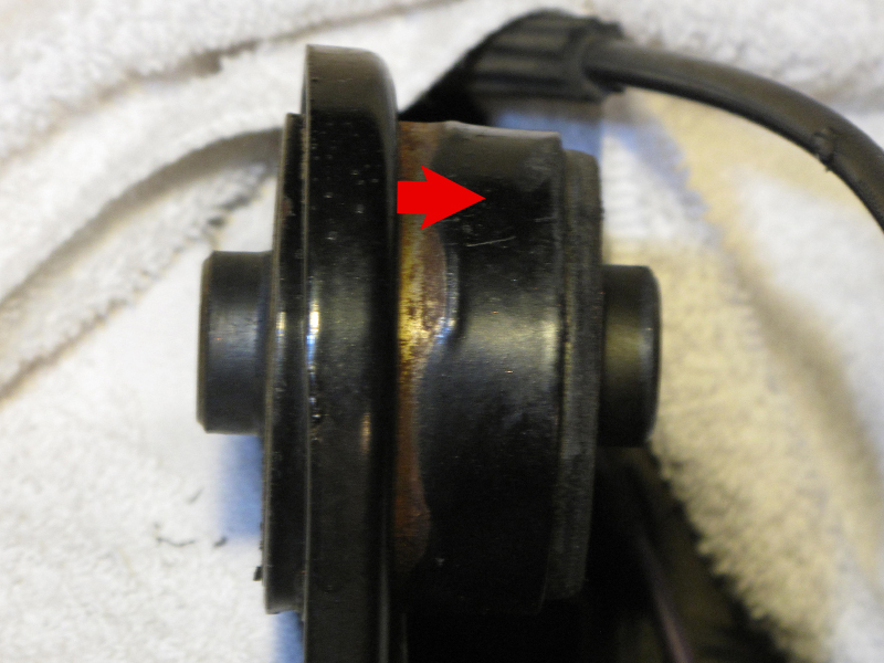

This was the hardest job this past Spring using Volvo part.
I am posting a photo below, it shows the mount holding the busing slipped out of mount bracket a 1/4 inch during pressing it from passenger to driver side, an opposite direction to what cn90 recommends. I was then able to push/pull it back, restored close to its original setting. But NOT SURE if it is firmly in place, does it need welded to the bracket for it to last?
