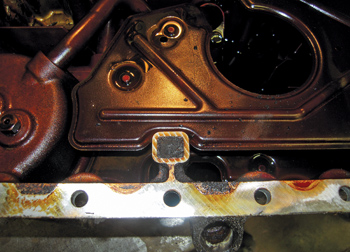

11. Once the oil pan was off, we could see just how badly the return passage was plugged in the block (see Photo 11) and how badly the oil pan was plugged (see Photo 12).
12. Be sure to clean the oil passage in the pan from top to bottom before getting the oil pan ready for reinstallation.
13. Photo 13 shows the oil pan clean and ready for reinstallation. Be sure to replace the
O-rings for the oil pipe in the oil pan. They can get hard and crack and cause a loss of oil pressure.
Volvo’s oil pan seal kit P/N 30750783 includes all the seals needed to do the job. The only parts that don’t come with seal kit are for the oil cooler (see Photo 14).

Yeah, it is recommended all the time to clean that passage, but I don't think I would ever drop the pan just to check. Drop the pan to clean sure, but you can check it from above during a PCV job.
I've pulled four oil pans in the last 3 years. Mileage was 100k, 152k, 172k and 196k. All had clean passages to the PCV, even the 100k junkyard engine that had clearly been neglected for oil changes and had a lot of sludge under the oil pan. All also had clean PCV systems though, so it doesn't really tell us much.
In that picture 13 up above, there is WAY too much pink goop on the oil pan sealing surface.
