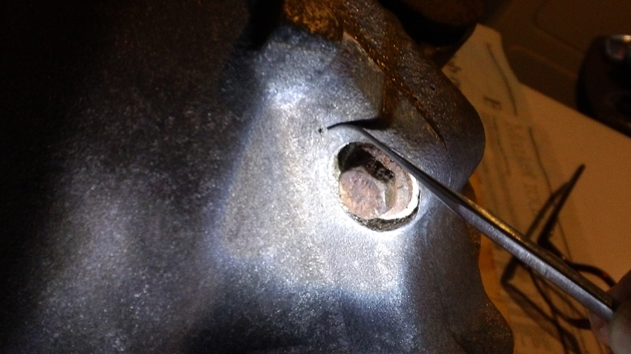

1 - need to pull out axle from fd, what is that clip with bolt on drivers side?
2 - need to separate prop shaft at VC, is it under PB Blaster.

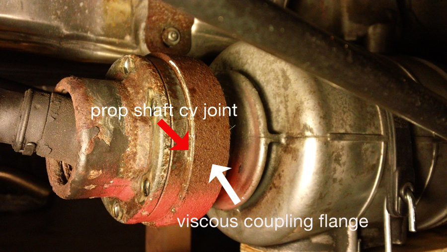

prop shaft cv joint seam at red arrow, and vc flange at white arrow. the six screws holding it together is removed. But it is weather tight, so i gently ground of the rust, now looking for input on ways to separate the two.
It is on PB Blaster for past 24 hours.
separation anxiety
separation anxiety

Pull the shaft to the front of the car the the flange will be sat inside the rear axle part, there is a lip of about 1MM which stops it falling out when assembling but makes it fun taking it out - The only time I have done this job I had the front coupling released, rear coupling realeased and center bearning released, at this point pull the shaft to the front of the car and it should come away from the rear axle - Mike

If you say that the cv joint at the red arrow goes in about 1mm into the VC flange, then could I use a dull soft metal chisel like object against the VC flange to hammer it away toward the back of the car, since i have the FD lowered and free?
Would some propane heat at the white arrow help?

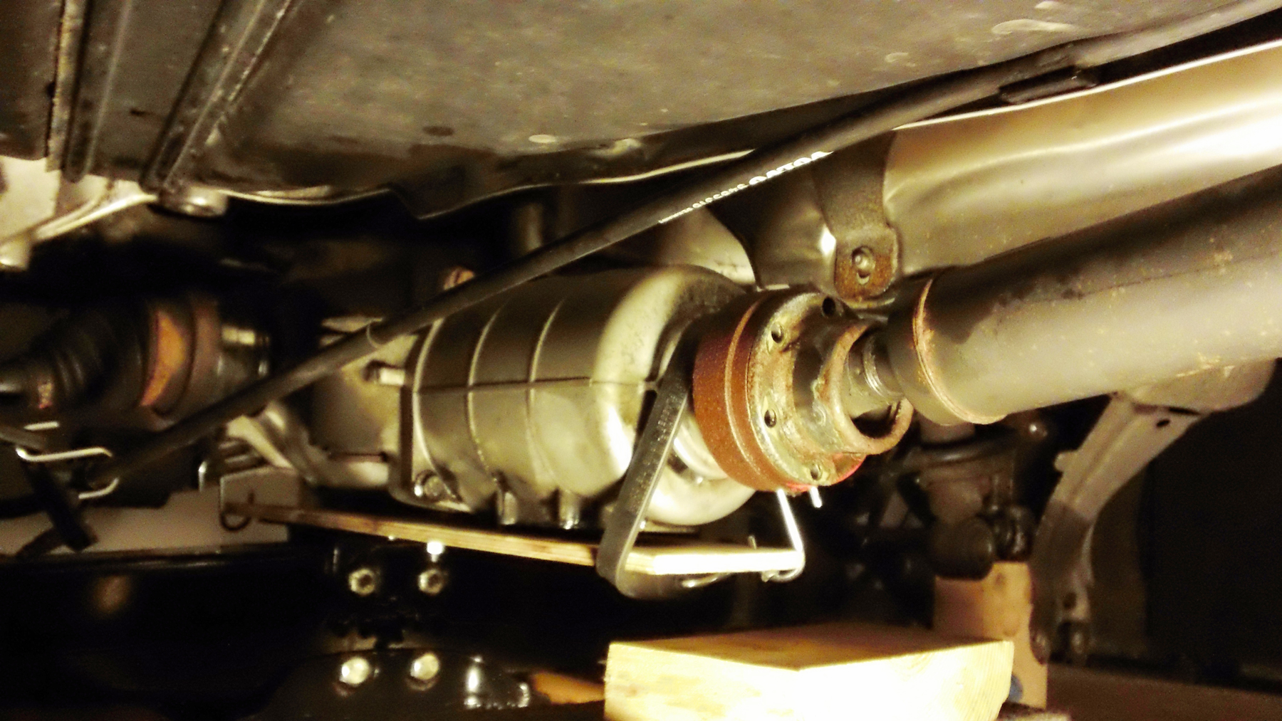

Here is another photo FD/VC on a cart to roll out from the underneath at the rear of the car.

Usually just rusted in. Some releasing oil and use of bolts in the threaded holes (not the ones for the 6 bolts you just took out) in the back of the flange will get it out. I do not heat them but know folks who do.
On the Haldex models I can never get the joint out unless the shaft has been removed from the front bevel gear as well.

Disconnect the prop at the front end and rear then remove the two bolts holding the center bearing to the tunnel cross member, remove the four bolts holding the tunnel cross member and lower the center part of the prop shaft to the floor, the fwd end should release from the transfer box coupling by exerting a little pressure to the shaft in the rearward direction, the rear end of the prop should come away by exerting a little pressure in the forward direction to the prop shaft, it shouldn't need heat or hitting to seperate from the vehicle.
If you want to drive the car in two wheel drive make sure you replace the tunnel cross member that the prop center bearing carrier was bolted to but you can expect a bit more wheel spin from the front wheels in the wet if you use the throttle to heavily - Mike

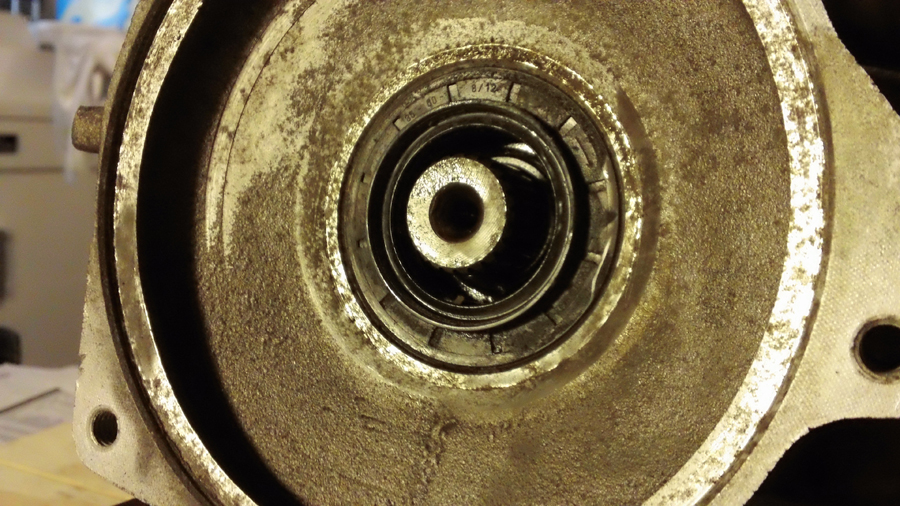

After some rethinking of my situation, left the VC connected to prop shaft.
Removed the three 12mm screws and pulled the FD out from the underneath.
Seal at shaft for VC Coupling
There is a pin hole to help it breath and vent. Has anyone modified it and installed the bleeder vent?
