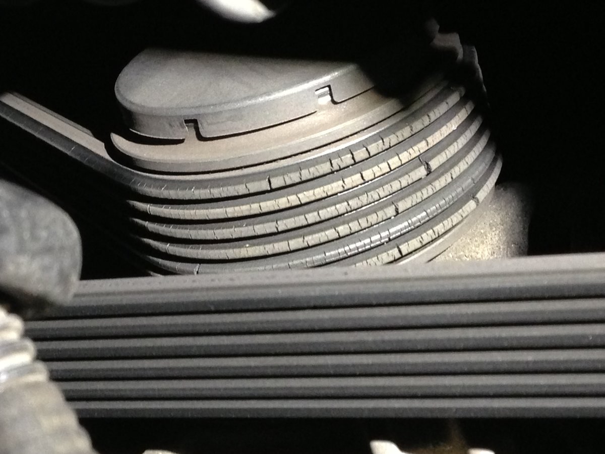

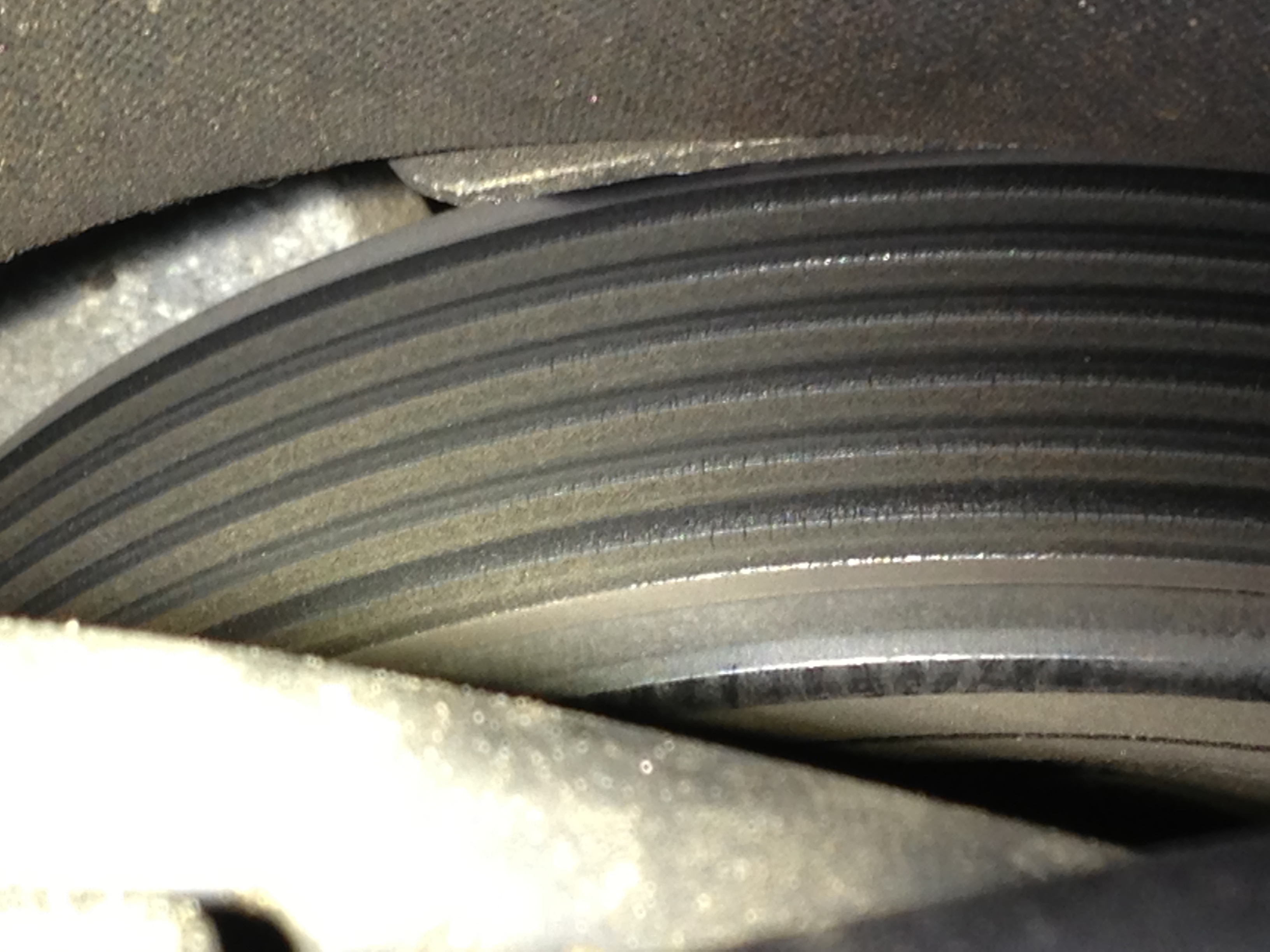

I know it’s crazy to put this much time/effort into a serpentine belt. The reason I’m trying to find a definite answer is because it appears to me there are two distinctly different sides (i.e. inside and outside) of the belt. Yet when I search on MVS and other forums I can’t find any mention of such. I can’t find any mention of such on the link you provided from Continental. However, what I do find in several posts of members changing their serpentine belt is they suddenly have new squeaks/squeals or the belt is jumping. While I understand some parts often wear simultaneously, I suspecting some members problem is because the belt was put on “inside out”.

The picture with the oblivious cracks are of what I believe is the inside or rubbery side of the belt going around the idler pulley. The second picture is of what I believe is the outside of the belt or the more slippery felt like side going around the power steering pump pulley.
While the power steering pump pulley is a good bit larger and wouldn’t expose or cause the cracks to open up as much as on the smaller idler pulley I can only see the faintest cracks beginning on the what I’m calling the outside/slippery felt side of the belt. Again very different wear rates because of what I believe is two different materials used for the inside/outside of the belt.
