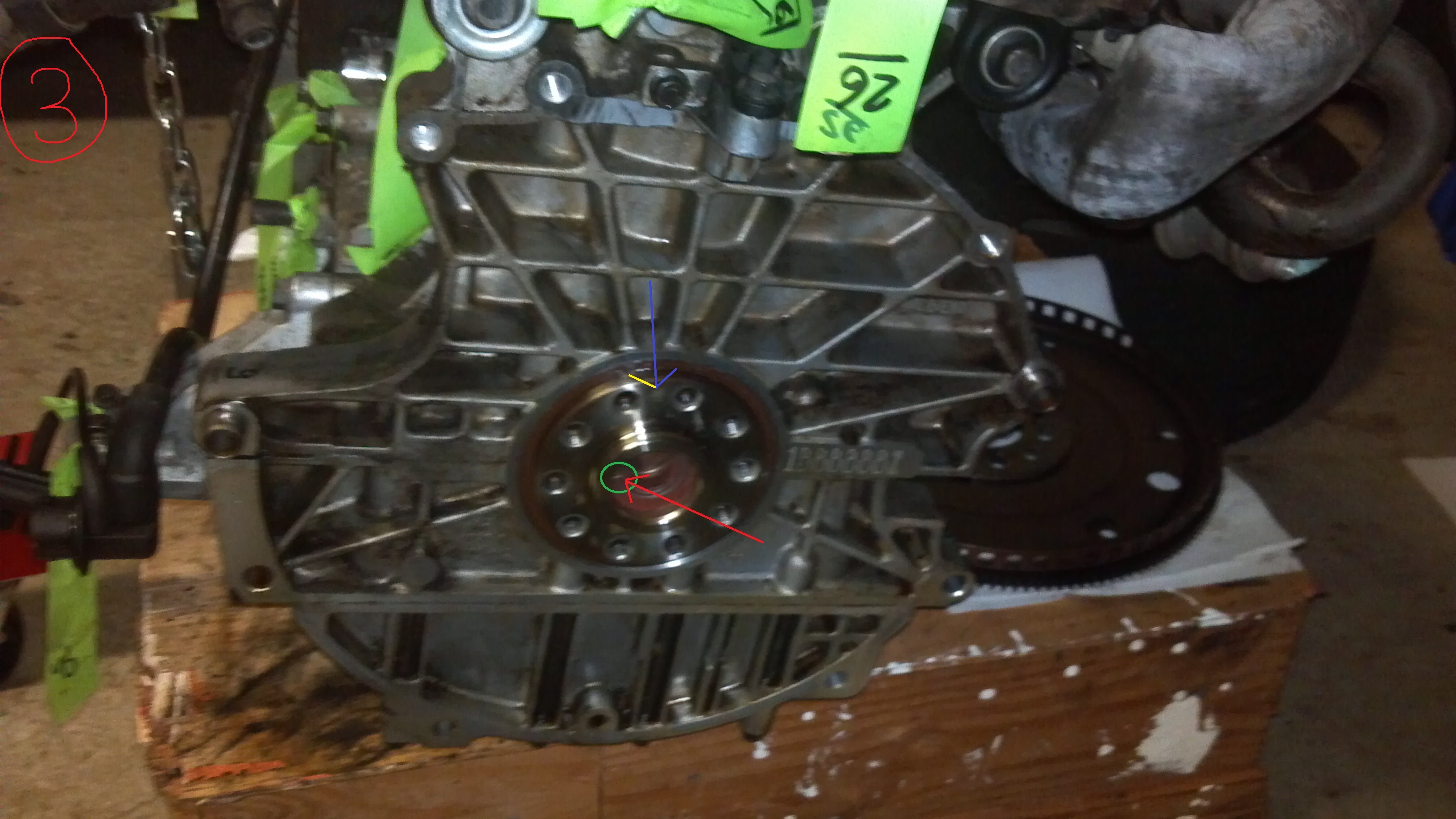

Question 1 (picture 3): to take Rear main seal, if you look closely in the green circle pointed by the red arrow there is a little metal O-ring with a tab, is that the way to take the seal out? or by force?

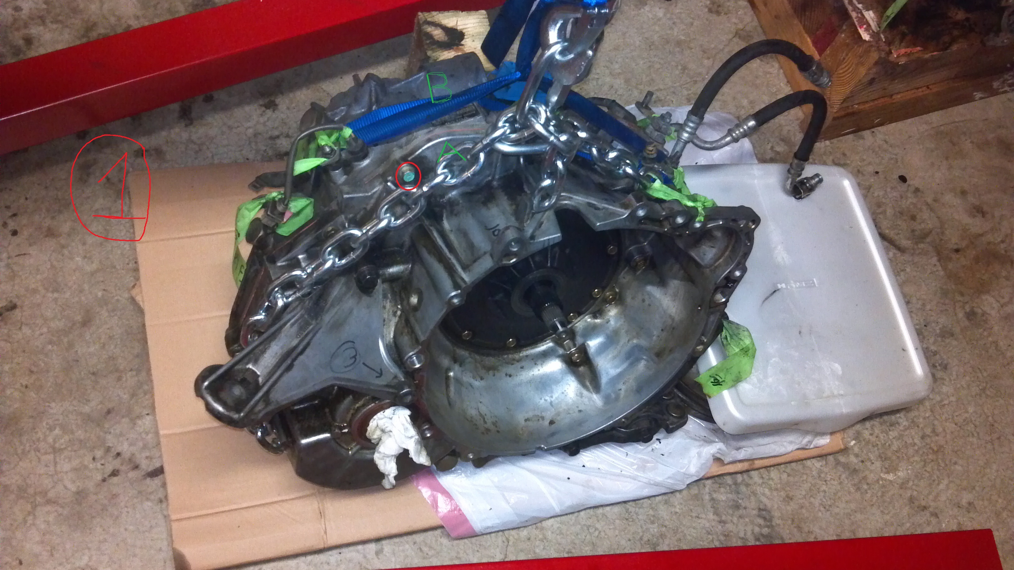

Question 2 (picture 1): While I have the engine/transmission out is there any possible problem parts that you would replace? I was thinking separating part A from B on transmission picture by means of the bolts circles in red and just see inside and look for anything odd.

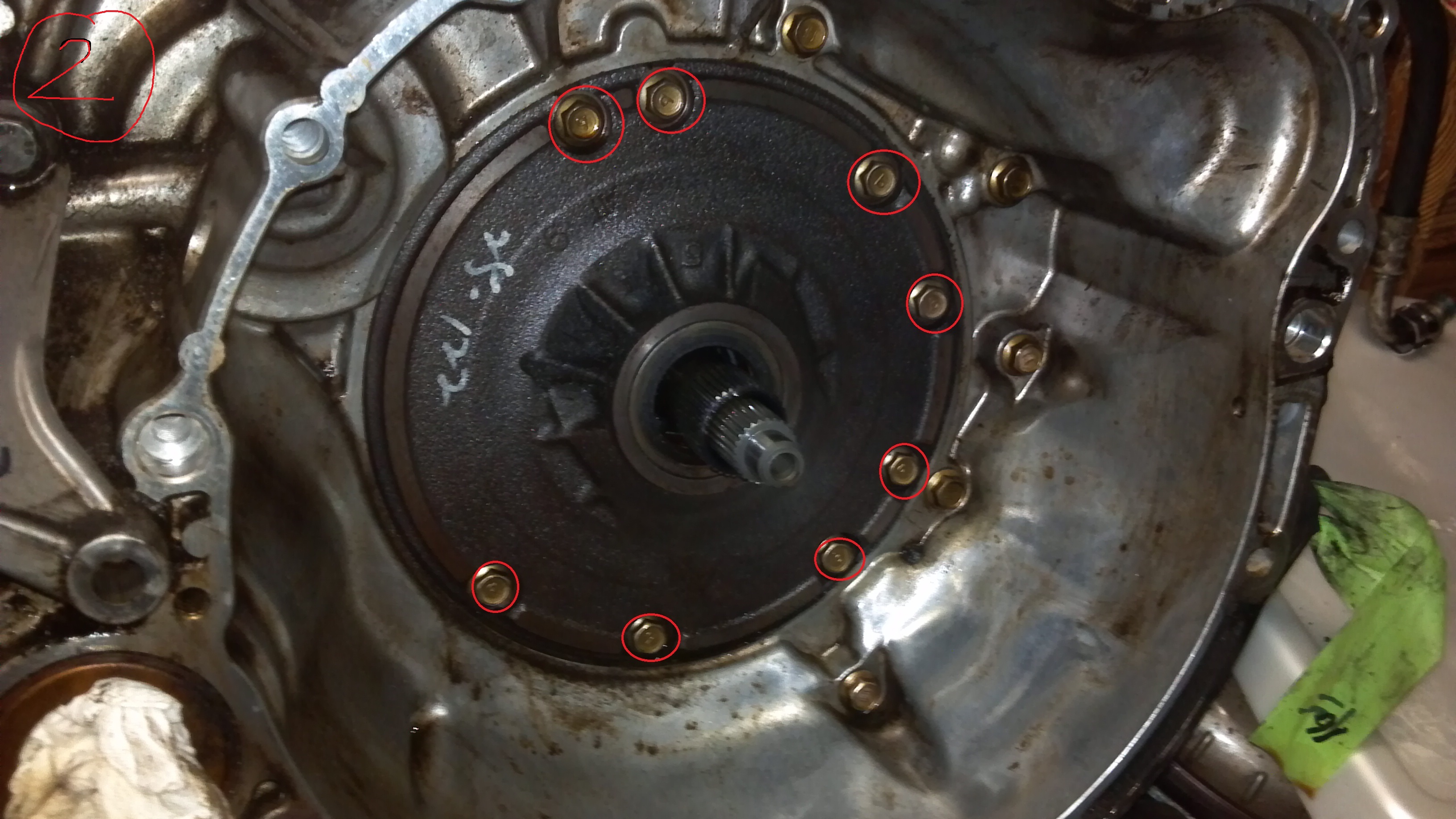

Question 3 (picture 2): If I was to take bolts circled in red would that be a better option to question 2 (picture 1)?

Whatever you do, don't mar the sealing surfaces on the bore and on the crankshaft!!!
Use only Volvo OEM Seals:
- RMS
- Transmission Seals x3 (Input x1, Ouput x2).
To remove seal, use sheet metal screws at 3 and 9 o'clock positions. Be very careful to insert the screw in a straight manner so you don't mar the sealing surfaces.
During install, make sure the garter spring (of the seal) faces the inside of the transmission. Use appropriate socket/adapter. You can use the old seal to serve as cushion to avoid damage to new seal.

There is no reason to open up the trans if it wasn't acting up (e.g. shift solenoids, etc.). No other seals to mess with there.
I gather you also have the engine out, I would consider the following because now these are all much easier to do
- PCV
- timing parts (belt, rollers, tensioner)
- cam seals
- tuneup parts
- vacuum lines
But none of that is necessary. Similarly, how is the steering rack? AC system in good shape?

Scroll down towards the bottom, I mention (with photos) the 3 seals on the transmission to replace:

As far as the RMS, what you are pointing at in #3 is not the RMS. It's the crank. The seal is about 1/4" wide (at most) and fits around the crank. The easiest method is put a small sheet metal screw into it, piercing it, then hook a large pick into the hole and use leverage to pop it off. You MUST be careful to not scratch the surface. If you do, it's better to scratch the OUTSIDE seal portion as it does not rotate, the inside portion is sealing the rotating crank. A scratch on the rotating portion will slowly damage the seal and allow oil through.
