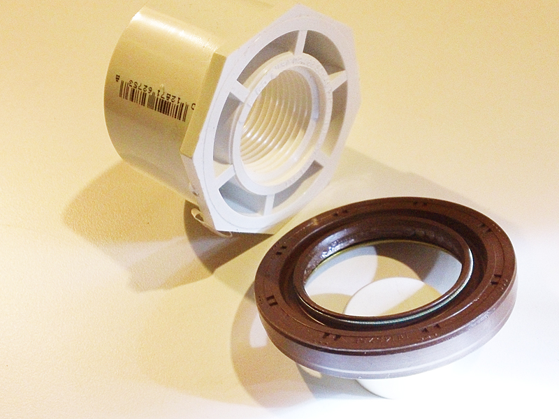

It is passenger side. i replaced the seal on both ends during axle replacement.
Add rubber mallet, lubricate with AFT, and you are good to go.
driveaxle seal - view facing transmission, and PVC coupling to aid the install

Seal puller from HFT www.harborfreight.com/seal-puller-35556.html.
Set the seal by hand first, then tap it in gently and evenly.
Take your time, cn90 says... keep the dust away, keep it covered when away.
