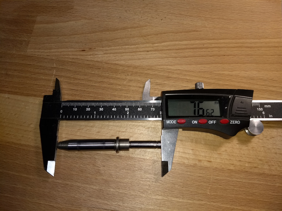

B4 band:
B4 piston has one of 5 pins of different length, with 0.5 mm increment. The correct length is determined upon transmission assembly:
When the B4 band wears 0.1 mm (1/254") the piston has to travel 2*π*0.1 = 0.63 mm more, i.e. it asks for next pin increment.
Most of AW55s has a pin with 1 groove and it's nearly impossible to source a replacement pin. People extend the pin with a welder:
If the washer is here in piston assembly just for the correct gap then it is a much more convenient way to recover piston travel length than welding a pin.

VTL, thanks for that detailed post.
So when you’re extending the pin by welding a new tip (tip vs base, I presume?) on it, do you just roughly reshape it or are you profiling it on a lathe? Basically is the length the most critical part & not the shape of the tip?
Edit, I ask because in the pictures the pin you show looks less than in pristine shape, which lead me to wonder if this is not critical.
TIG I assume, or is the pin not SS?

Post by vtl » Sun Aug 11, 2019 6:16 pm
Weld a bit on top of the tip and roughly reshape. Tip just pushes against the band, no mirror-like surface is required there.
Pin is SS and all I have is a cheap MMA welder :)

Thanks for all that info!! Will read through it more when I get off work. The end of my piston looked abit beaten up, so I guess the band where the pison pishes on is worse. Takes some force to beat up a stainless steel rod :).
Is there any way to know if the piston needs to be longer other then try and see? Diassasemly of the conplete gearbox is abit firther down the line for me!
I will try to sort a piston from a junkyard to experiment with.

Post by vtl » Mon Aug 12, 2019 6:32 am
- Pete - wrote:
Mon Aug 12, 2019 12:27 am
Never run SS electrodes before.
I used Blue Demon E308L-16 X 1/16".
And this was my first welding job done ever. I could not fire it up, gradually moved the knob to 90 Amps and had a 1/8" of the pin evaporated in one stroke :-D
