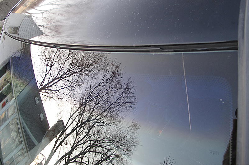

Molding was lost, now the plastic under it is chipping, see photo.
Local volvo shop wants $200.

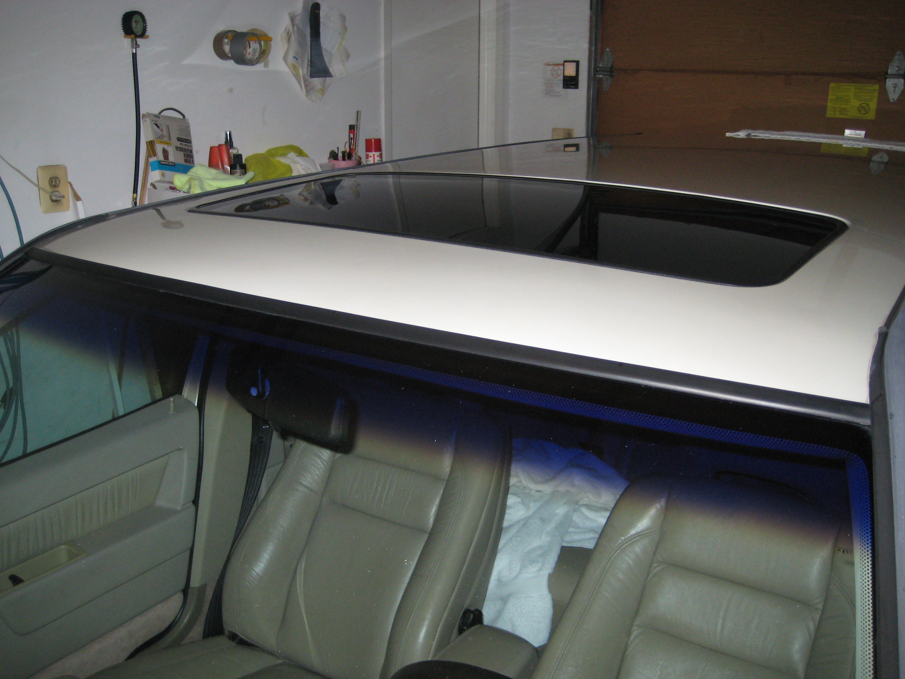

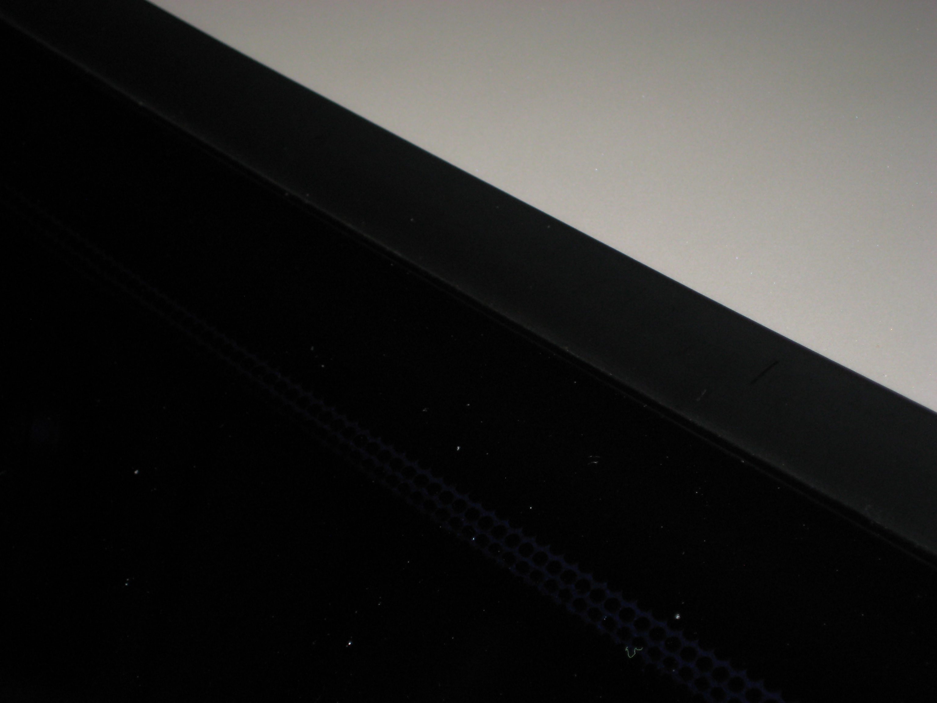

Yes, there is.cn90 wrote:My question is: is there generic stuff...
Last winter the guy from Safelite came to my house replacing my wife's windshield. I asked if he could replace that piece for my wagon. He went back to his truck and cut a piece from a huge spool (must use that a lot). It fits perfectly...
I dont know how much that piece would sale for since I just slid the guy a 20.

Thanks Al,
I called a local auto glass shop today and he told me to come by this afternoon.
Like you said, it comes from a spool....about $2/ft x 5ft = $10 or so.
