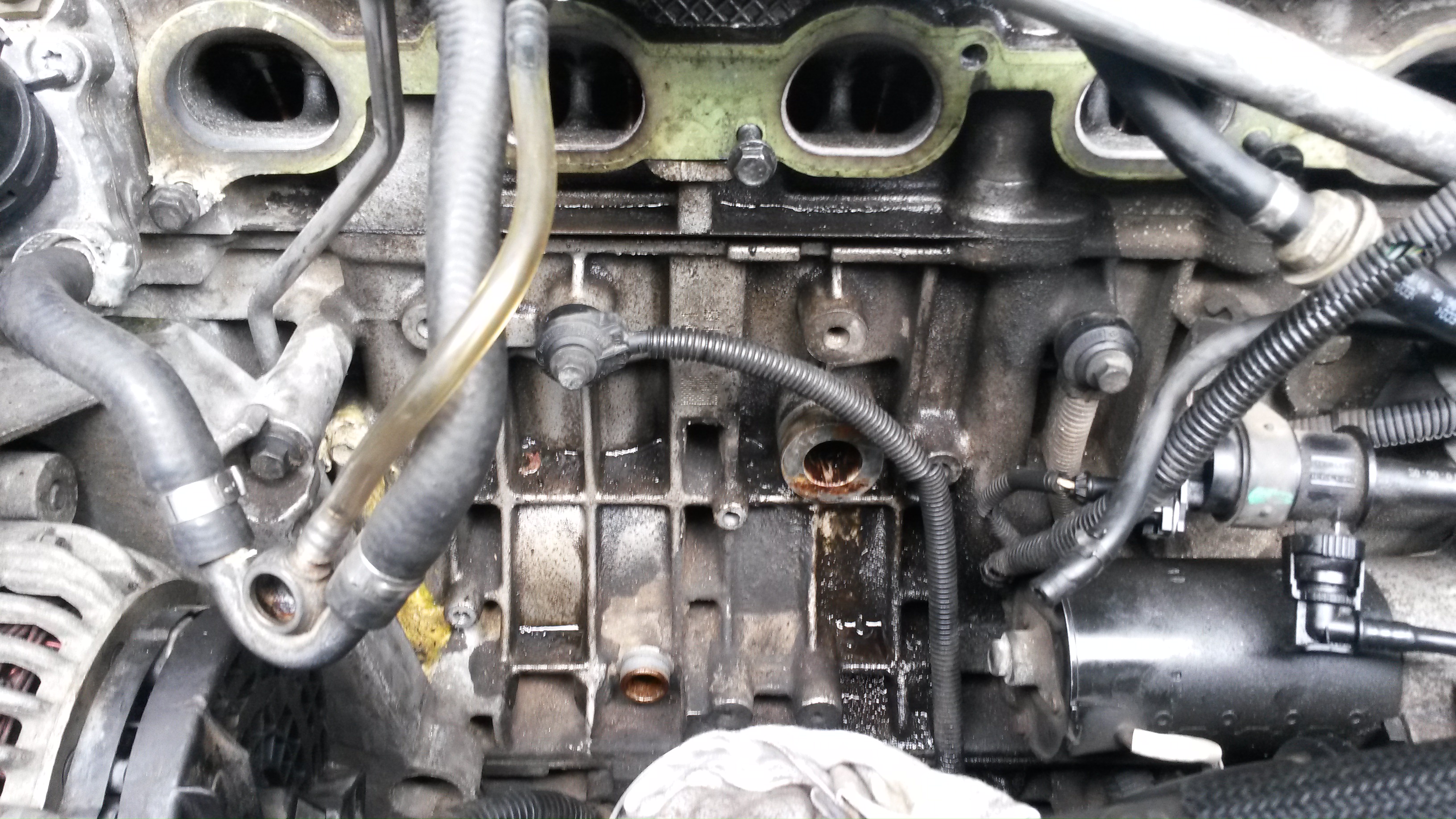

While replacing the timing belt I found that the front exhaust (rear) cam seal is leaking. Anyone seen a good set of instructions or video on replacing the seal. Visually, I cant tell how to safely remove the cam sprocket without possibly losing timing. Any help is greatly appreciated.

As far as the sprocket R&R procedure, that is uncharted territory for me. I'm fairly new to the white block engines and have not yet had to remove any cam sprockets - just read a little bit about it though to understand the spockets aren't keyed to the cam shafts. I've replaced the timing belts on both my wife's 2005 S80 2.5T and my 2003 V70 2.4 NA and to be honest I don't recall if either one had that type of VVT hub arrangement. Neither one had leaky seals so I didn't concern myself with it. I see in your photo where your's is slinging oil. Make sure your PCV system is holding negative pressure in the crankcase. It's a common issue in these cars for the ventilation plumbing to plug up and that can lead to oil being pushed through crank and cam seals.
