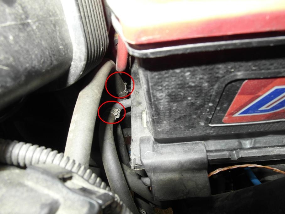

My 1998 S70 GLT has 150K miles, both Upper and Lower Trans Cooler hoses started leaking a few drops on the driveway each day. No big leak, but it is annoying. New O-rings did not help as the factory hose loses the sealing effect at the crimp area.
New Trans Cooler Hoses (PNs 9180542 and 3507931) are about $90/each.
No worry, I will show you how to rebuild the hose for $3/each ($2/foot and the cost of Oetiker clamps)!
Car had ATF change at 70K, so the ATF is overdue (has 80K in it), it was dark/brownish. So I flush the ATF as part of this project.

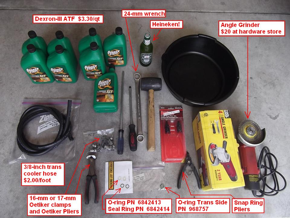

PARTS/TOOLS:
- 3/8-inch trans cooler hose, sold by the foot at Advance Auto Parts in the bulk section at the back of the store. Just ask the counterman for help. You need about 2 feet.
- For clamps, I like Oetiker clamps because they look more elegant than standard screw clamps. But you can use either type. For Oetiker clamps, search ebay for package of 10 Oetiker clamps for $5. Look for 16-mm or 17-mm type (the number 17 means the diameter of the Oetiker clamp = 17 mm before crimping it).
- O-ring at Radiator side 6842413 x 2 ($3 at dealer)
- Seal Ring 6842414 x 2 ($3 at dealer)
- O-ring at Trans side 968757 x 1 ($3 at dealer)
- 24-mm wrench for draining the ATF
- Snap-ring pliers to open the clip at the radiator
- Angle Grinder ($20 at hardware store) with diamond blade to cut the factory crimp off. Alternatively you can use Dremel tool. Wear goggles!

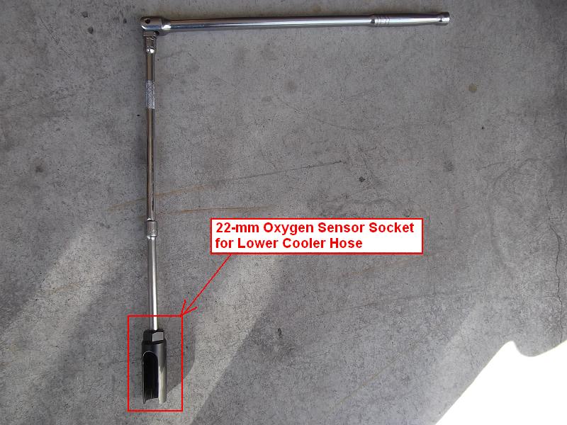

- If you replace the Lower Cooler Hose, a 22-mm O2 Sensor Socket and breaker bar is a must, read on!
- ATF Fluid: I used Quaker State Dexron-III ($3.30/qt at Menards hardware store). You can use Mobil1 synthetic ATF too, see the DIY by “MadeInJapan” above.
- Beer: this is essential, without Heineken, the car will not run LOL. OK, let’s get to work.

- Use the 24-mm wrench to drain the ATF, about 3.3 qts comes out. Clean the drain plug and re-install it (40 Nm), or just snug it and then go from let’s say 4 o’clock to 6 o’clock positions:
- Remove the Air Intake Duct (upstream of the Air Filter) and the Turbo Pipe that runs near the throttle to the bottom of the car, where it connects to the cooler.
- Now you can see the setup. NOTE: the ATF leak at the hoses.
- Also Note the Clip has a THICK and THIN side: the THICK side goes toward the Radiator.
- Pay attention to the Lower Cooler Hose curvature so later you crimp it correctly. I will explain later, read on.

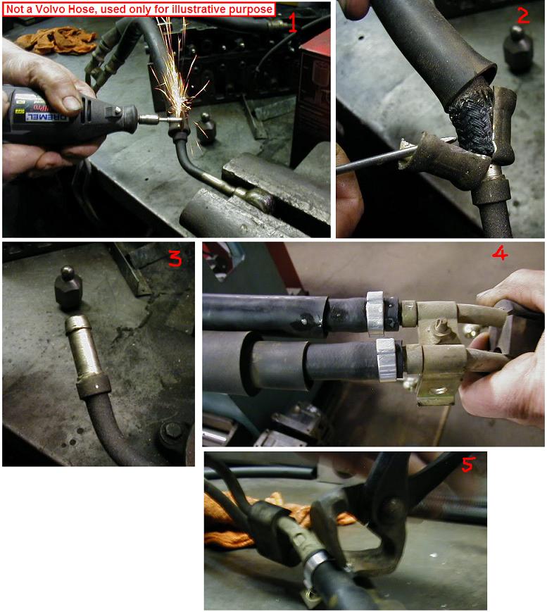

- Below is a generic photo (not Volvo) to show you how cut the factory crimp: cut the opposite sides slowly, once you hit the rubber, stop. Do NOT damage the fitting!

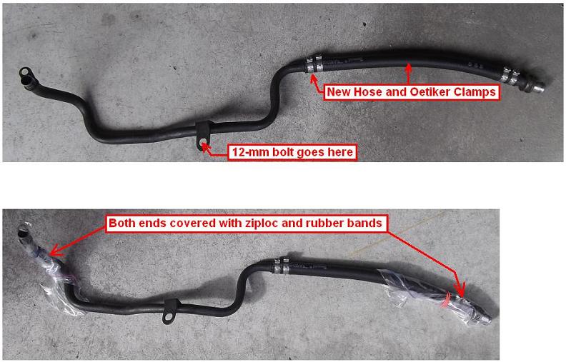

- Once the Upper Cooler Hose is out of the car, cut the crimp off. You can the see the barb fitting has 2 little ridges.
- Cut the new hose to the same length as the old hose (about 10.50 inches). Put the four (4) Oetiker clamps onto the hose first. Then wet the fitting with some ATF fluid and slide the hose onto the fittings.
- Use the Crimp Tool and crimp the Oetiker clamps moderately tight. Don’t overdo it as you can damage the Oetiker clamp. Also, orient the Oetiker clamps in such a way that you can access them later should you need to tighten them again.
- Now remove old O-ring/Seal Ring and install new ones. Use a bit of ATF to wet these seals prior to install.
- Clean it nicely then wrap both ends with Ziploc bags/rubber band to keep debris out. During install, the lower hose end will be going through a dirty area, trust me. Therefore it is essential that you cap both ends with Ziploc bags!

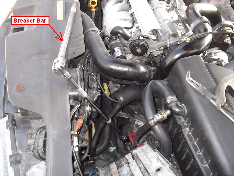

- The Trans side is flared fitting, so no O-ring. The 22-mm nut on the cooler line is screwed into the 22-mm hollow bolt, which itself spins around and not fixed in one place. So you need to use an adjustable wrench to counter-hold, wedge the adjustable wrench against appropriate areas for either removal and install.
- Install Note: See photo #4 above so you can reproduce the same orientation of the metal pipe part of the cooler hose. The trick is to swing the adjustable wrench around and wedge it against the other side (near the dipstick housing).
- Crimp the 2 Oetiker clamps on the Trans side first. Now hold the new setup and look at the photo above. Bend the hose into a U-turn as in the photo, now spin the other fitting (radiator side) around so it faces the radiator. Then crimp the other 2 Oetiker clamps.
- The breaker bar/long extension/O2 sensor socket will undo the 22-mm nut nicely.

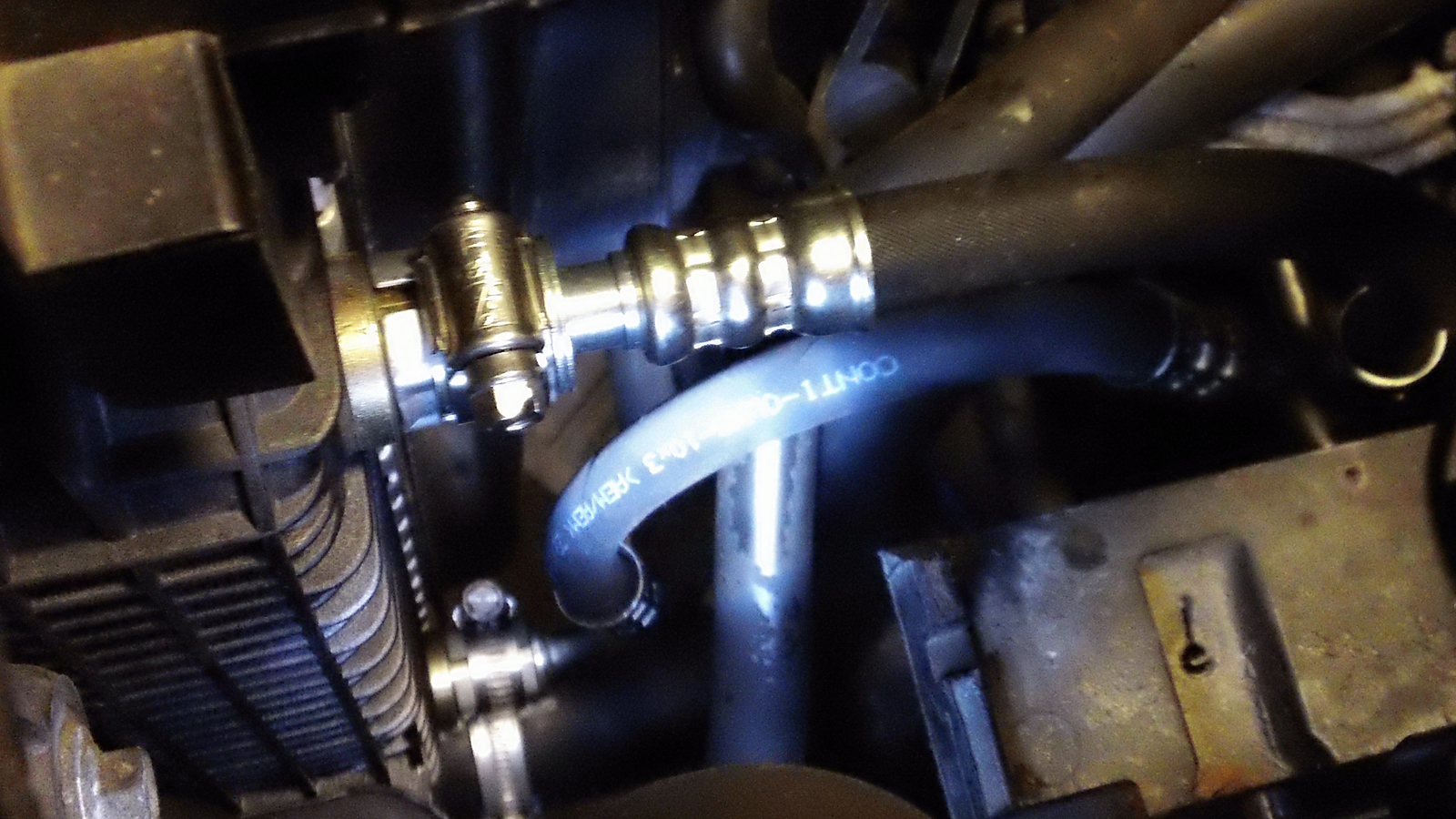

Replaced both cooler lines today. Thank you for this timely writeup.
7/8" crowfoot is an alternate to 22mm on flare nut at outlet line.
For the first time in five years, I have no fluid leak of any type in 1997 850 at this moment of writing.
I intent to rebuild the two lines the cn90 way.
New trans cooler lines

One-year follow-up on this DIY using generic ATF hose.
The Oetiker clamp connections are bone dry, car is happy like a bird......
