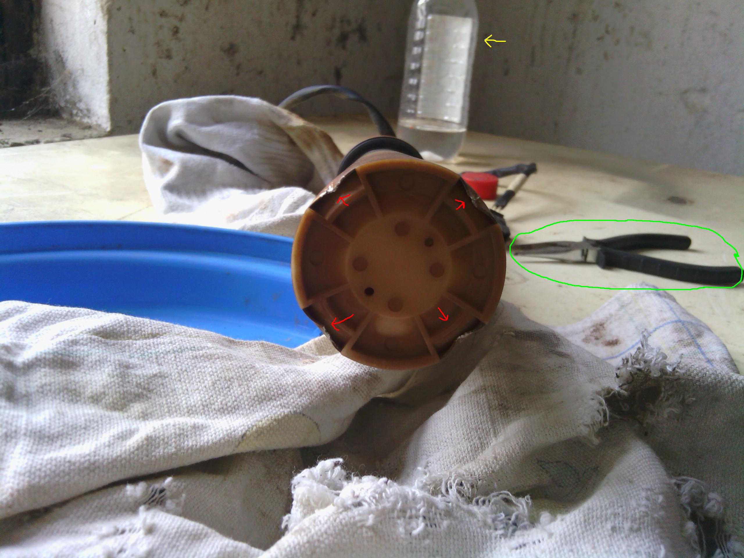

Thank you! I had no idea what the sender looked like so that gives me confidence it's a piece of cake job. So the contacts are easily accessible and can be cleaned? Do you wire brush them, sand them, or just flake off "corrosion" or whatever builds up?

Only the bottom one.On the picture you'll see the bottom of the fuel level sender,little pliers(green) and nitro solvent(yellow).You must separate those edges(red arrows are pointing to them) in order to open the fuel level sender: When you open it,just gently clean the corrosion,or some gunk which look like corossion,with a clean cloth & nitro solvent or petrol,close it and turn the whole unit upside down and back a few times to develop a free movement inside of it.After that you can put it back to its place.When you putting it back to its place put a thin layer of vaseline(petroleum jelly) on the rubber seal on the top of the unit.burnout8488 wrote:...So the contacts are easily accessible and can be cleaned? Do you wire brush them, sand them, or just flake off "corrosion" or whatever builds up?
That's what i did and no problem since.
Yes...the cluster can store the code about it,but if the code was "fuel level sender open circuit(shorted to ground)",then it is bad.burnout8488 wrote:Now that I think of it, when I had the car at the dealership to have the mileage read out of the cluster using the Volvo VST tool, the tech noted that the cluster had a stored code. It was something about "fuel level reading too high," stored at a mileage right around when I threw a few gallons in a week ago. Your info, combined with this VST code makes me confident the fuel sender is probably sending wonky readings.
