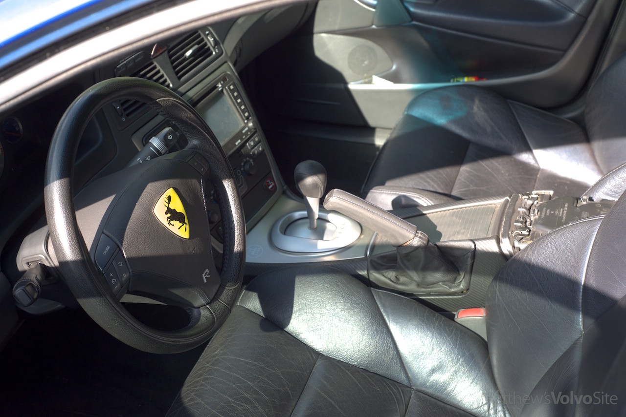

Probably the most notable item about this car is the transmission: it's now a 6-speed manual (M66), donated by a wrecked manual S60. The second notable thing about this Volvo is that it's AWD. And the third is that it's going to dyno with lots and lots of horsepower.

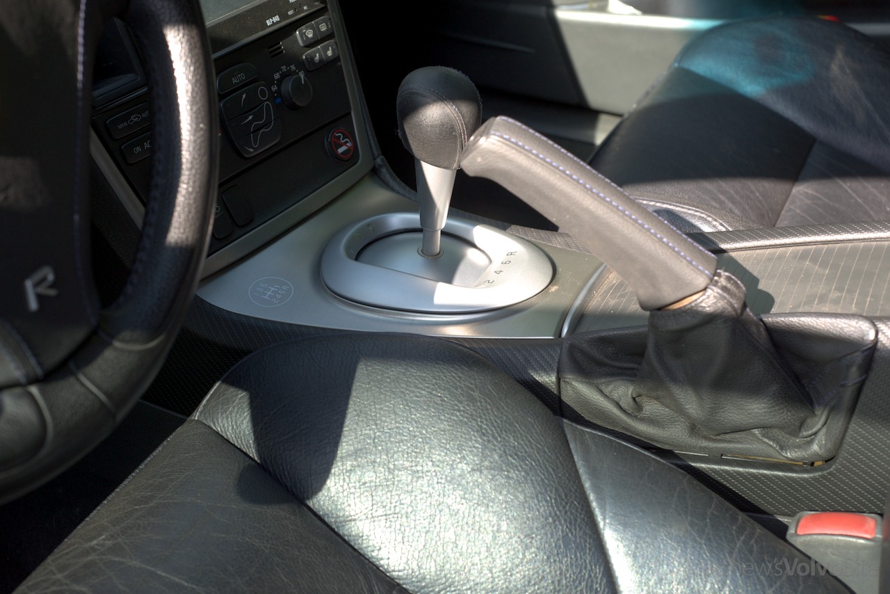

The sometimes-mocked "baseball" shifter found in P2 manuals. Quin loves it, for the record. (I'm not judging, just reporting :-D)
Wider interior shot.

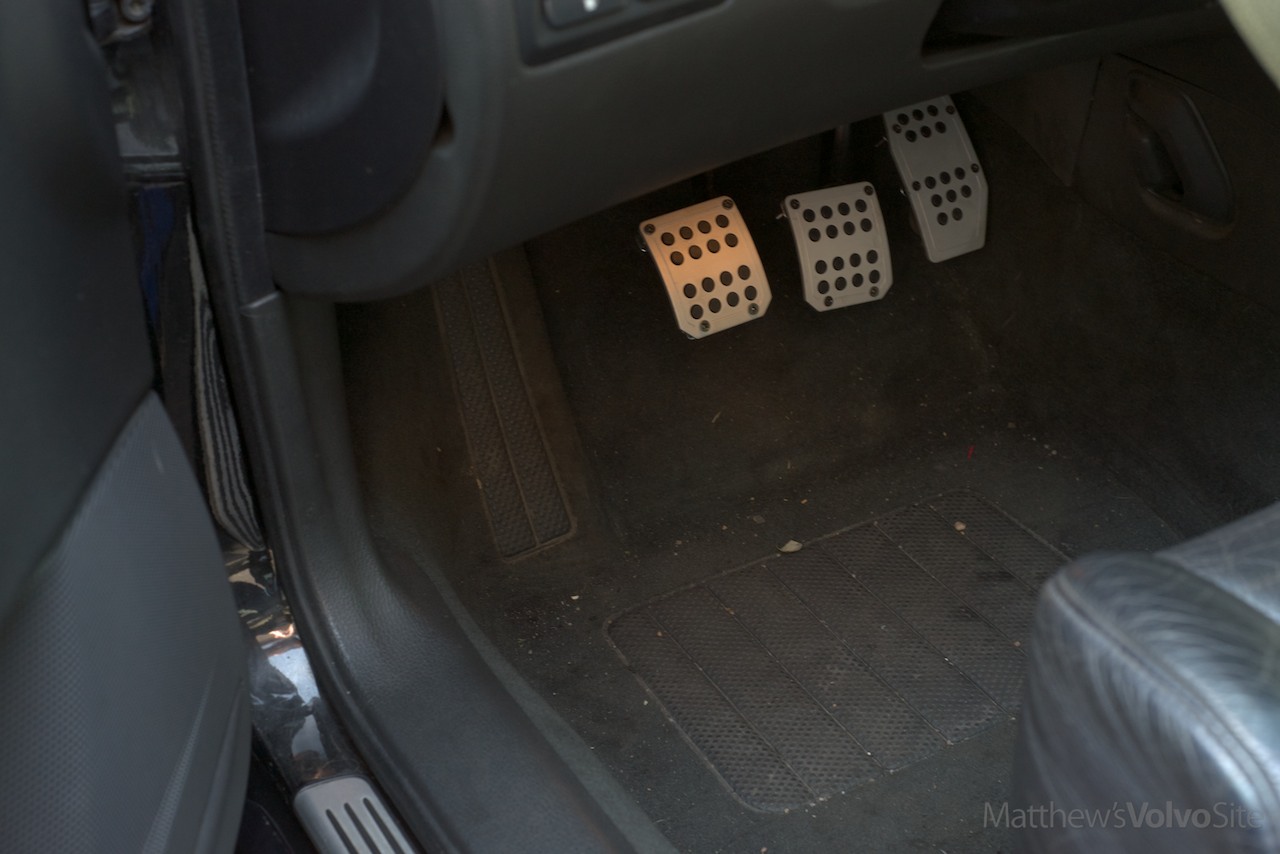

Hey, where'd that third pedal come from?!

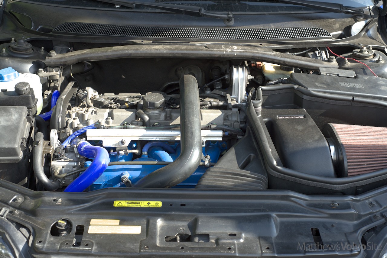

Engine bay.

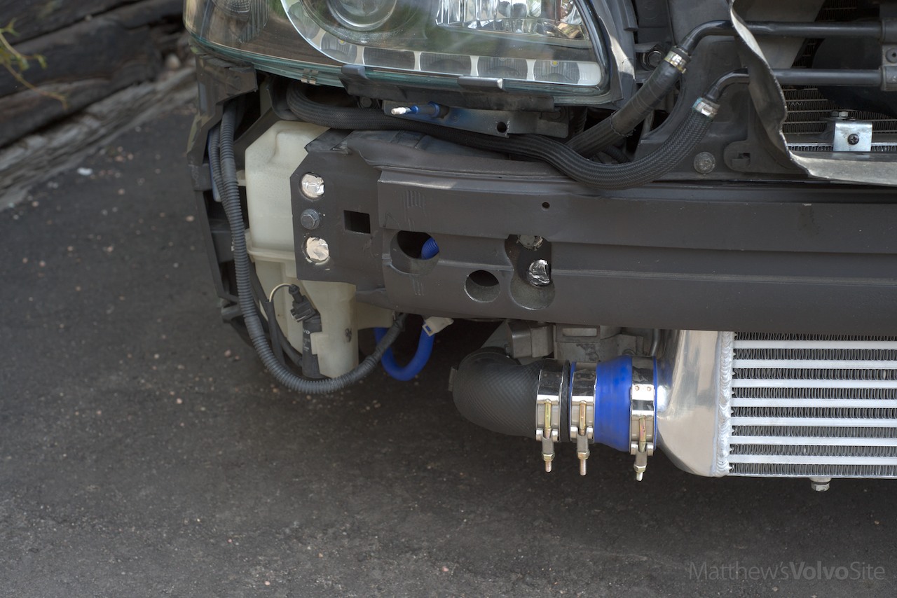

Huge FMIC. Keep in mind Quin isn't a money-no-object tuner. He's got a budget like everyone else here. This FMIC is around $200.

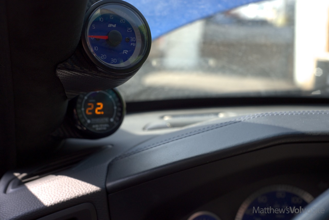

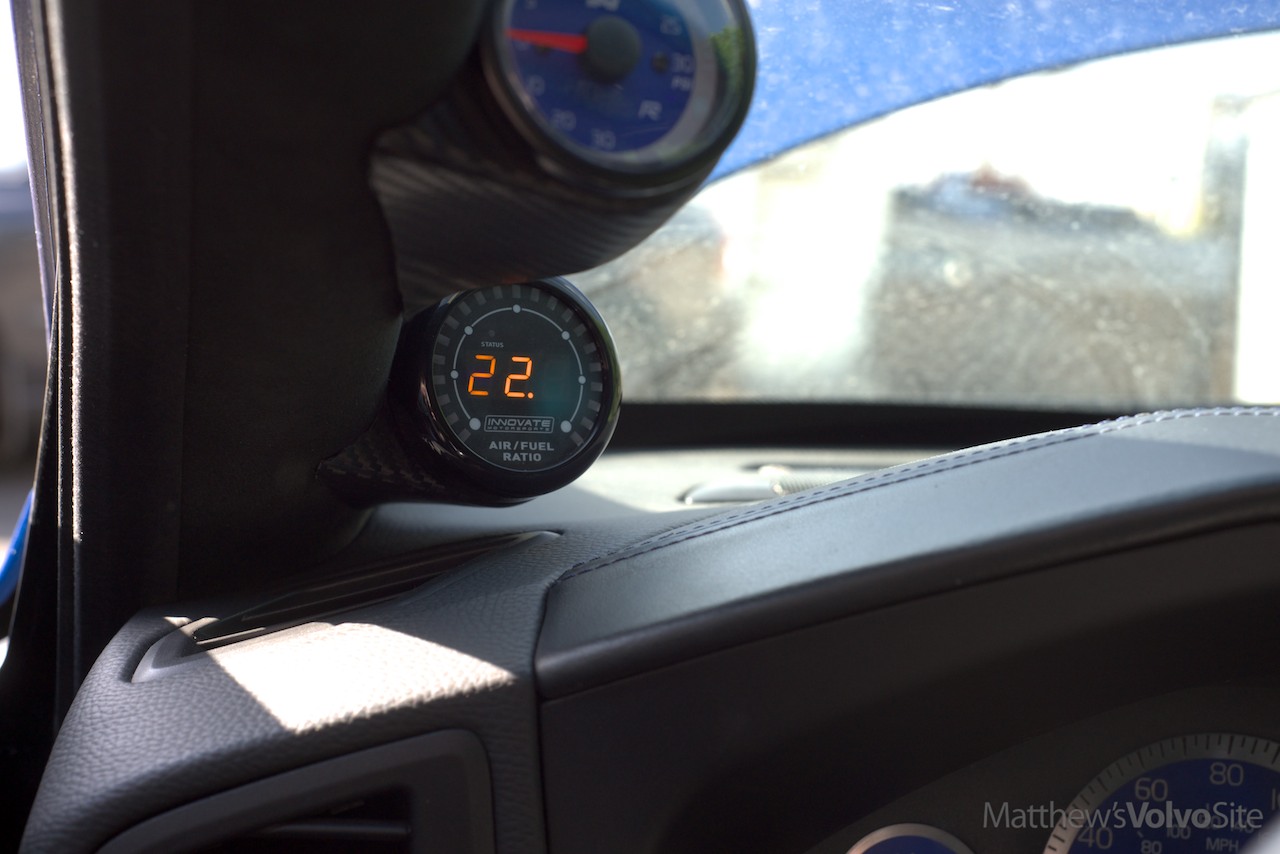

Fuel/Air ratio guage, one-way only (i.e.: not a driver-adjustable variable, except by ARD's Lucky, who is doing the custom ECU tune that Quin is waiting on). AR Design here in Denver made his downpipe, and added a second bung for the A/F sensor.
An iPD R boost guage just like mine :-), fills the upper A-pillar gauge cluster.

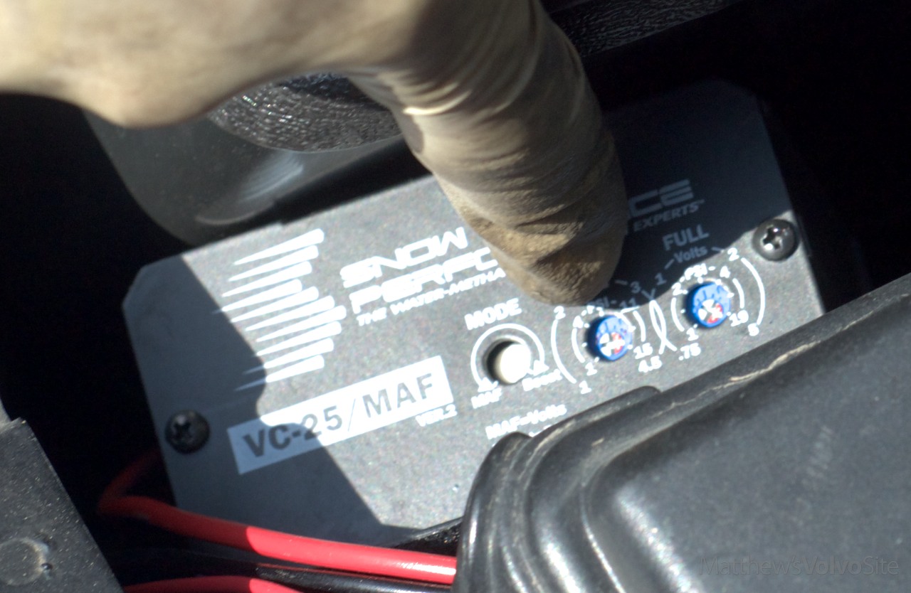

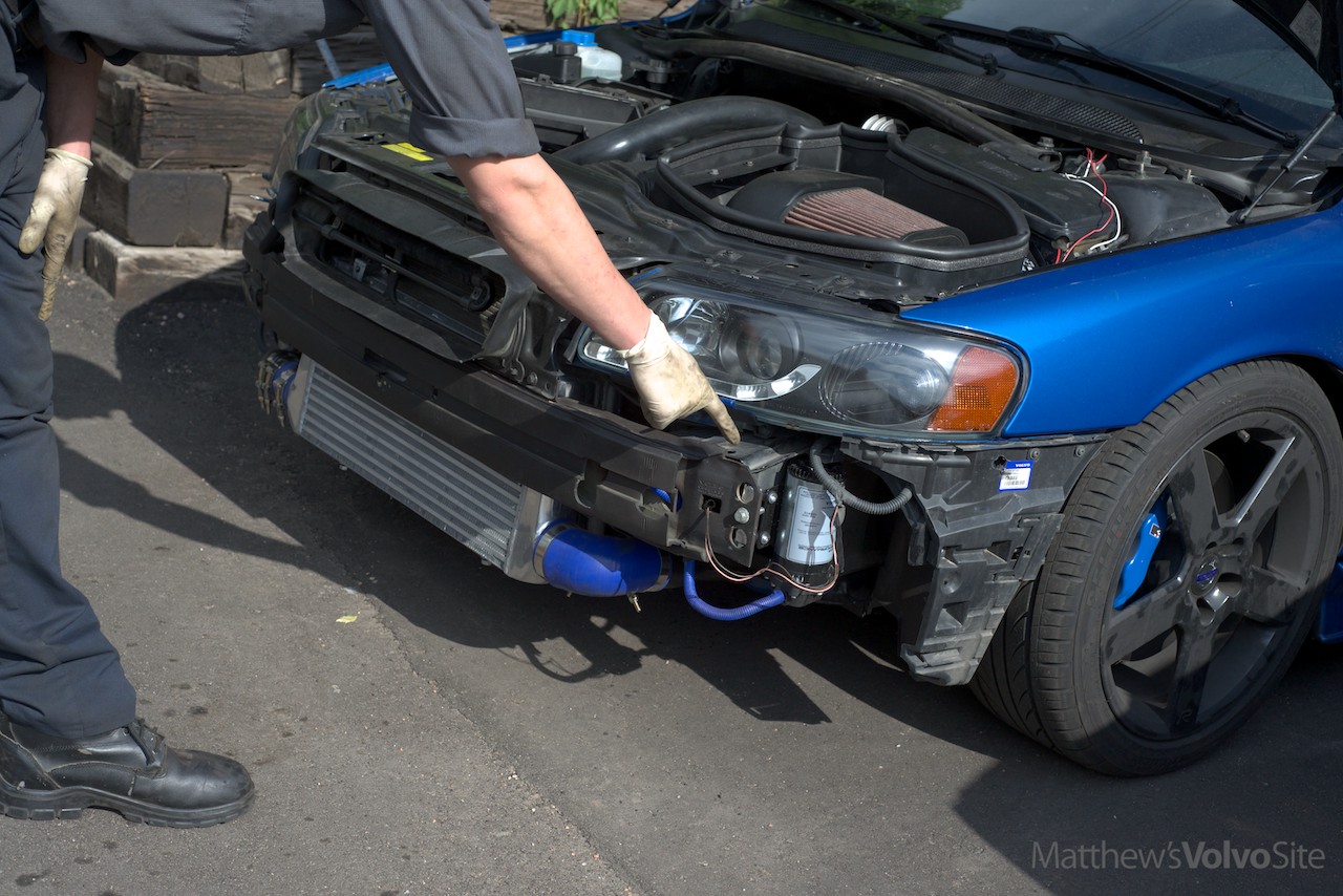

Here Quin points to the ~$270 Snow brand water/methanol injection unit, which is set to 50-50.
And its interface, which allows setting the amount of injection per RPMs. Nice.

Mitsubishi 19T turbo, Volvo green injectors, intake, dual mass flywheel
