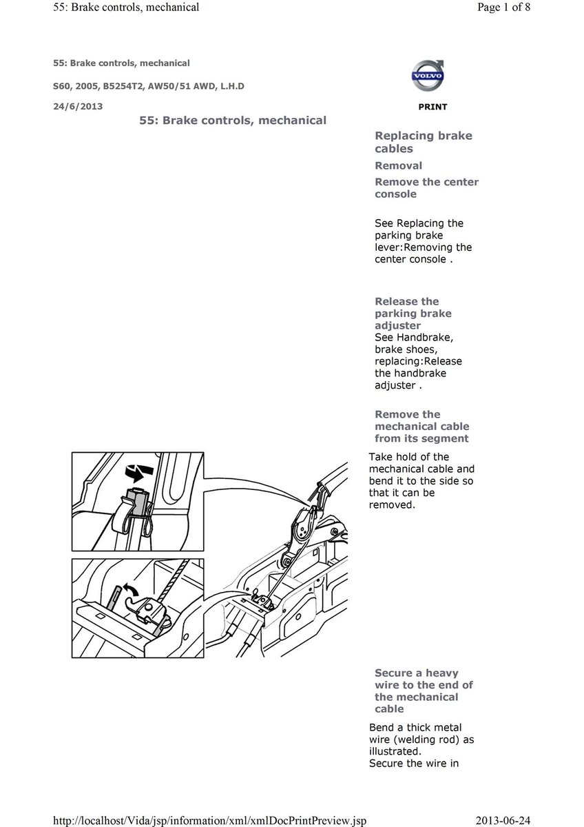

Under the central console at the rear there is a hook mechanism on a pivot. It interfaces the cables with the central lever. When the tension is raised it pulled equally on cables. Otherwise something is wrong (a cable partially seized, unhooked or binding. You have to raise the rear of the console to access. If nothing is wrong with the hooked end you will have to replace the cable for a permanent fix.
I found this as a guide for you on the Web.
