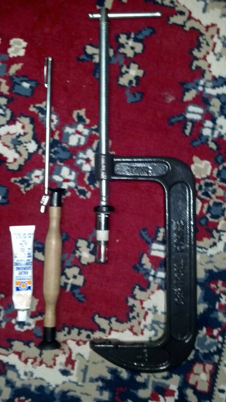

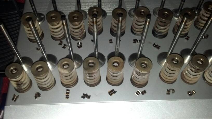

I can't ever let anything rest, I'm too damn anal about stuff.. So what's says bonding like having your 14 year old daughter help you break down a cylinder head and lapping valves with you..lol
Below are my trusty house brewed compressor, a lapping tool from the last time I did this (68 Olds Cutlass my first car, I'm getting old it was 1985) and the compound. A before and after and all my lovely finished valves clean up and waiting for my damn gasket set to show up.
If I'm lucky I'll have everything wrapped up after next Sunday.

I'm no guru that's for sure, but I would pull a head from the pic a part and scavenge from it. I can pull a head local for $50 tops if the guy running it is cranky.
I would think you would only replace the burnt valve and fix the cause of it.
I had to replace none, and don't know about the aftermarket valves.
But that's just me... I would prefer OEM used and then reconditioned over unknown.
