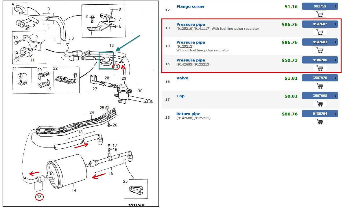

I actually got a better look after work and see it is actually a value of some sort at the beginning of teh fuel line that is very rusty and metal is flaking. I figure the fuel system pressure has found a pin hole and is leaking from the valve (see picture with green arrow).
It looks like it would slide off similar to the fuel filter but I see no part number out there for the valve. I hope this doesn't mean I need the entire line. Has anyone done this repair before? I'm going to try and get up to a local pick-n-pull tomorrow after work and hope a NA car is there. My other kid's turbo doesn't have this valve.

I did some more looking up of diagrams and see it is called a "pulsation attenuation." This looks like part of the actual fuel line and not a stand alone part. Which really is disappointing because I could change this like a fuel filter up front with only the hood up. If anyone knows if it is safe to replace this and not the entire fuel line please let me know.

I don't think the pulse regulator is that crucial.
Maybe you can remove it and replace with standard fuel hose + metal barb fittings + standard clamps?
Another option is to bite the bullet and replace using Volvo fuel hose ($86). If you plan to keep the car another 5 years, then $86 is not that bad.

Most pulse regulators are probably rusted out at the junkyard anyway, so personally I'd not waste time looking for a used regulator.
Some Volvo models don't even have this thingy. If you get a long metal pipe (maybe 3-4" long), then just remove the regulator and bypass it using a metal pipe. Chances are the car will run just fine w/o the regulator.

My 96 Turbo and 97 GLT don't have this on that section of the fuel line. But don't some models have the pulse attenuator up near the fuel rail? I think I saw some mention of that when looking for information on this issue.
I wonder why Volvo used these to begin with. I may go the metal fitting instead of the full line replacement. I still might go to the junk yard and cut a section of the line so I can get the correct fitting size.

Personally, I think this is a gimmick.
Just get a ruler and measure the regulator outlet diameter. This will be your metal tube O.D.
Most European cars have fuel hose with I.D. of 8 cm or so.
