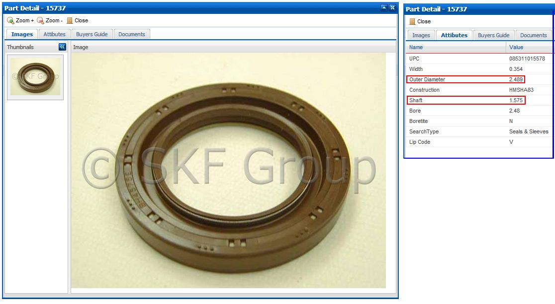

Just to give you an example, SKF 15737 seal has:
O.D. = 2.489
Shaft = 1.575
The point is to find a seal that has a tighter shaft side, maybe 1.40 or so. Look up SKF seal on the online catalog:
http://www.skf.com/binary/12-66340/457010.pdf
