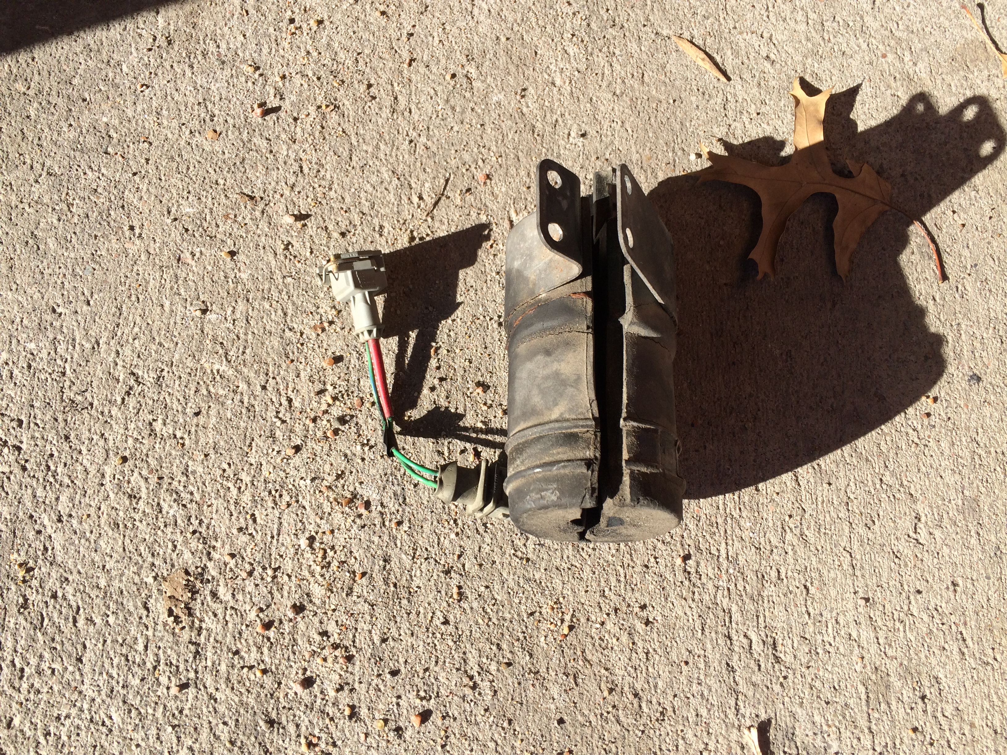

One more update: The issue has been resolved!!
Turns out my EVAP system was broken and needed to be replaced. Figured the EVAP Purge Valve was the culprit after I tried to go into the upper rev band and not two minutes later the CEL came on and there were many CEL codes stored. One of them being error code 315 for the EVAP purge valve. I thought I would start by replacing the Purge Valve and deal with the other codes later on (if they came back).
My car (as with most 94 Volvo 850 turbos probably) has a rubber canister on the driver's side of the fan shroud under the fresh air intake pipe. I thought this whole unit needed to be replaced (I bought an OEM Evap Purge Valve replacement kit online). As I continued to work I figured out the case actually splits in half and inside is the Purge Valve and its extension wire to that plugs into the rest of the car's ECU. Below is what the old Purge Valve (red arrow) looked like after the case was removed.
Below are the case parts:
Steps to repair:
1. Remove the throttle body cover, fresh air intake hose, and the upper solid turbo intake pipe (I removed these parts for better access to the Purge valve).
2. Remove the two screws that hold the protective case to the fan shroud. This is found on the driver's side of the car below the fresh air intake. Unplug the electrical connector.
3. Remove the upper and lower hose clamps on the rubber protective case.
4. Bend the holding bracket enough to release it from the rubber case. Over the years the heat semi fused the rubber to the metal as I removed the metal holding band. Just be careful as to not tear the rubber casing. After the metal band is removed, the rubber case just splits in half to reveal the EVAP Purge Valve. Don't throw the case away as it will be needed for reassembly later.
5. Remove the vacuum line from the intake manifold and the lower end of the EVAP Purge Valve.
6. Remove the old Purge Valve from the vehicle.
7. Installation is in reverse of removal steps.
All in all it's a pretty easy fix and it feels good to have my car working again. It sure made a difference in power and hopefully fuel economy.
Good luck!
