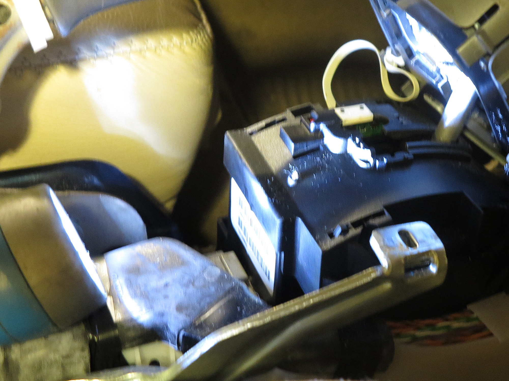

OK.
There are four horse-shoe like tabs at each corner, these anchor the upper cover firmly. A very hard and dry plastic material. A drop of machine oil at each tab loosened the grip just enough for the trim tool to slip off and uncase the top.
More photos coming.
More photos coming.

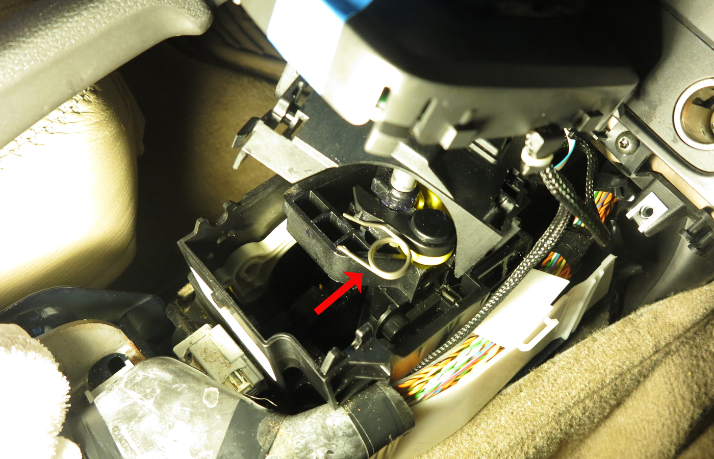

The rocker arm installed. The yellow part was broken.
The shifter moves up and down as it should, and between D and Manual without a wobble.
Not sure if the spring is sitting properly, see arrow?
